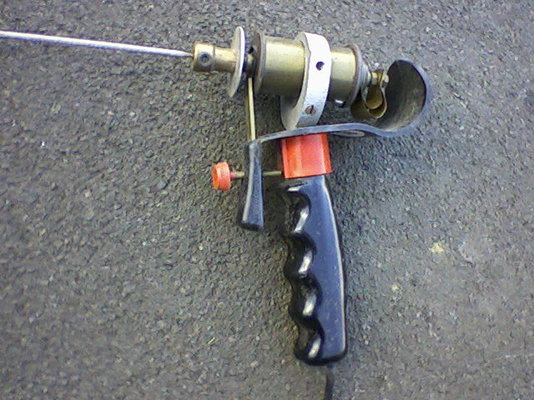

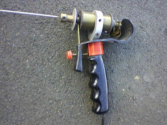

Having just read the patent I think I see what the diode does. When the electrode is pulled back by the spring, interrupting the current, the collapsing magnetic field induces a high voltage spike in the solenoid coil, producing a spark from the tip of the electrode down to the workpiece. Kind of like a petrol engine's ignition system, except in this case the buzz box and diode provide the DC power for this Duck Dodgers' Ray Gun gizmo.
