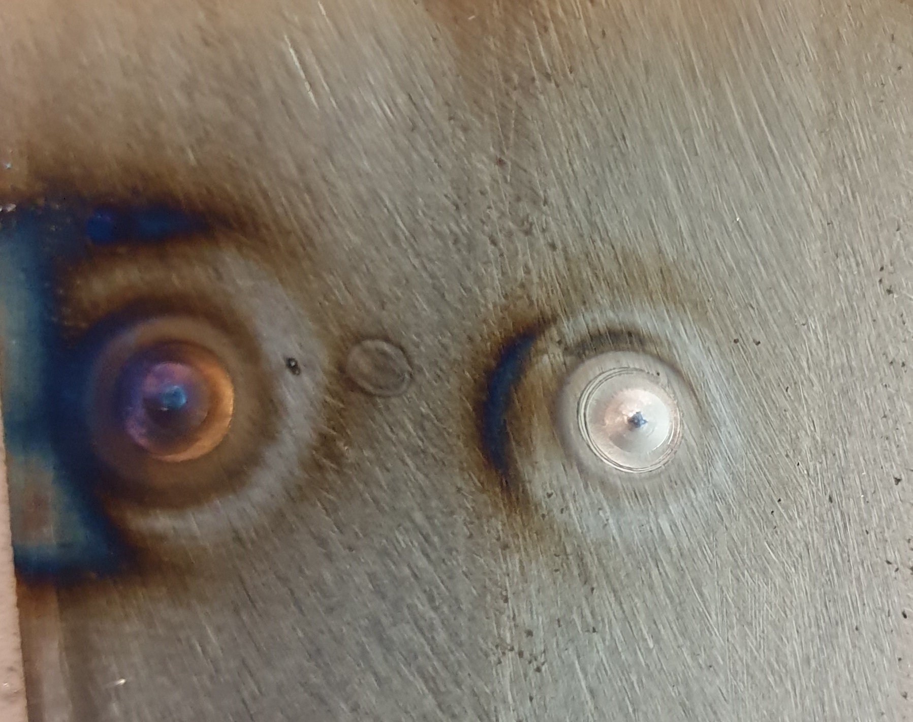

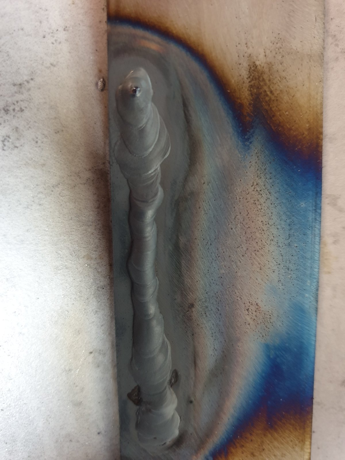

Old Chinesium uses spark gaps , clean or adjust them , but could be a crappy hf too . You get what you pay...
Apologies for the delayed response, I've been investigating!
So I've ruled out gas flow issues - in fact I was using too much, which was the cause of the frosty look of my weld.
The first weld after a fresh grind still works the best, but I've found I can get the arc going by getting very close on subsequent ones.
However insufficient post flow might be an issue too, I'll try that tomorrow.
Thanks for the continued tips, really appreciated - I'm getting there!
