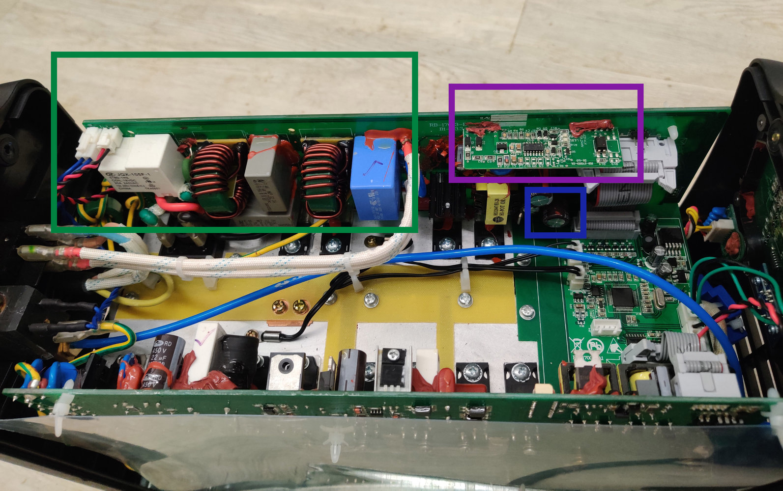

Hi,
Trying to diagnose my Apex TIG200 - Have run out of ideas hoping someone might be able to point in the right direction (Or if anyone is willing to have a shot at repairing)
IGBT failed, last time I just replaced and everything was OK - this time even after replacing the control panel does not light up. AC power is present in the green area through the inductors/filter caps. There appears to be a neutral and live track running to the left of the daughterboard in purple (it has LEDs for HV and LV and neither light up). There appears to be a DC power supply below the purple area (and also a -15V linear regulator) If I inject 12V to the cap in blue, the control panel receives 5V via a regulator on the horizontal logic/microcontroller area - control panel lights up and rotary controls work - however none of the press buttons work.
The relay on the left couples the high current AC to the the DC. It appears the white relay to the bridge rectifier and the two tiny connections to the purple board (via diodes) are the only connections from the green AC area. I guess I'm missing some DC voltages. Transformer under purple area doesn't appear to get power & I've tested the FET out of circuit behind heatsink to the left of it (which seems good).

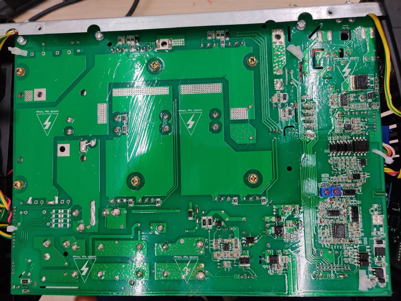

Any good suggestions? Any idea what the small daughterboard pcb is doing? Lower picture is the reverse of this board....
