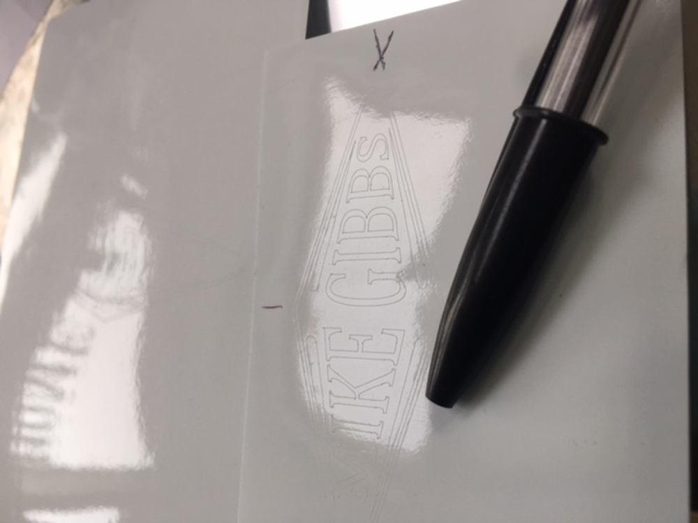

C cardiffrob Member Messages 1,671 Location Wales, Llantwit Major. Dec 24, 2022 #24 Here is the first 'template' cut by Chris (Carbon) for me. You can see how fine it is and the individual elements just lifted out.

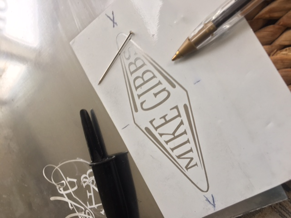

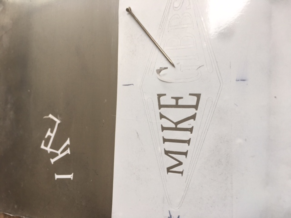

C cardiffrob Member Messages 1,671 Location Wales, Llantwit Major. Dec 24, 2022 #25 Picked out with a sewing pin

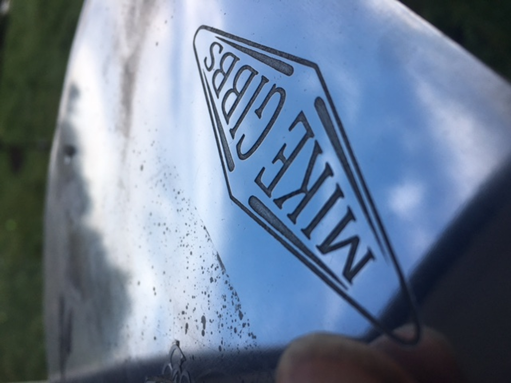

C cardiffrob Member Messages 1,671 Location Wales, Llantwit Major. Dec 24, 2022 #27 fifteen minutes of lightly rubbing with a soft toothbrush and some Ferric Chloride and this is the result. Thanks for this, Chris!! Top Geezer.
carbon Member Messages 3,106 Location S. Glos. U.K Dec 24, 2022 #28 That looks very good, have fun with the smaller ones.
