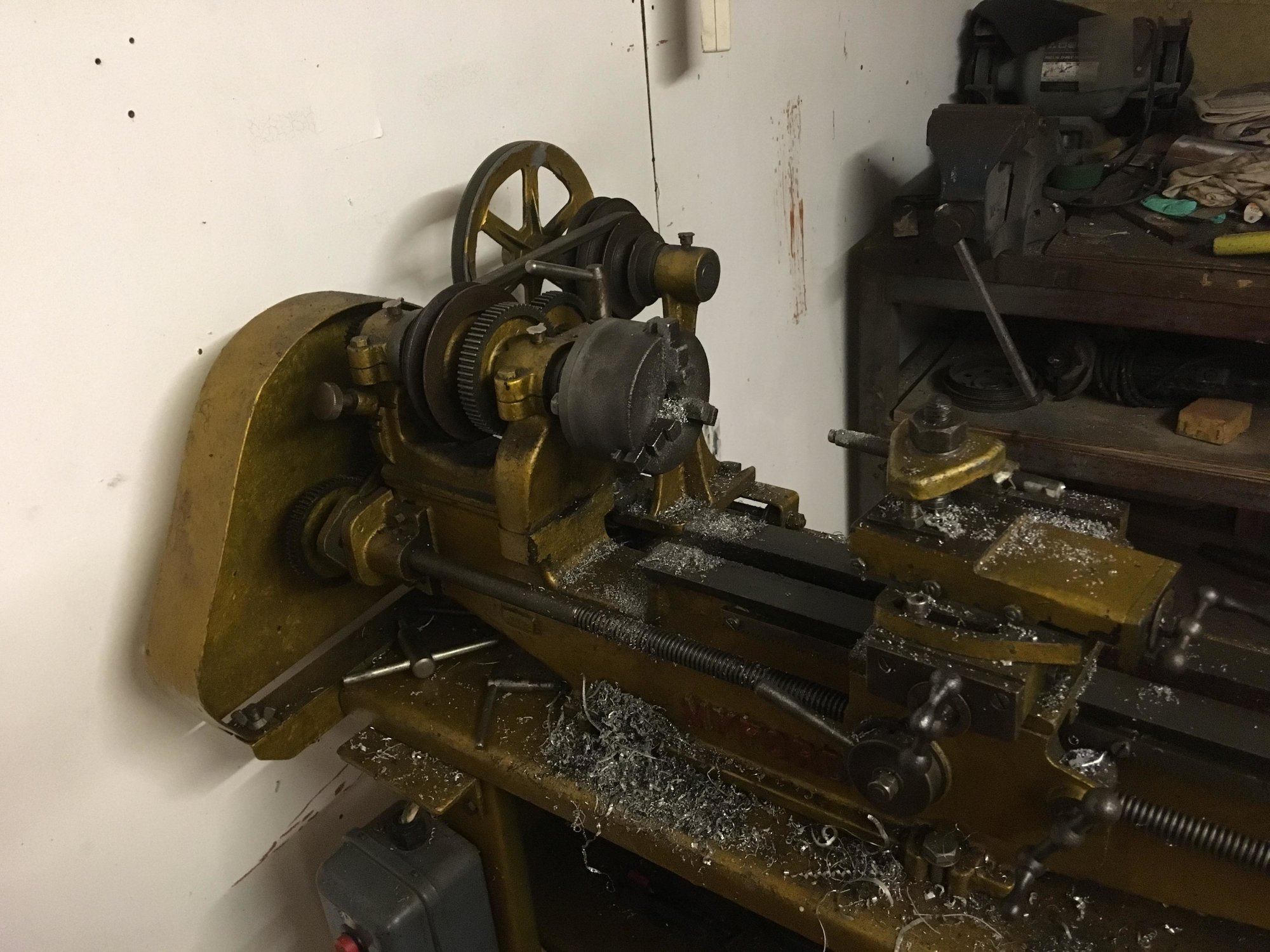

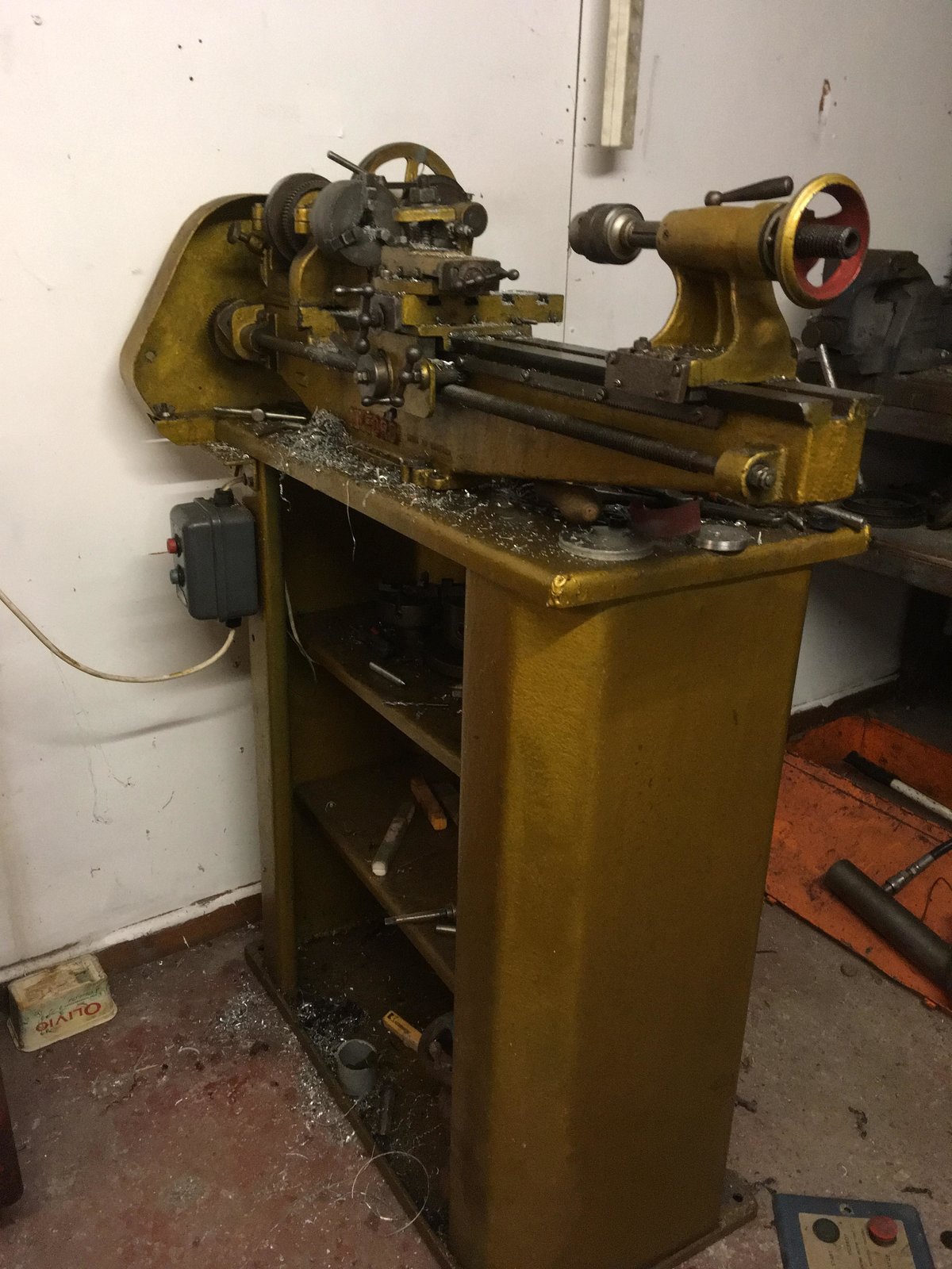

Wightsparks Member Messages 1,533 Location Wight Nov 29, 2018 #1 .. and anything special to watch out for... please
addjunkie Forum Supporter Messages 11,608 Location Northumberland. Reet oot in the sticks Nov 29, 2018 #2 Looks like an ml4 to me, old, hard to get spares for.
Tangledfeet Think outside, no box required. Messages 3,065 Location Top of a hill above St Andrews, Fife Nov 29, 2018 #3 addjunkie said: Looks like an ml4 to me, old, hard to get spares for. Click to expand... My thoughts too: http://www.lathes.co.uk/myford-ml2-ml4/
Wightsparks Member Messages 1,533 Location Wight Nov 29, 2018 #4 Thanks all! Going to take a look at it shortly as it is local.
R RichardM Member Messages 3,347 Nov 29, 2018 #5 ML2 or ML4 - wear in cross slide / top slidenuts and screws, cracks in the headstock casting by the bushes, lead screw nuts and screw wear, tailstock cracking by the clamp lever. Remember it is probably 70 + years old http://www.lathes.co.uk/myford-ml2-ml4/page3.html
Wightsparks Member Messages 1,533 Location Wight Nov 29, 2018 #6 Thanks. Also very small so gave it a miss. Thanks for input all.
