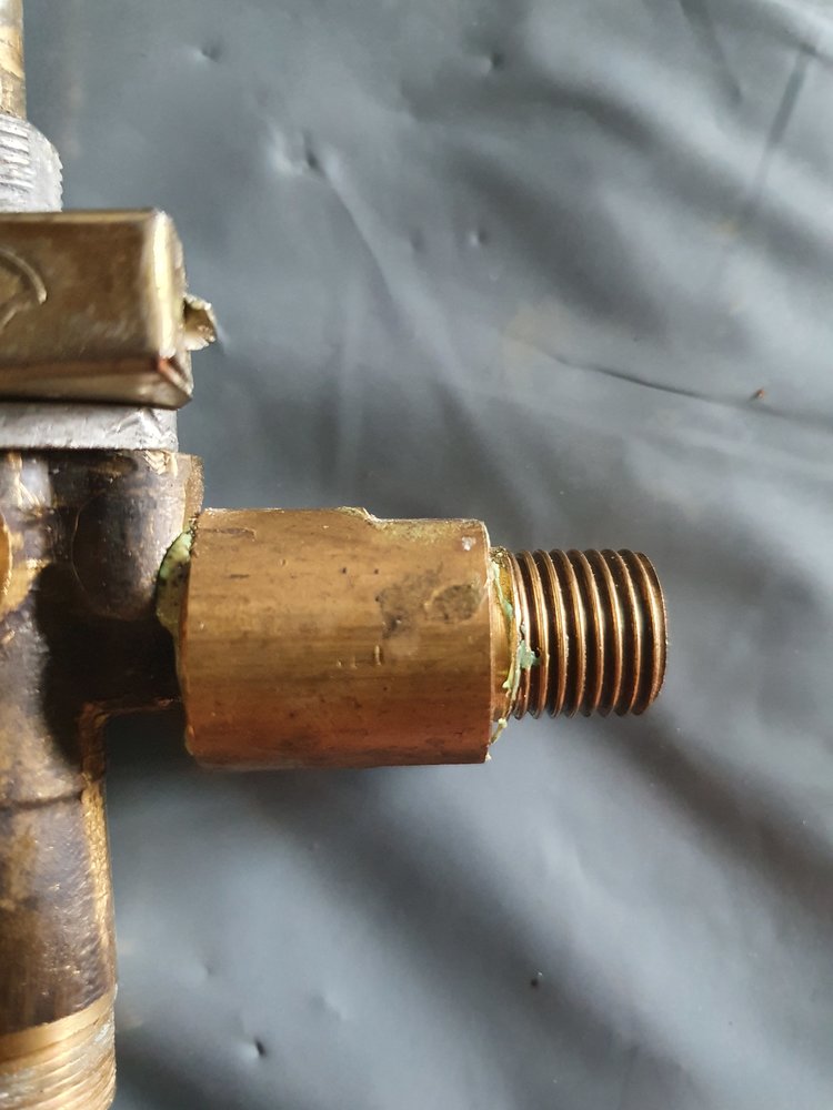

This is a gas jet holder on a catering appliance.
Brass body
1/4" bsp female to 1/4" bsp male
Round body with 2 flats (18mm a/f)
It looks like a simple extension piece except the male end is internally threaded 1BA (to hold the jet)
So basically I need a 1/4" extension but with a bore of 4.5mm or less then I can drill/tap myself.
(I guess this is what the oem did)
I've seen similar used as flow restrictors but struggling to find a supplier for one the same as this?
