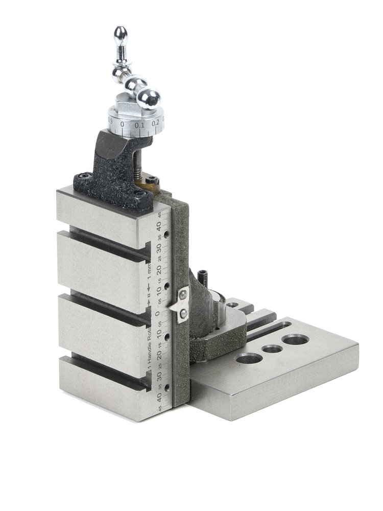

You buy a vertical slide to bolt to the cross slide, make milling on the lathe a bit easier, Ive only ever done it by clamping to the cross slide though, as the old lathe I had, had t slots on the cross slide.1.5m x 0.7m for a lathe to fit in approximately
