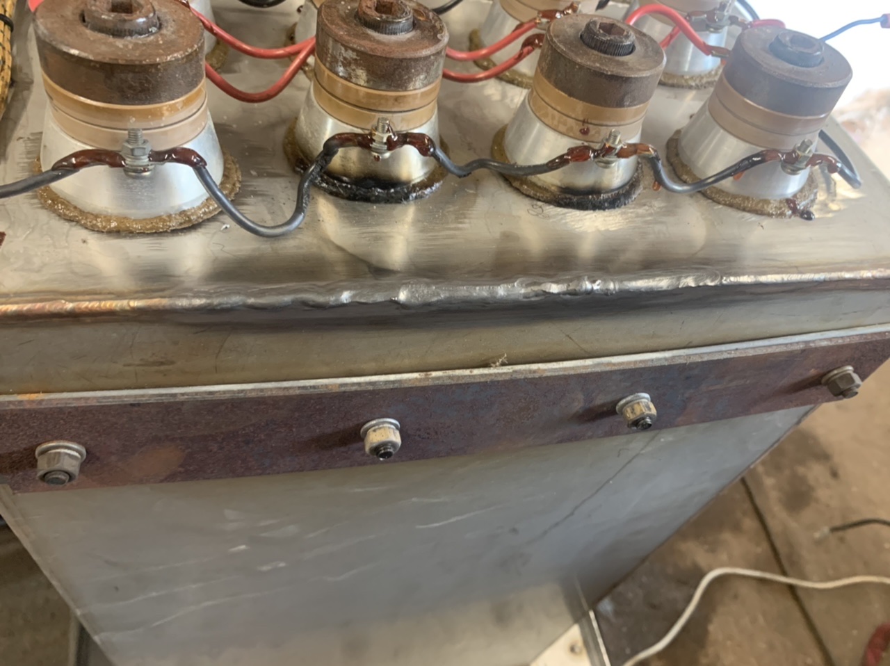

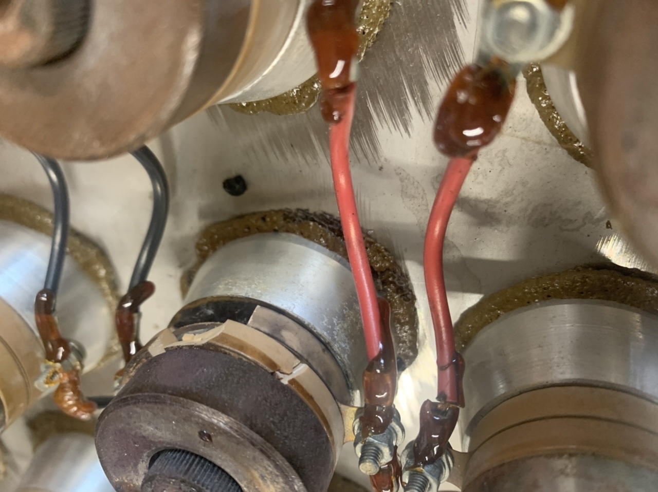

This Ultrawave IND3232 cleaner I just acquired needs a bit of TLC. It does generate a signal and fire the 16 piezo crystal transducers in 2 circuits, however 1 of them the ceramics is cracked and the transducer itself was very hot. The tank has a split along the weld which I have just sorted with the Tig (to a fashion). Can I remove the damaged piezo crystal transducer and link it out as they are series connected or will this cause problems if they are a tuned circuit and the subsequent loss of one device?
