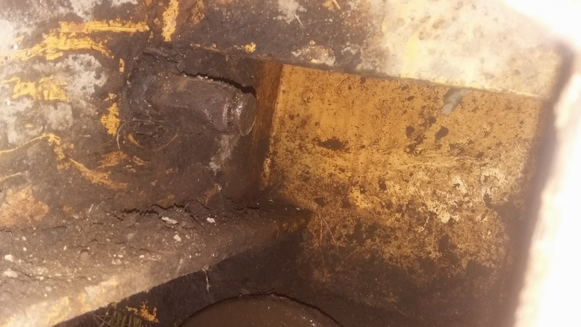

I take it you have first lifted the machine so the track is in the air, then run the track back and forth before measuring the sag ? then consulted the manual so you know what the track sag should be for that type of track ?I have been using digger at farm and i need to tighten the track. I know you use grease.
Hi
so I need to measure it but I have been having a look it's a button head attachment?
