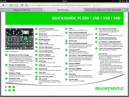

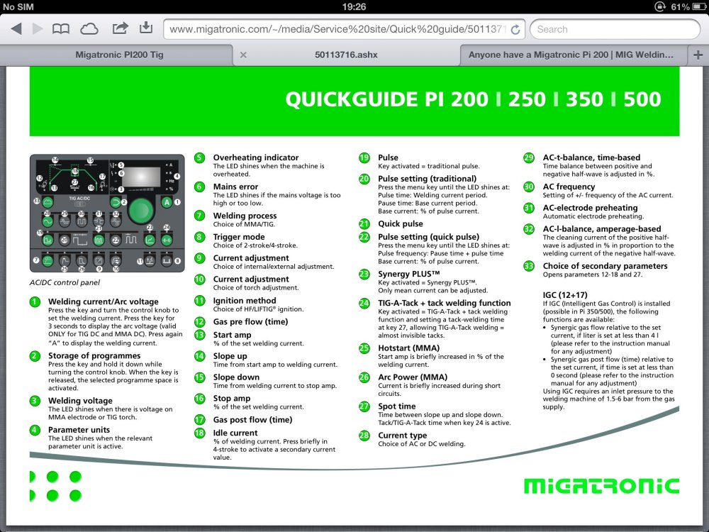

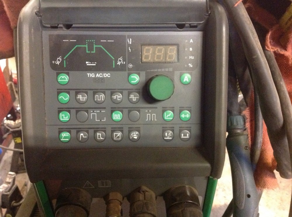

It is possible to recall all factory standard parameters.
In this case all programs in the machine will be reset
to the following value:
MMA current 80A
TIG Current 80A
TIG Spot Current 80A
Pre-flow 0.0 sec
Post-flow 6.0 sec
No slope-up/slope-down
Start amp 40%
Stop amp 20%
Second Current level 50%
Base amp 40%
Fast pulse frequency 49Hz
Pause time = Pulse time = 0.1 sec
AC-T-Balance (AC) 65%
Electrode Pre-heating (AC) 5
Frequency (AC) 50%
AC-I-Balance (AC) 100%
Thank you, thank you, the mystical Pandora's box of magic maybe fathomed out, I'll let you know how I get on.....
The important bit is that you got is sorted but FWIW it's too much cleaning (electrode positive) that melts the tungsten
