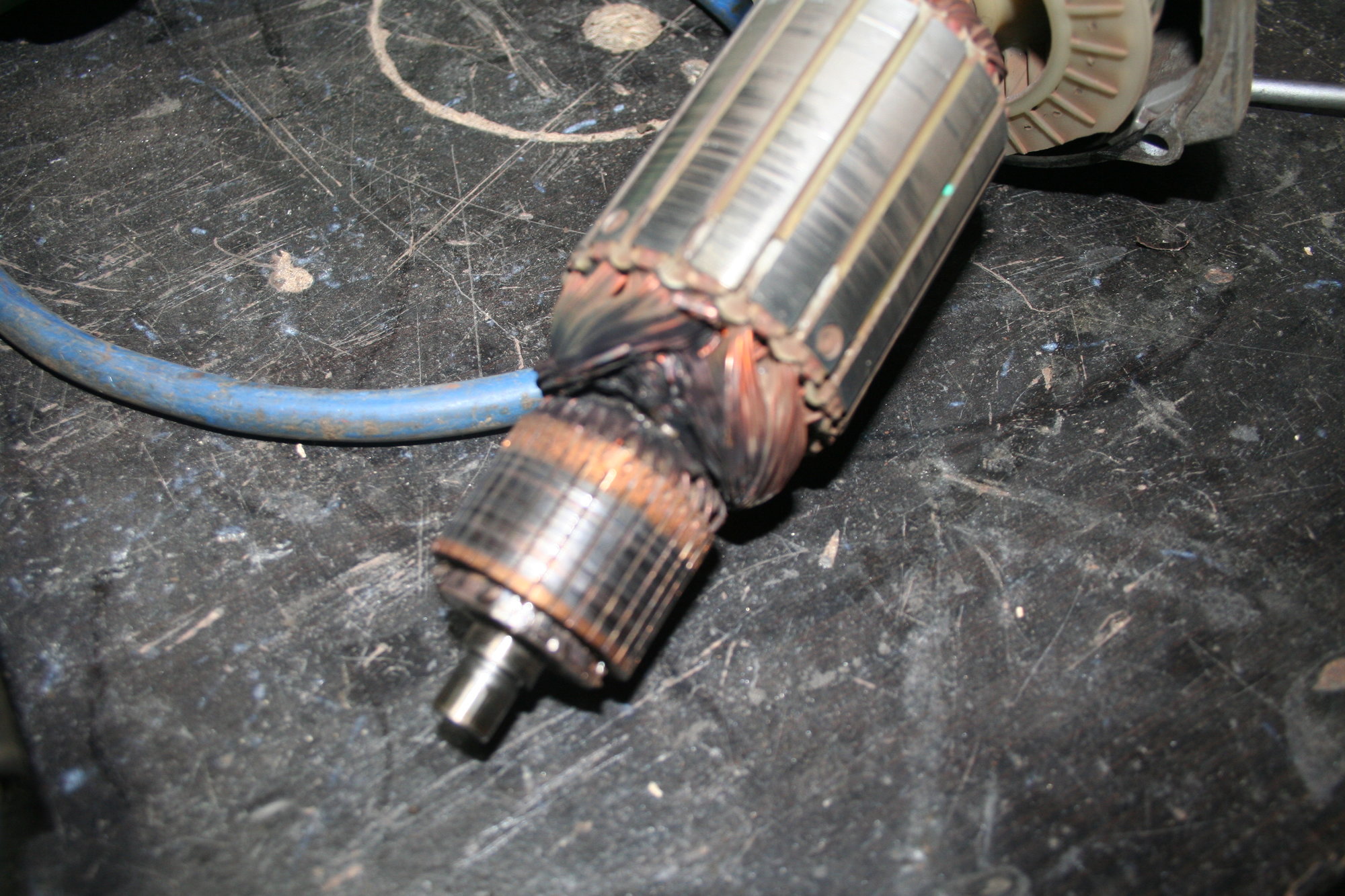

have you tried dressing the commutator up with fine emery paper? maybe just ridges or rough edges between the plates, or too much carbon build up causing the sparking. You could try dressing it up, good clean between the plates and a good rinse with contact cleaner. might be enough worth a try costs nothing....
Excessive sparking at the brushes, and especially a ring of sparks right around the commutator as it spins is a sure sign of shorted armature windings. C'est foutu, I'm afraid.

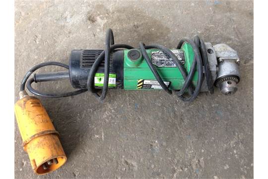

Use a very old Hitachi angle drill for that.
Bit slow on speed but lean on it all you like and it won't stall

Dunno. Il pull mine out and check tomorrow.Robin I have never seen an angle drill that compact, what's the model number?

HereRobin I have never seen an angle drill that compact, what's the model number?
