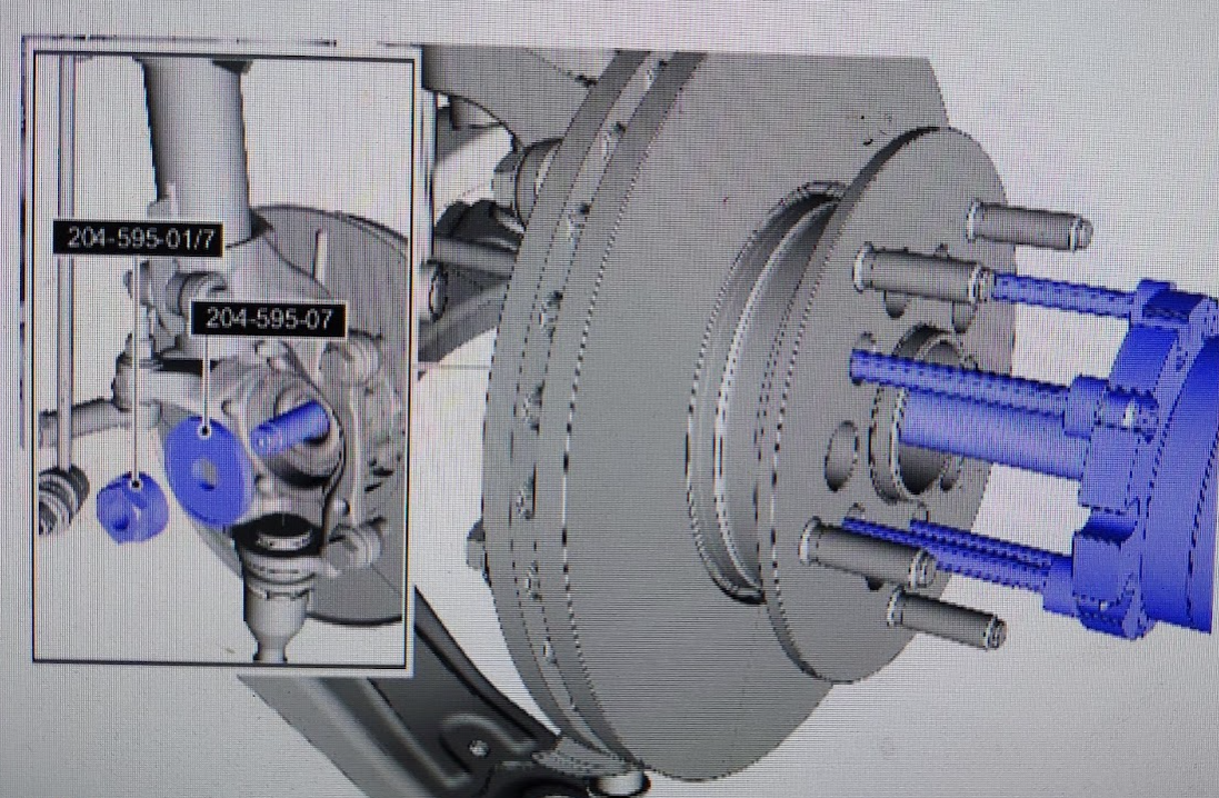

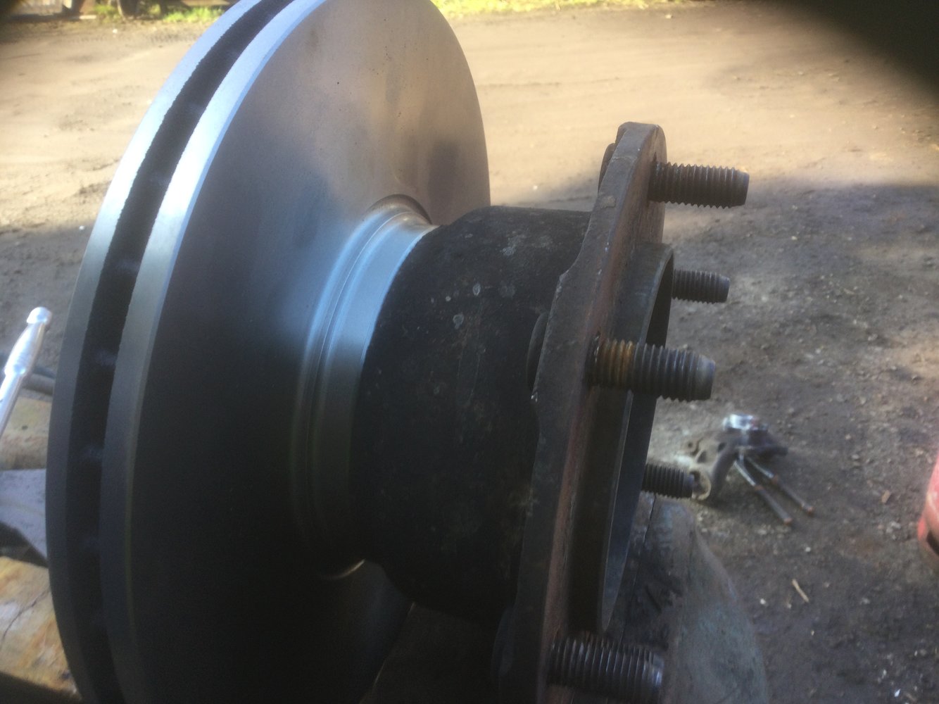

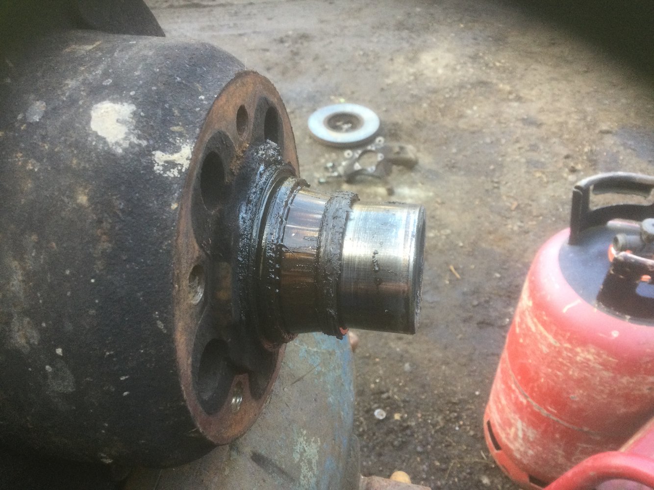

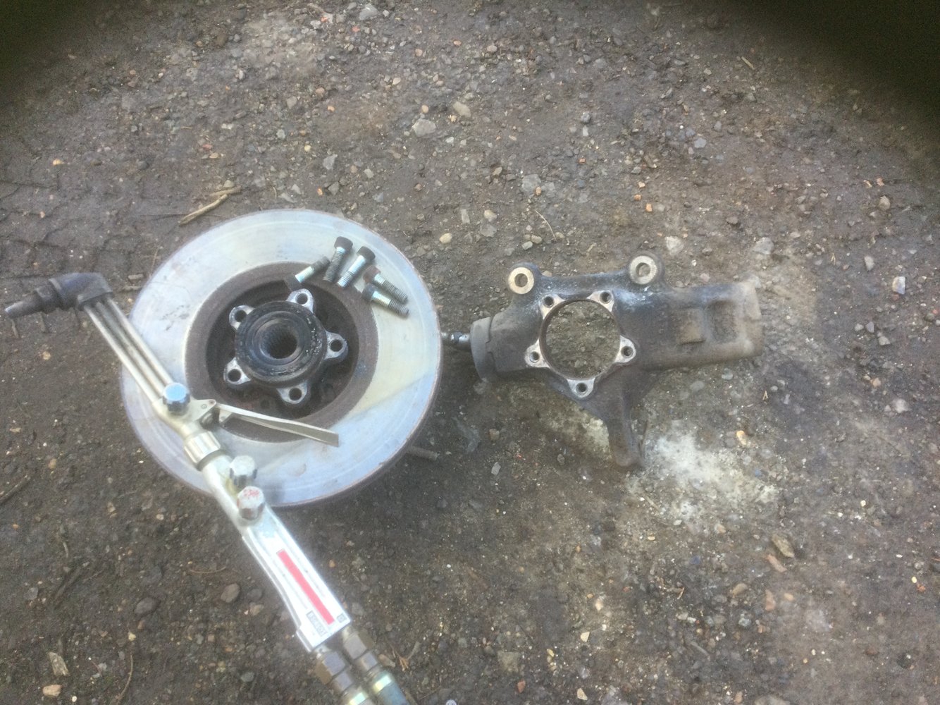

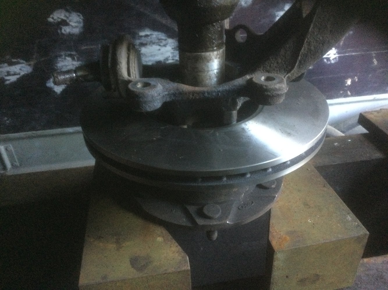

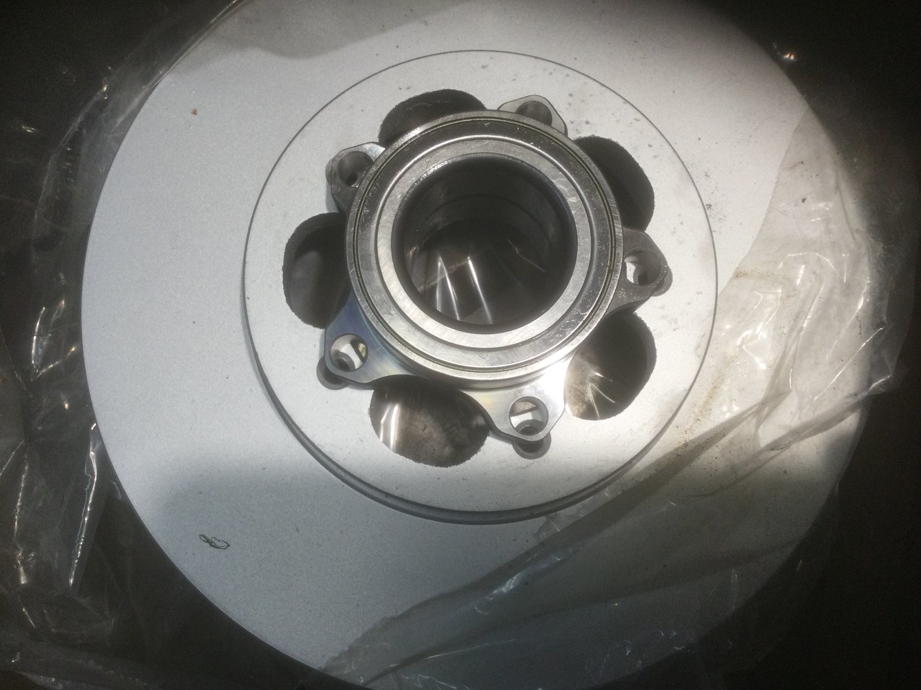

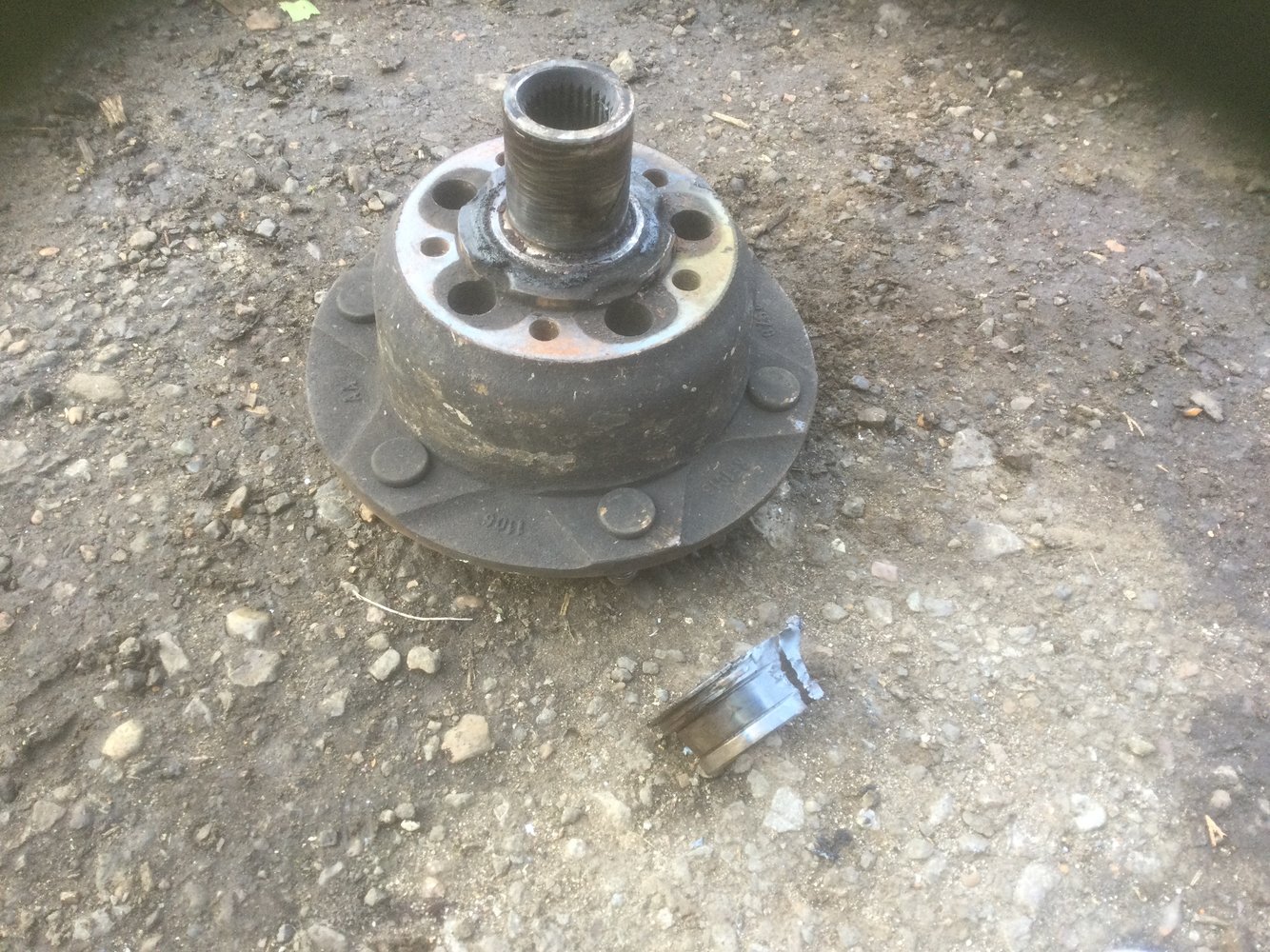

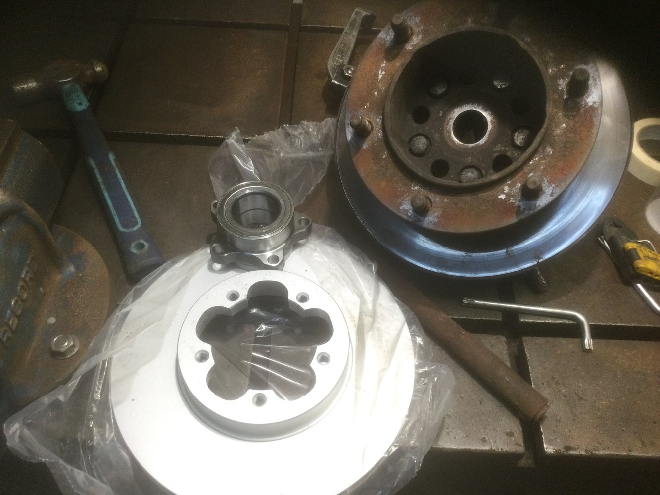

The discs always come over the bearings once the hub/bearing is removed from the carrier.
His ones look like they’ve come off in situ? Like the older ones?
The fronts is a toothed ring. The rears are some sort of inductive thing. It looks like a bearing oil seal, as opposed to toothed ring or slotted disc if you see what I mean?Older ones the bearing was pressed onto the hub, new ones are a complete hub assembly.

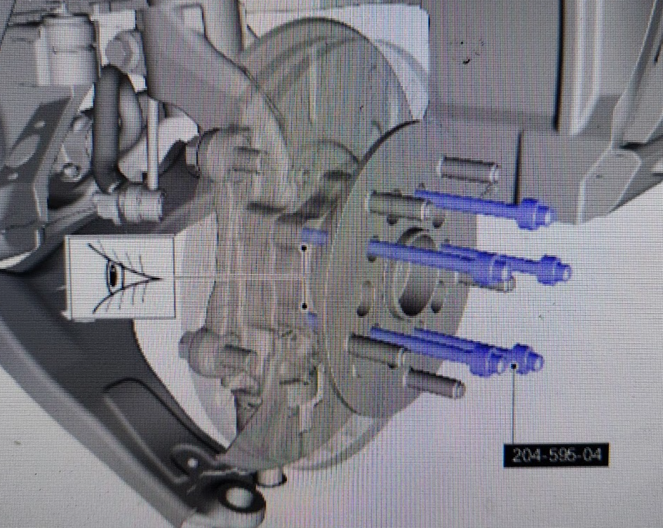

The biggest issue was always wiping out the ABS sensor, but I'm having a complete mind blank as to where the sensor is on the 2014 on Transits.
Old one ran on a toothed ring on the driveshaft/dummy shaft, but I can't even visualise it on the new ones...
