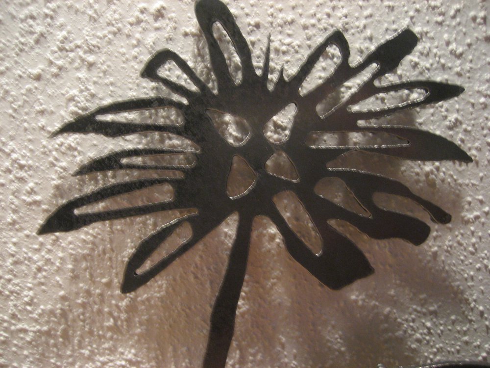

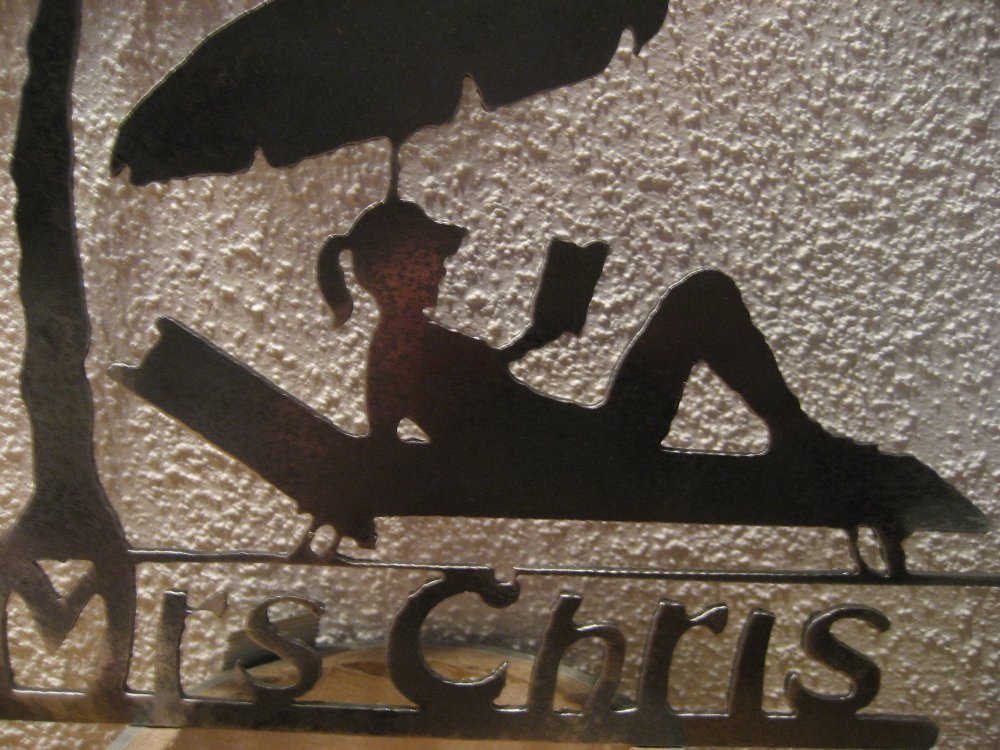

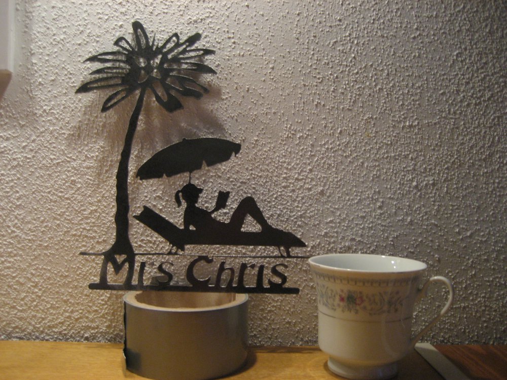

The only thing I hadn't been able to change was the plasma cutter itself. I bit the bullet and bought the Hypertherm. Got it at a good price, less than a grand with the full 3 year warranty....never looked back. I've actually rewired the machine again since to tidy it all up. The signal wires and motor wires are next to each other, I don't have a single ground just the normal pos and neg connections to the motors, non of the limit switches are grounded, and I don't get a single hiccup. The powermax 30 does not have a removeable torch so I use the hand torch horizontally fixed to the Z axis by cable ties (so I can easily remove it to cut up my steel sheets) with a separate wire from the CNC electronics to control the torch switch.
The machine cuts to perfection and the consumables last and last and last!
