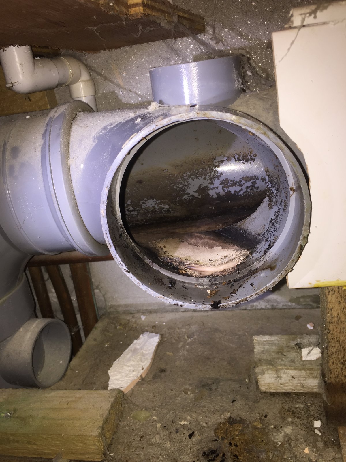

Well since the toilet is out then it's time to do a proper job, no point doing anything else now.

Beat me to it.Just put a piece of pipe the same size as the spigot
Yup.I would need to glue it in though would I? With pipe cement?
(sorry if its a basic question, but I just want to get it right)
Yup.
This sort of stuff. Same as.push fit waste pipes.
https://www.screwfix.com/p/floplast...UqxvmJF1fkhd3GhaLxbhwXMbDl_47uRxoC3DAQAvD_BwE
Wrong terminology. Didn't sit right in my head when I wrote it.So its YOU that glues push fit??????
