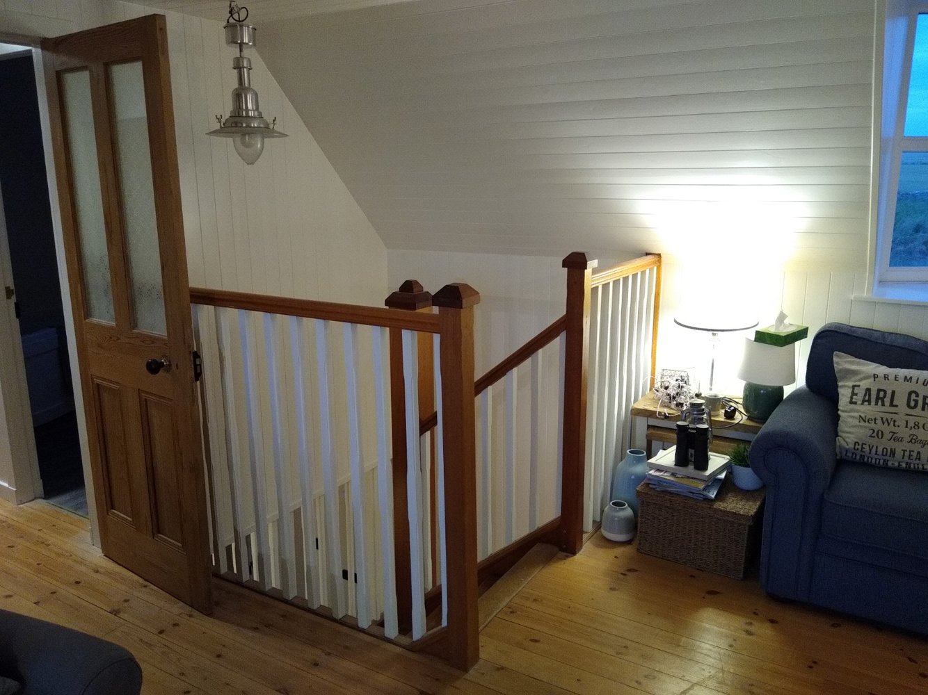

On all out Tongue and Groove we used Farrow and Ball. But it was all primed first with zinsser BIN primer which made a huge difference. It’s been on 4 years and still looks great and no bleed throughs either.
