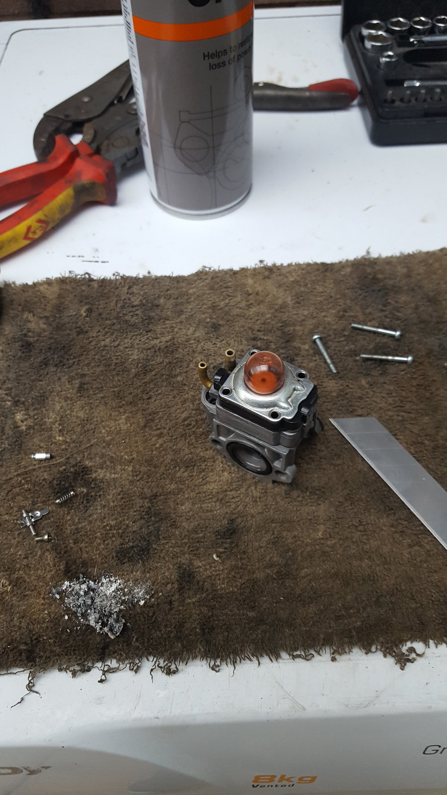

it looks like carpet but it actualy just a rag i use them all the time and every time when im doing a carb as it stops bits rolling around and running away on to the floor

Last year the wife came downstairs and shouted in " what the **** you cooking it stinks " sheepishly I had to reply "Carburettor. ""Yes " my wife wud kill me for assembling stuff in the middle of the livn room floor! I have the no. of a guy that shampoos carpets if required . LOL.
