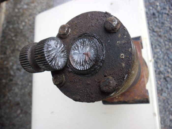

Anyway have some more pictures!
The shaft left in the unit:
The bit that broke off from different angles, it shows what to me is an origin of the failure? Ignore the rust and dirt, this has been on the floor! The joint was all grey before I covered it in cr*p.
Some bits clearly fell off leaving gaps when you place it back where is was:
And for reference here is the end of an (also grubby) halfshaft which I killed, these are a piece of steel machined and turned to create a shaft, the failure is more of a shattering effect when these go. You can often reassmble the bits like a jigsaw. This one was an odd failure, it failed at the outboard (wheel) end, I suspect as it was a pattern part the machining was poor. It was a welcome surprise though, they normally break inside the differential and that requires stripping the axle down
