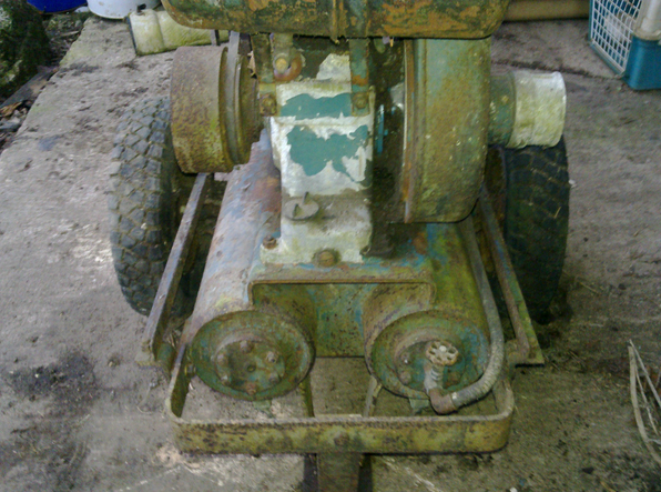

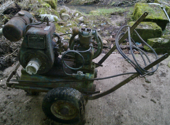

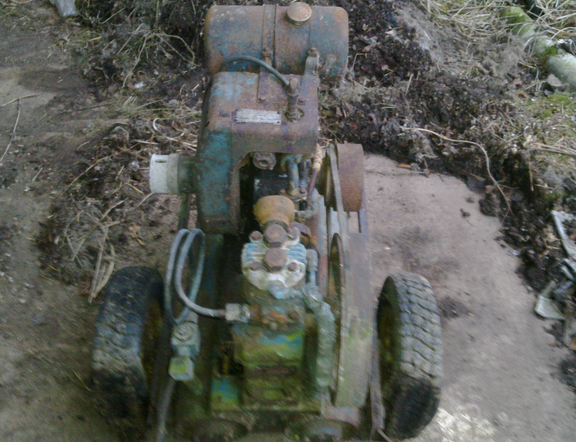

Pressure relief on engine driven compressors is usually done by opening a spring loaded valve at a preset pressure, the air from the pump then bleeds to atmosphere.
If the engine is fitted with a centrifugal clutch there might be a device for dropping the revs to tickover at the set pressure.
