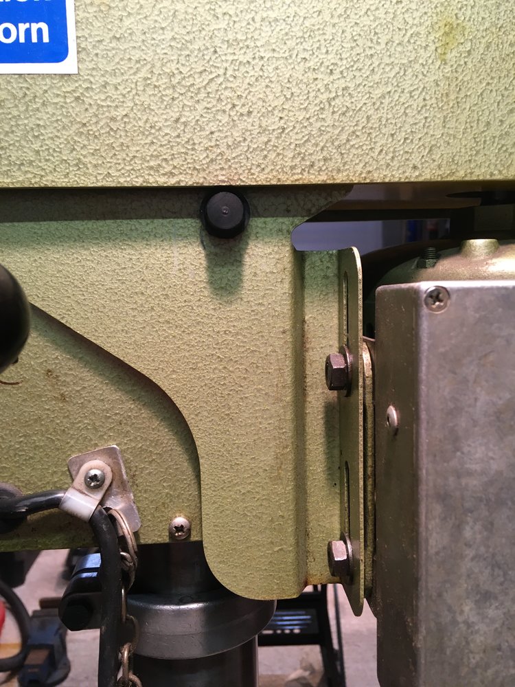

Yeah, bang on.What's the diameter of the groove in the rubber? It should be similar to the hole diameter.

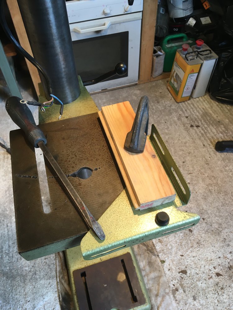

Yep, sorted. Did one this morning and one this afternoon around family duties. A good rolling boil for ten mins, a bit of silicone grease. Parts firmly clamped and stab away at it with a screwdriver. First one was a bit easier. The second one took several attempts and re-boils! Getting as much as possible through the hole before it cools down seems to be crucial. Thanks for the advice all.Been thinking about these rubbers all day..are they in yet?![]()
