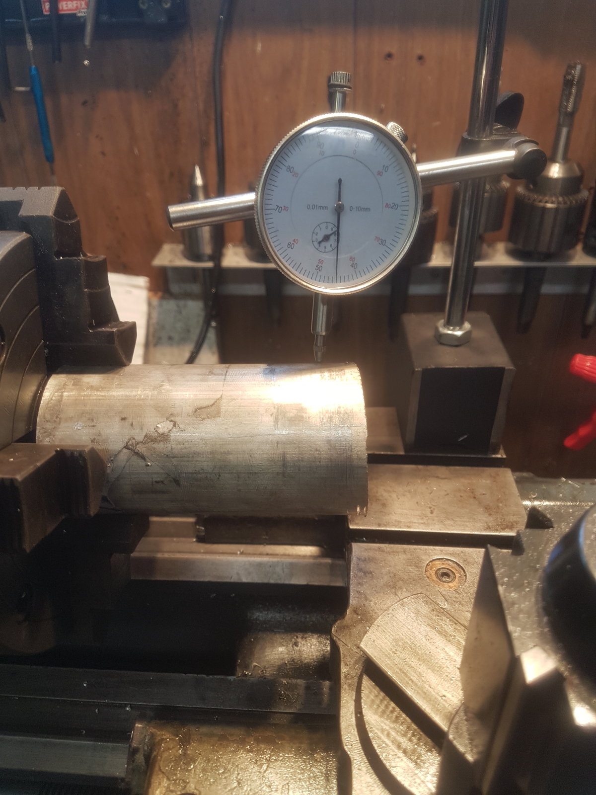

you could have center drilled and used a tailstock centre to stop it moving as there is a lot of overhangmy 3 jaw only gripped the work 10mm I was worried about it being wonkey and coming loose
What are you making? Chances are you will get a dozen suggestions how to machine it and all will be suitable but not necessarily for you or your equipment.![]()
i take it a half center would be better for facing it offyou could have center drilled and used a tailstock centre to stop it moving as there is a lot of overhang
that'll be 0.2mm, if it was 2mm out you wouldnt need to be using a dial indicator, you can see it just by turning it
they were just 2 replacement body mounts for my off roader, the body was lifted 4 years ago but the front 2 had big 1.5" rubber blocks under the mounts, the rubber has now compressed and it also compreses that much the bumper hits the wings on articulation. So made 2 new longer solid mounts to replace the 3" and rubber blocks. all good the job is done and the blocks fitted. I am just learning so any thing to make life easier next time
