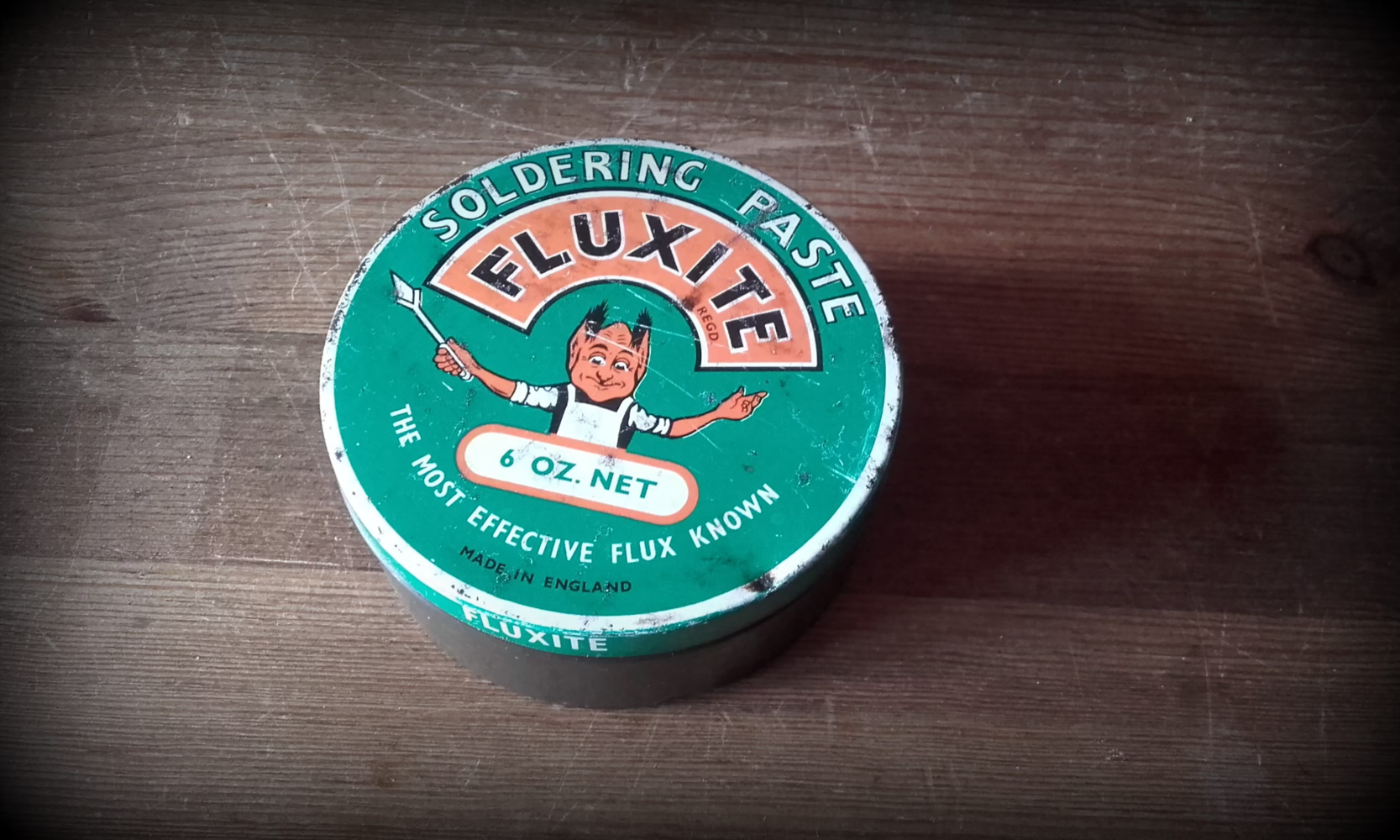

Would work fine, but I'd want to clean off flux residue ASAP afterwards.dont have any flux either lol
or would plumbing flux do the same job ?
Just make sure you clean it all up when you're done, it's more corrosive than electronic flux (Which is rosin, same stuff they wax violin bows with, so if there's a music shop on your high street you might be in luck).dont have any flux either lol

tried that too lol..so that flux paste is acceptable to use? would i be wiping it on the braid the melting it in with the iron?Pop a dab of fresh solder on the reticent solder, then try the sucker again.
