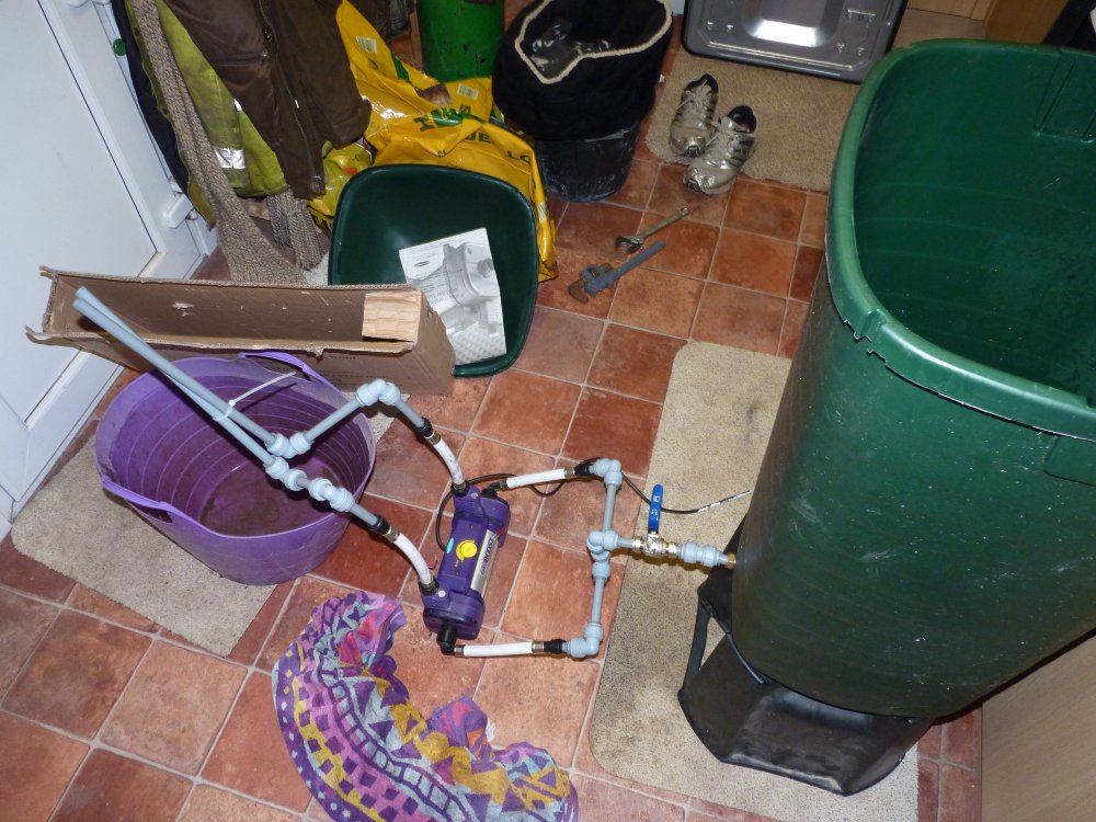

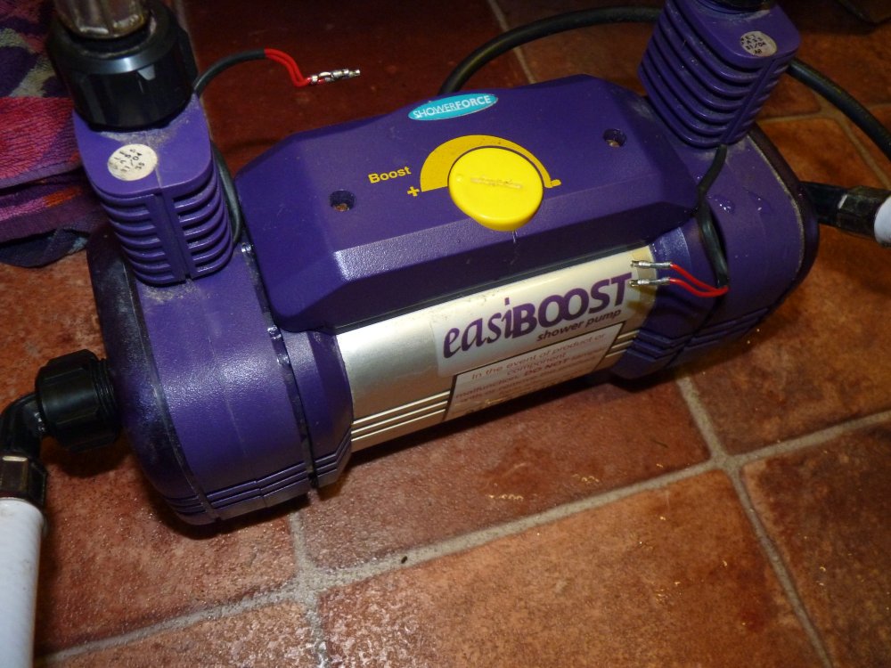

this is the kind of thing i was thinking ofWhat kind of pumps do power showers use? Ebay isn't throwing up anything with that description but it sounds plausible!
http://www.ebay.co.uk/sch/i.html?_o...shes&_nkw=power+shower+pump+-brushes&_sacat=0

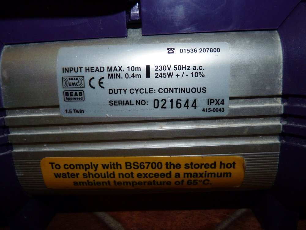

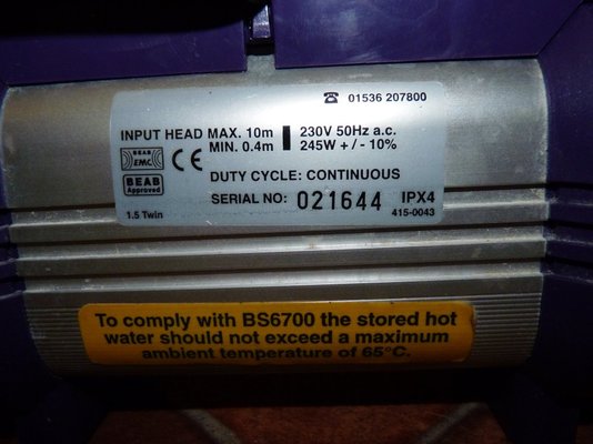

That's why the red leads are hanging out. That does mean there's no minimum head now though, subject to not starving the impellers and running it dry which will kill it.
