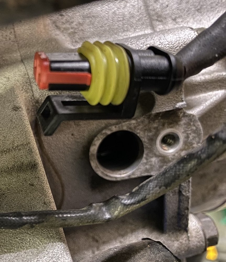

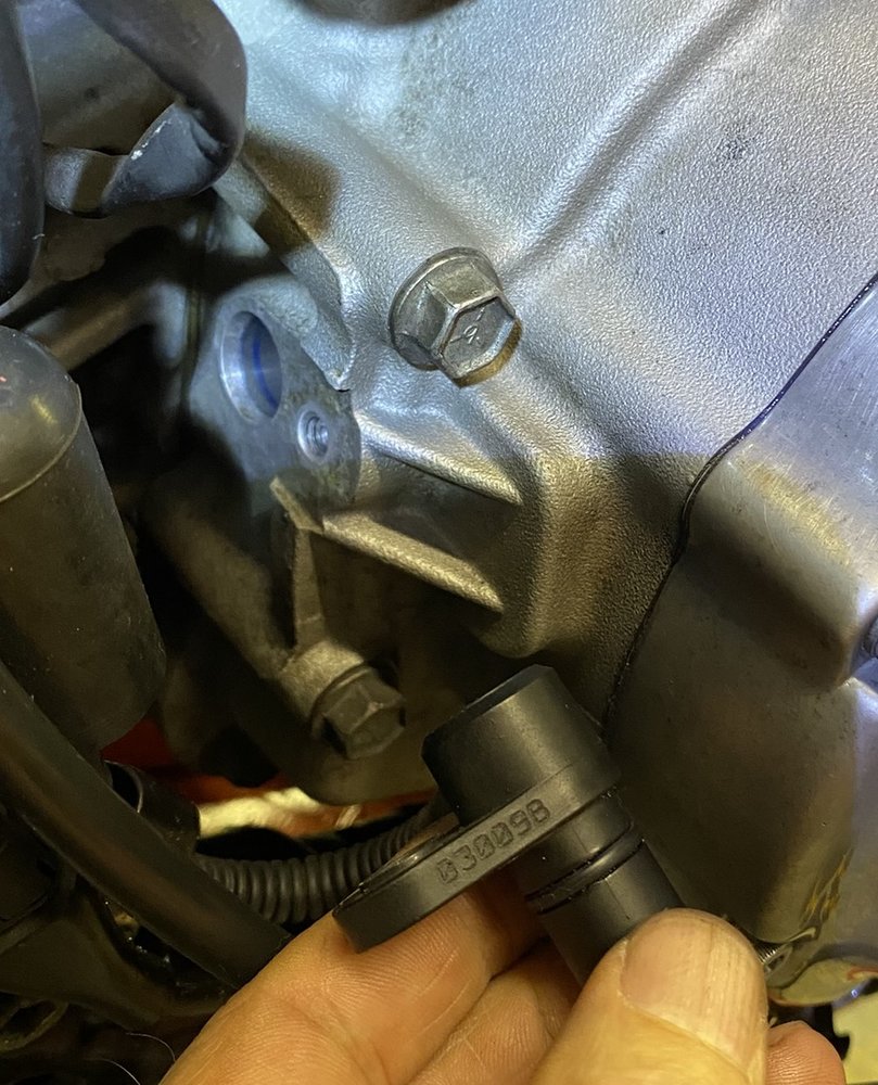

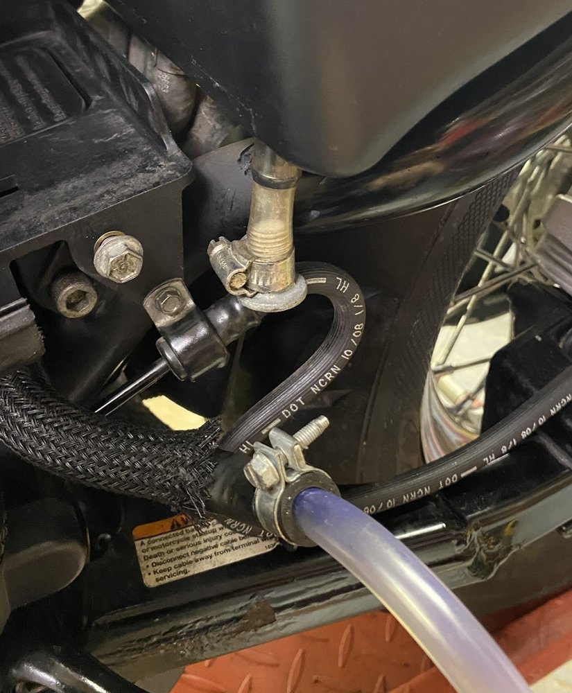

RichardM - thankyou so much!!!Is this your style of crankcase? Have a look halfway up the front of the crankcase there seems to be an opening, although I have also seen that style without that feature.
These photo's answer all my concerns.
The crankcase and gearbox/primary drive areas are isolated from each other.
The opening you see is actually a route for the oil tank drain hose.
Although 2006 crank cases, which are pre-injection as this was launched in 2007, (as my bike is), I would doubt any significant difference in the bottom end.

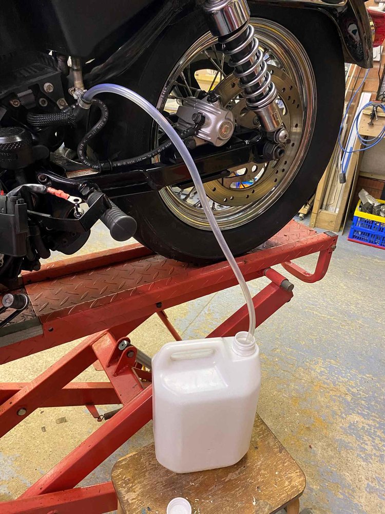

PS: In one of the photo's you can see the oil scavenge gallery and pick up point effectively cast into the casing - which as described above, I couldn't access it.
), there was fortunately no evidence of moisture on the crankshaft flywheel, (difficult to photo), nor when I rotated the engine.
); only oil came from the scavenge pump into the bottle with no sign of water.
