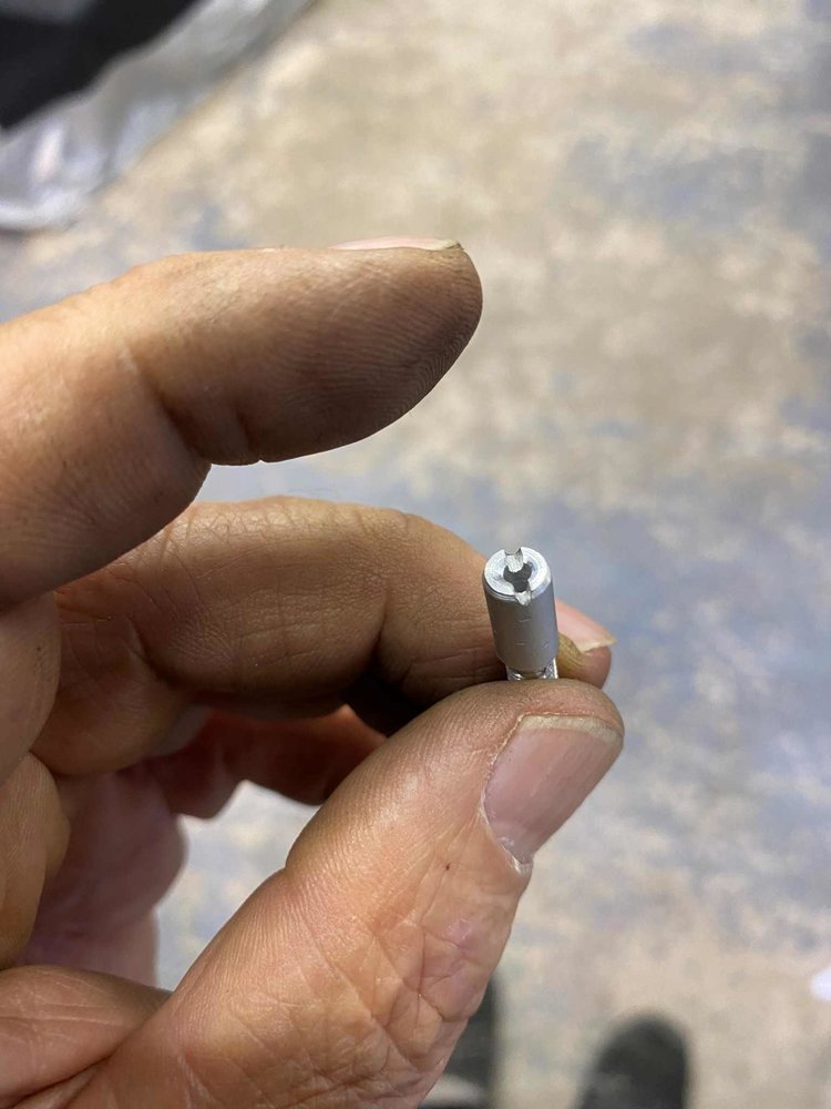

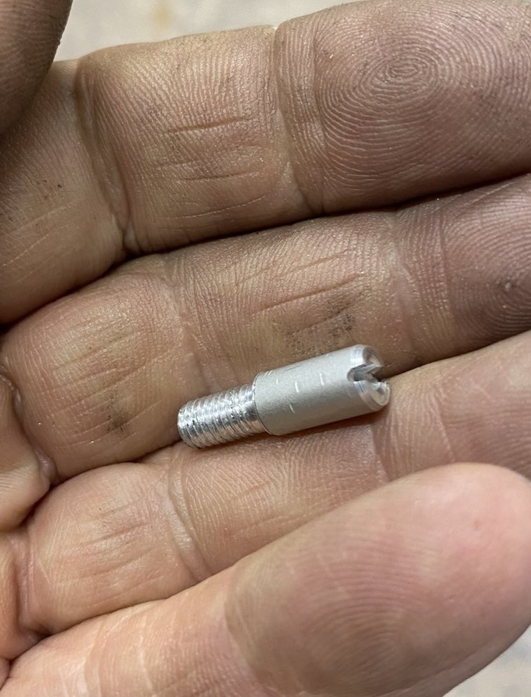

It may be that under your test conditions the engine is not sucking in the air fast enough to carry the fuel in.if I "blip" the throttle - it seems the accelerator pumps inject too much volume of fuel.
Many thanks your reply.

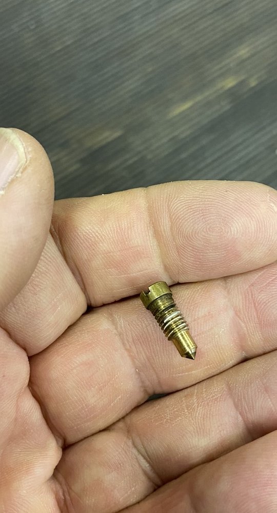

Please see photo's of said screws in my original post - there is no through drilling as I expected. Have poked around with nozzle cleaners. I equally expected them to function as per your description - they don't.

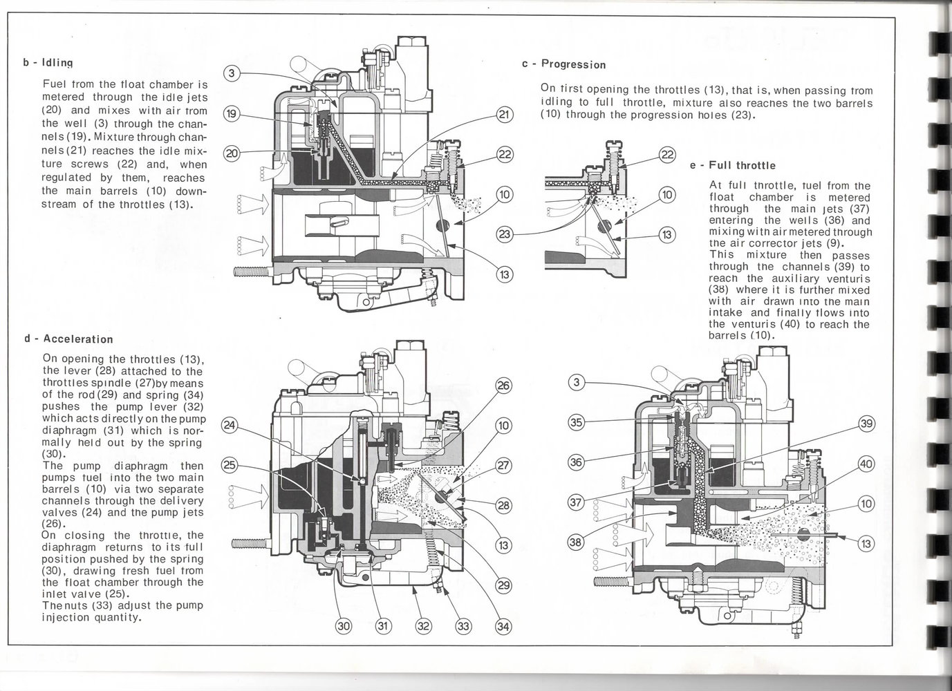

On Webers there is bleedback jet so that not all the fuel is squirted in - effectively you can play with the stroke of the pump, the bleedback, and the actual squirty jet - gives a good range of adjustability. Not really played with Dellortos, although I do have a single 45 here.Yes - the accelerator pump mechanism is an arrangement as you describe - and yes it would be adjustable as you equally surmise.![]()
Yes - fuel drips out of the inlet trumpets if I "blip" the throttle - it seems the accelerator pumps inject too much volume of fuel.
At idle, with the accelerator pumps not operable and dormant so to speak - all is good.

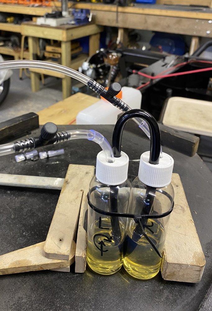

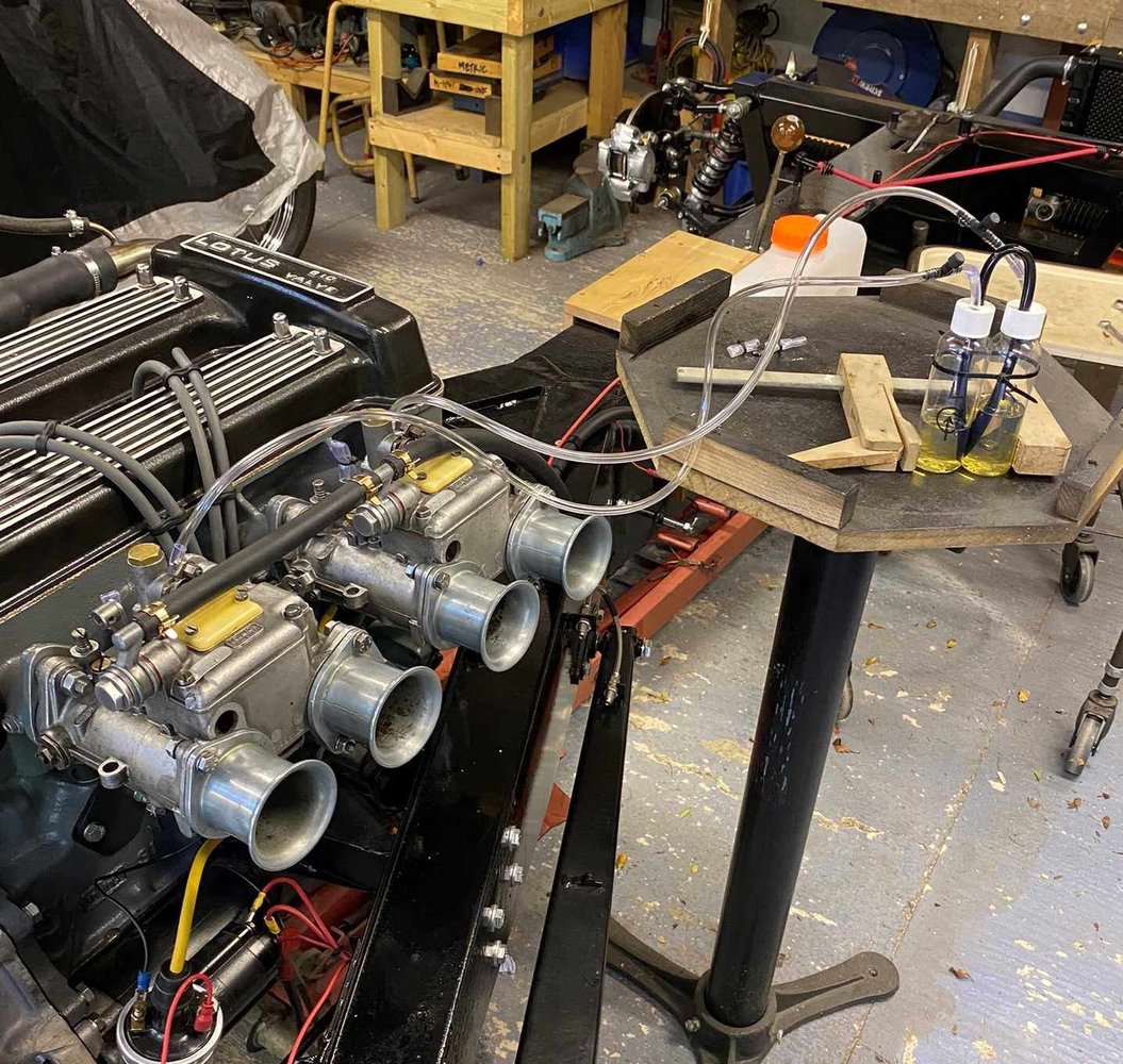

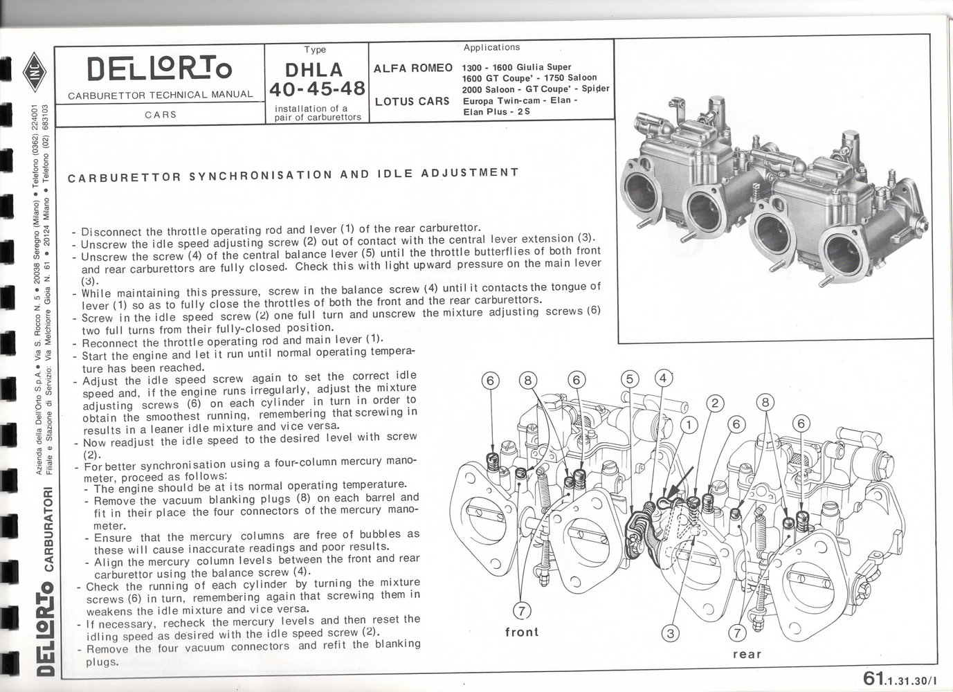

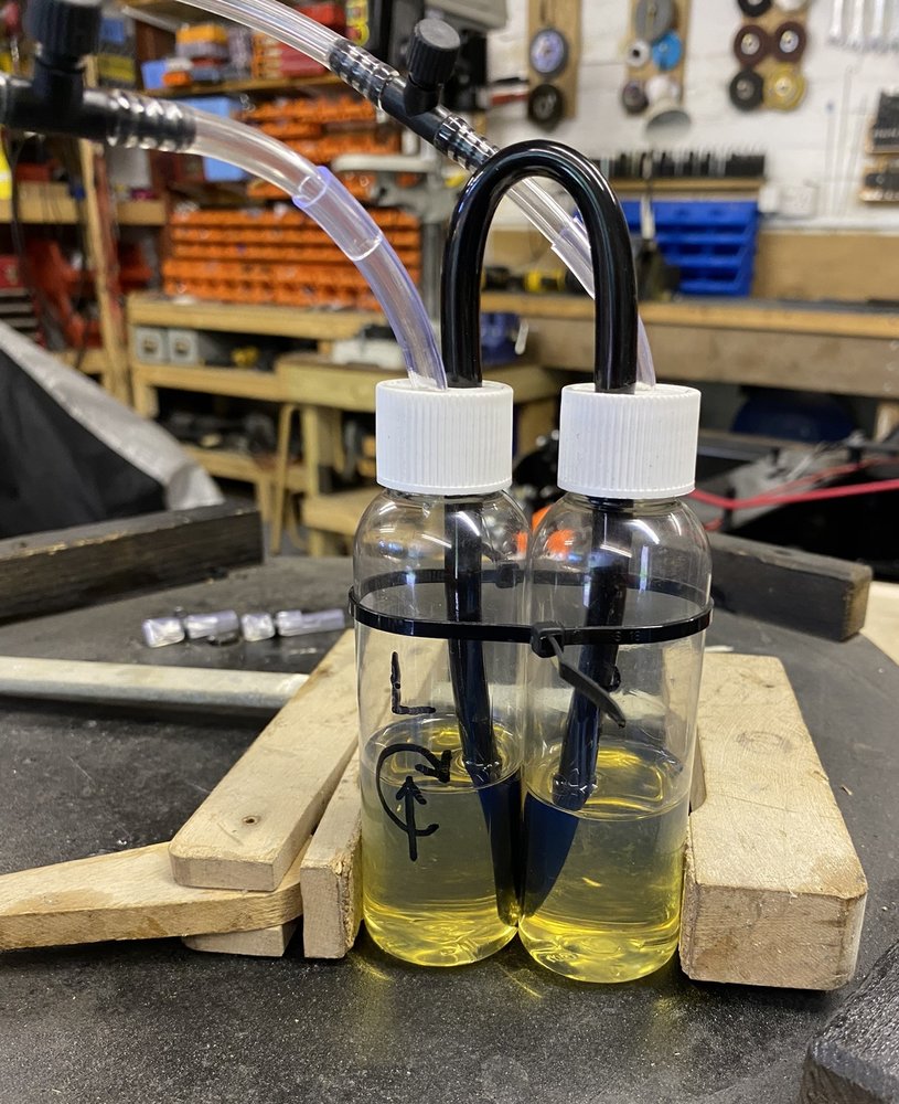

. I first balanced carb to carb, (as the throttle spindles are common to both butterflies), and then balanced butterfly to butterfly on the same carb using the air bypass screws. It was quite a mission and a learning curve, I had to experiment with various liquids and the in line throttling valves to slow down so to speak the reaction of the vacuums.
I agree - but I was wanting to simply "balance" and not "measure" the vacuum.Very neat, I love the "specimen jars" for the fluids.
From a technical point I don't think the system needs to be a closed loop, I've not opened my set of 4 gauges up but I think they operate as 4 individual gauges all with open vents to atmosphere. Doing it your way shows the difference between the cylinders so less chance of a large pressure difference sucking the fluid out of your gauges which has to be good news.
