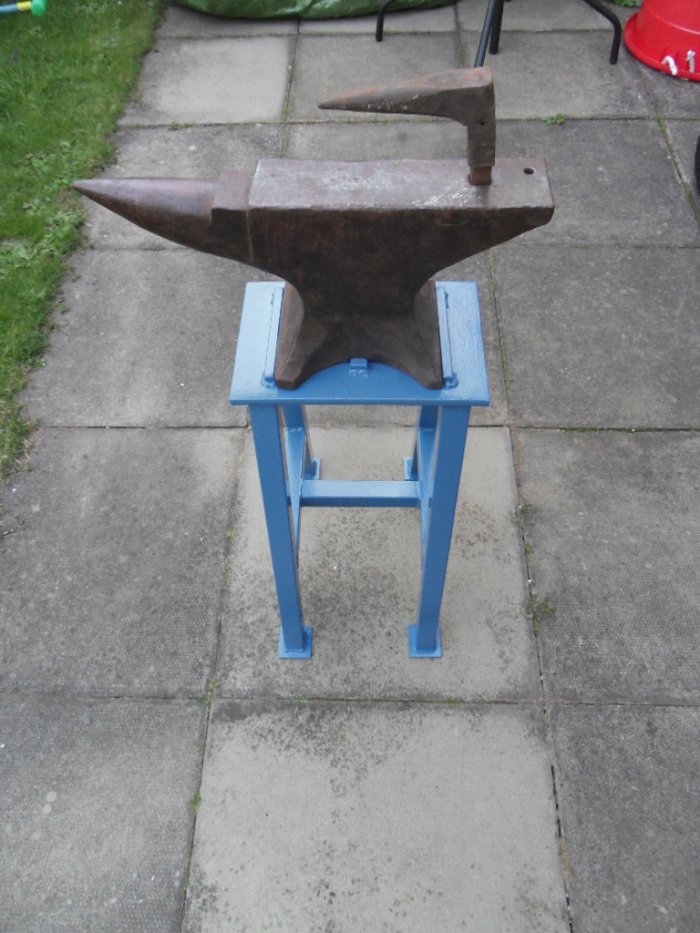

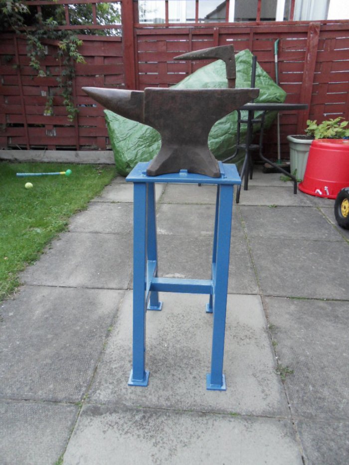

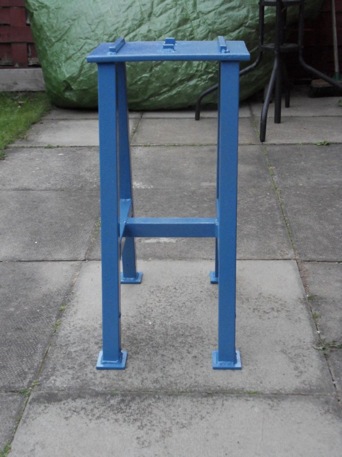

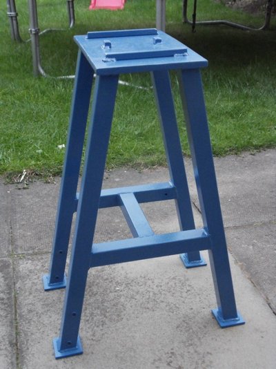

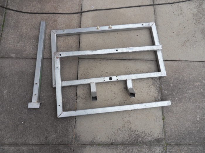

Decided to make a stand for my anvil as I was annoyed at it being on the shed floor all the time, the stand is made from an old folding trampoline that I modified
Old trampoline frame galv 35x35 box
No build pics but here is the finished item
Its not a big Anvil(485x225)just the perfect size for lifting in and out of the shed when needed

try using a 14lb hammer any higher and hold the work at the same time
a 12inch high round tree trunks ideal with anville stapled to it as it absorbs the shock when hit
And to get stubborn pins out Ive also got a 28lb sledge hammer that i ordered special like
