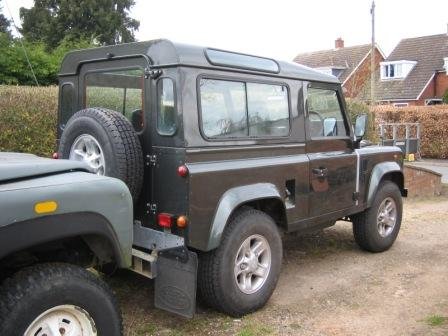

I wanted to protect my Land Rover Defender chassis from futher Corrosion ,but wasn't sure what to use ,i had various ideas given to me ,Waxoyl,old and new engine oil,white spirit with candle wax melted together,tetrosyl, stone chip shultz etc ,then i found "cavity wax" supplied by "Wayside adhesives" on eBay ,after a couple of eBay messages I found out they were only about 4 miles from where i live in Nottingham,so after a visit, i came back with a litre of "cavity wax" and thought i'd give it a go,this stuff is brilliant !,so i went back for another 6 litres ,it's cream in colour but dries virtually clear leaving a waxy coat once the chemicals have evaporated (smells like white spirit), its very thin (unlike waxoyl) and it sprays very easy from a shult type gun ,this was perfect for getting inside the doors,bulkhead,cross members and chassis rails,today i've been back for some of their "under body coating" ,again this is a great product and much easier to apply then waxoyl and cheaper (there is a price difference between their website and eBay) ,there really nice people to deal with,so I thought i'd give them some praise !!
