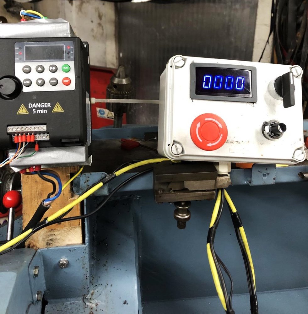

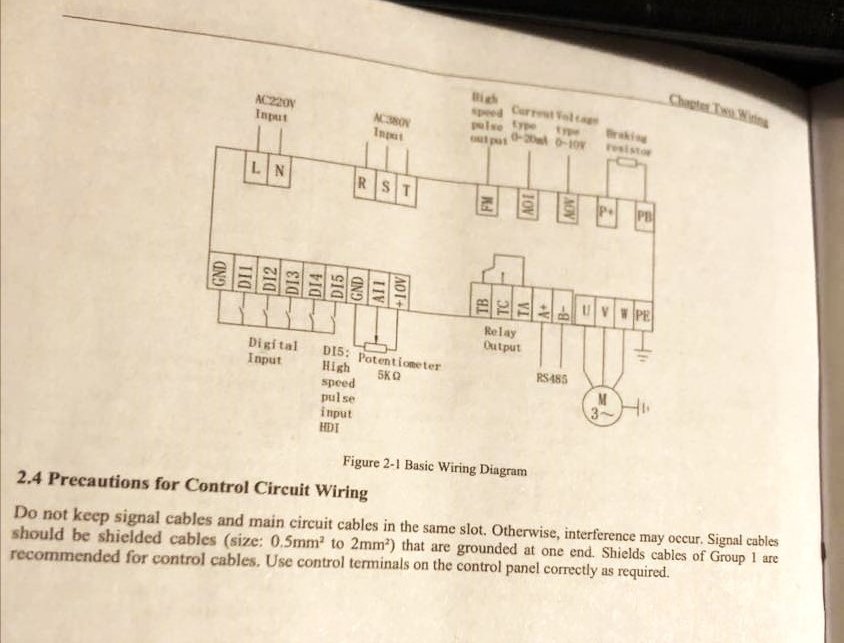

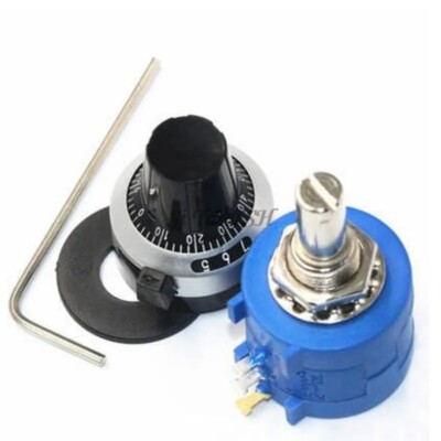

Temp wiring done on lathe, vfd and external switches working, but the odd thing is you have to turn the potentiometer anti-clock wise to increase the motor speed, all wiring done according to chinese/english instructions vfd book, it's ok I suppose but I thought it would be clock-wise to increase as the one on the vfd unit is.
If I exchange the 10v +and ground - wires to the pot it doesnt work at all.
