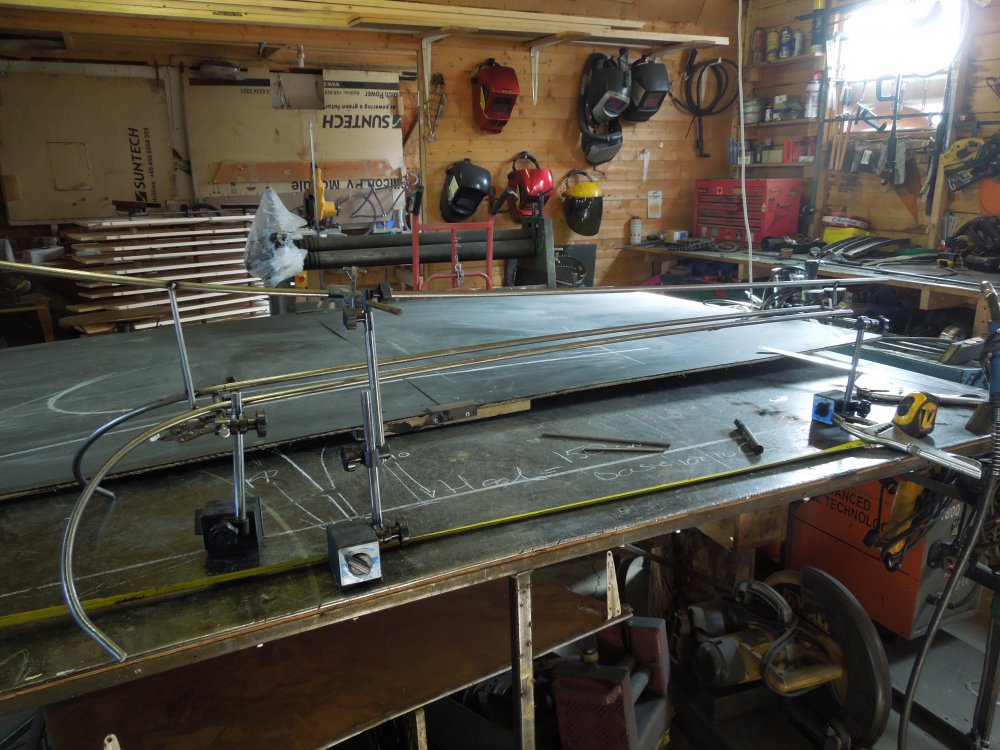

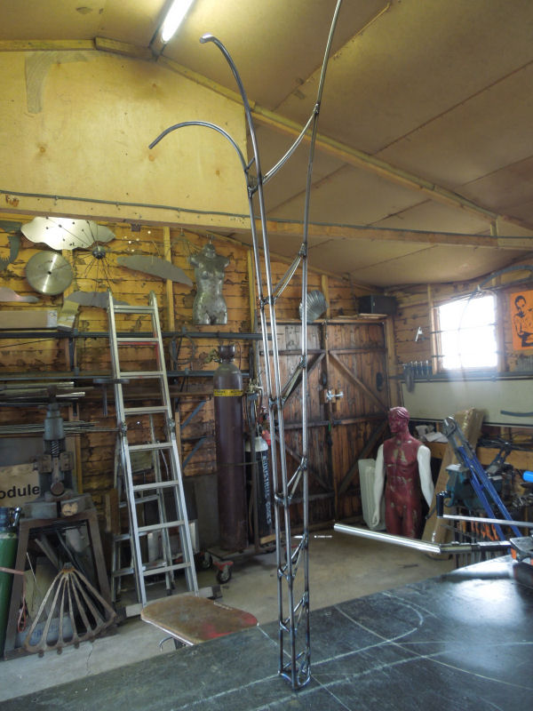

Jigging up the heel, new magnetic jigs are the bees knees
Chuffed to bits with the heel it even stands up by itself.

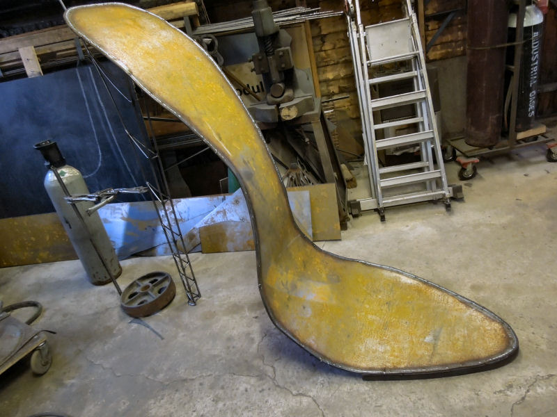

Rolling the sole, a hilarious game I won and did not lose too much blood. my first time using these big rollers in anger. I was amazed to get it right first time.
Then I welded a lip of 10mm bar all the way round the edge and next stage is a layer of 30x5mm strip on it's edge for the sole. Two days in and I am a happy bunny and can see that all my stupid ideas will work.
Next stage is go right round the edges with strip then start making the top infills.
