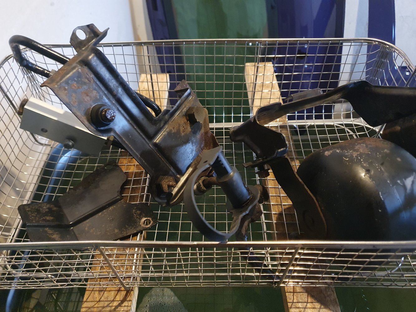

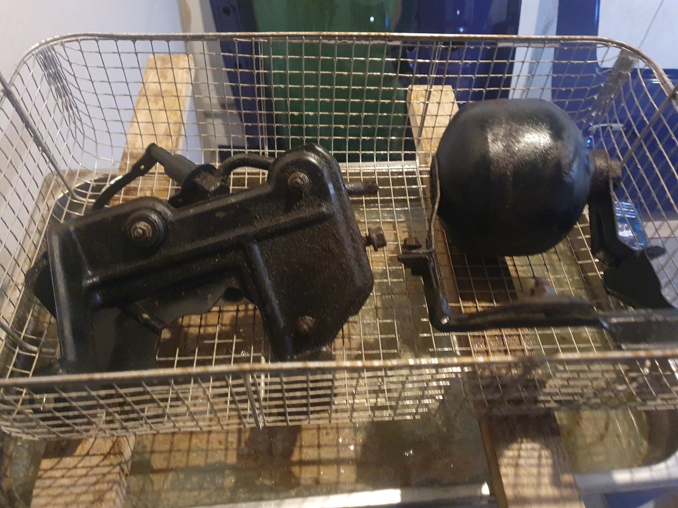

I have tried a variety of degreasers but found them kind of expensive and not worth it. Now what I've been using is hands down, in my opinion.. the most effective.. Dish soap and water.. I fill up the cleaner with water and add about 200ml of dish soap. I have found it very effective on all manner of things. The latest being some bits from my Merc which have been soaked in hydraulic fluid from leaking ABC suspension system.
Here is a before and after.. I encourage you to try it out.
EDIT: Oh and.. I keep about 25 litres of vinegar in 5 litre containers.. and following this wash, I may run these through the vinegar too.. making the parts ready for paint.
View attachment 394020View attachment 394021

Personally i've not noticed it. I rarely put in clean steel into the cleaner. Mostly it's stuff that might already have a bit of rust on it.. and when it comes out doesn't look any worse to my eyes.
Depending on what I am doing.. I will often wash off all the grime with the soapy water.. drain it and then add vinegar. Following that I will hand clean with a solvent and then paint.
