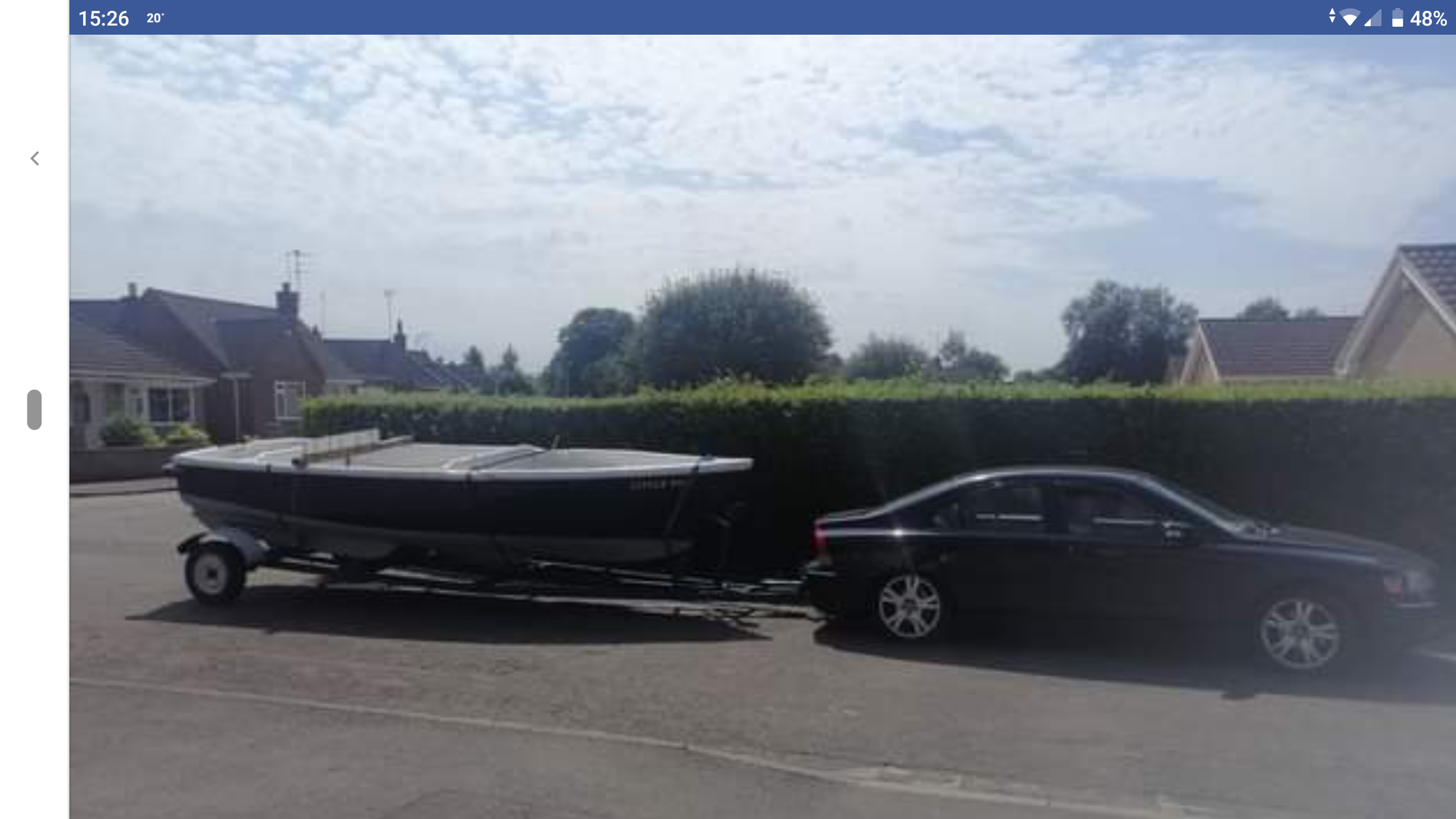

Get a trailer with the wheels in the right place
Bob
I bet reversing is fun.
Actually it should be very easy to reverse
The longer between the tow hitch and the axle the easier
Like wise the shorter the distance between rear axle of tow vehicle and tow hitch the easier and the shorter the tow vehicles wheelbase the easier
move the axle forward till theres just about half a sack of spuds weight on the towbar .will be easier to reverse as wellThis just popped up on the Volvo FB page:
'How do i make the car ride higher with the trailer on?'
I am not so sure about the longer wheelbase trailers being easier,

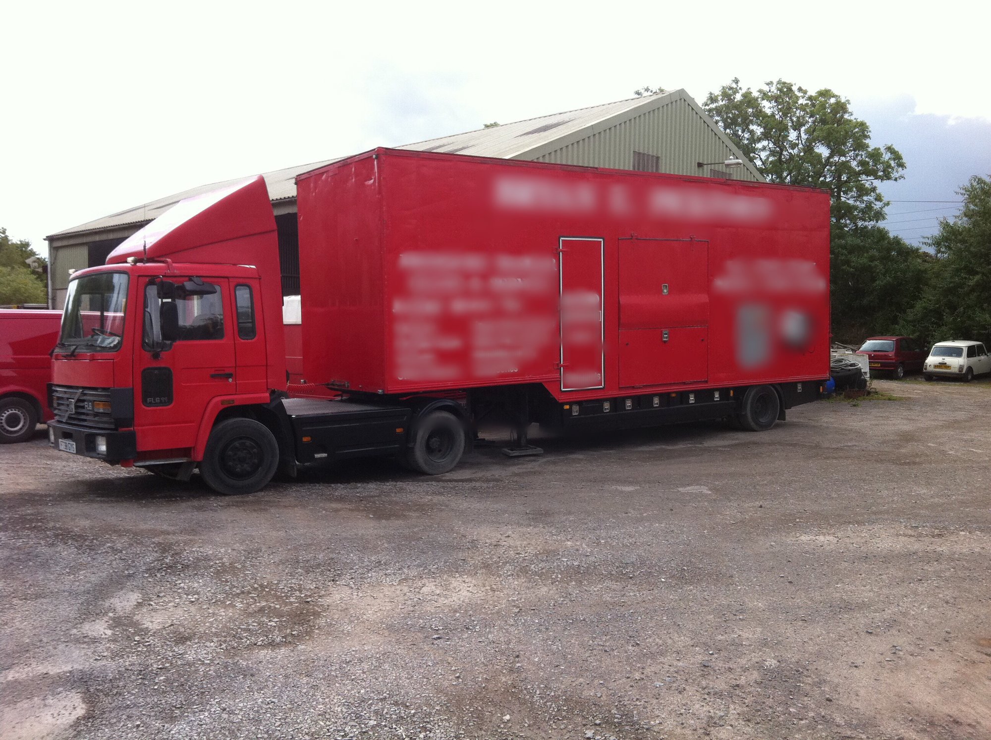

Worst I have had is either a 750kg chipper on an 18t lorry or a 2.7t ifor on a 26t beaver tail with the towball right at the back of the back of the body
you need to swing soooooooooooooooooo wide on bends , left turns and roundabouts to keep it out of the scenery
