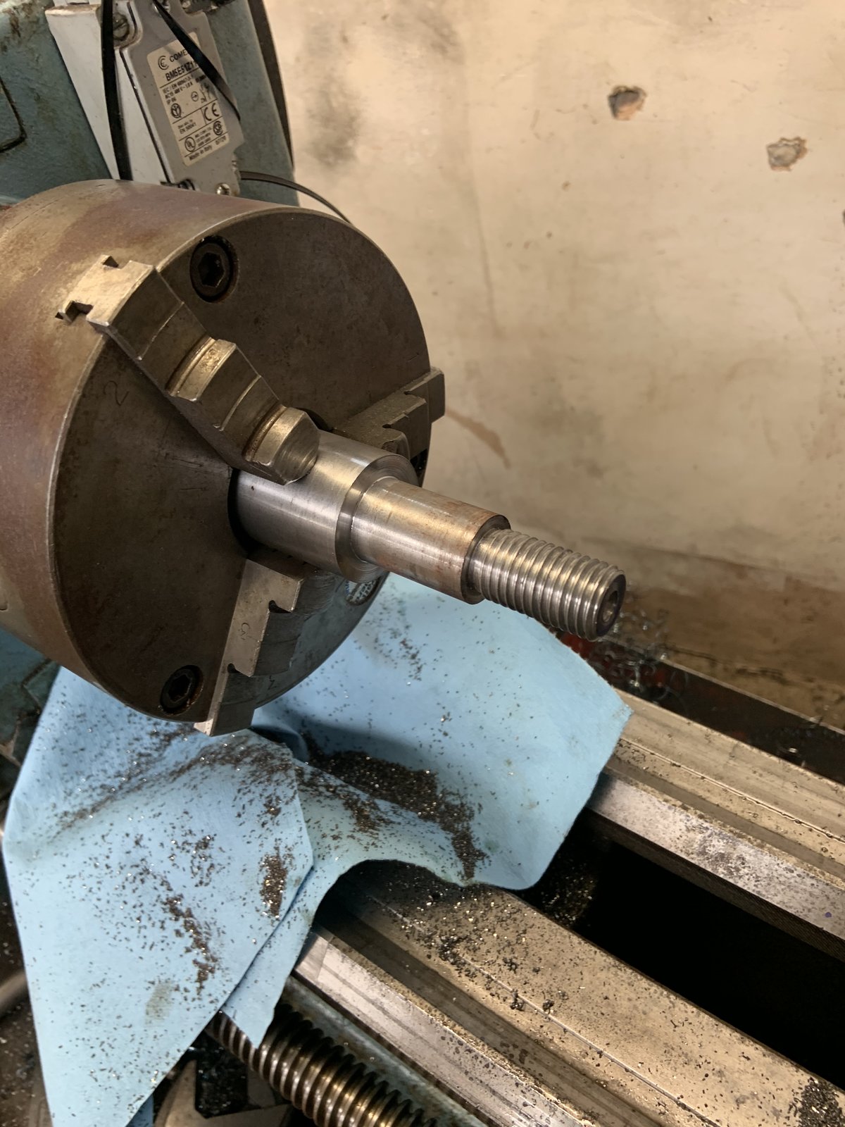

I’ve used a better quality steel, threading at 305rpm now, got a nice thread.
I am trying to thread, M20 x 2.5mm pitch.
My OD started at 20.06.
My OD is now 19.88 and my threads are the full depth of the 2.5mm insert.
I still can’t get a nut on?
Any ideas?
