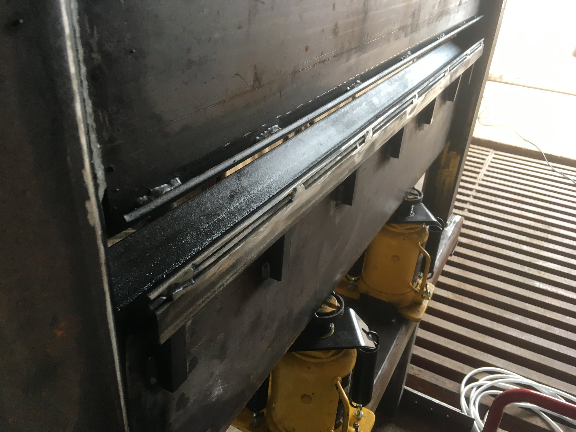

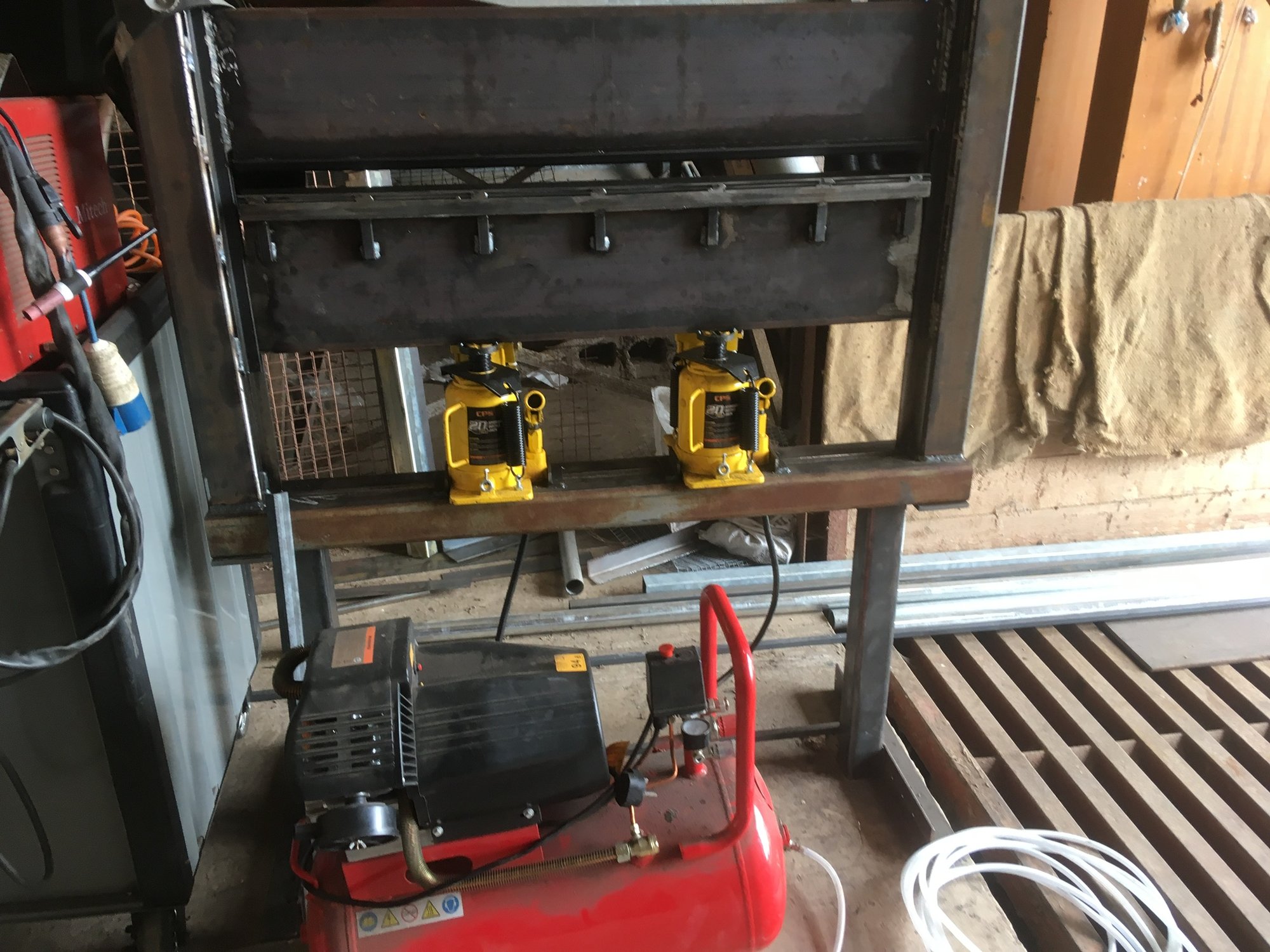

This is my first post and I hope these pictures have come out ok'!
I made this from bits left over from other fabrication projects.
The top and bottom beams are 200x12 flat bar with two 20t are bottle jacks to make it up stroke press
This folds 3mm Galve over 1M length
Just thought I’d show it to some like minded people :-)
