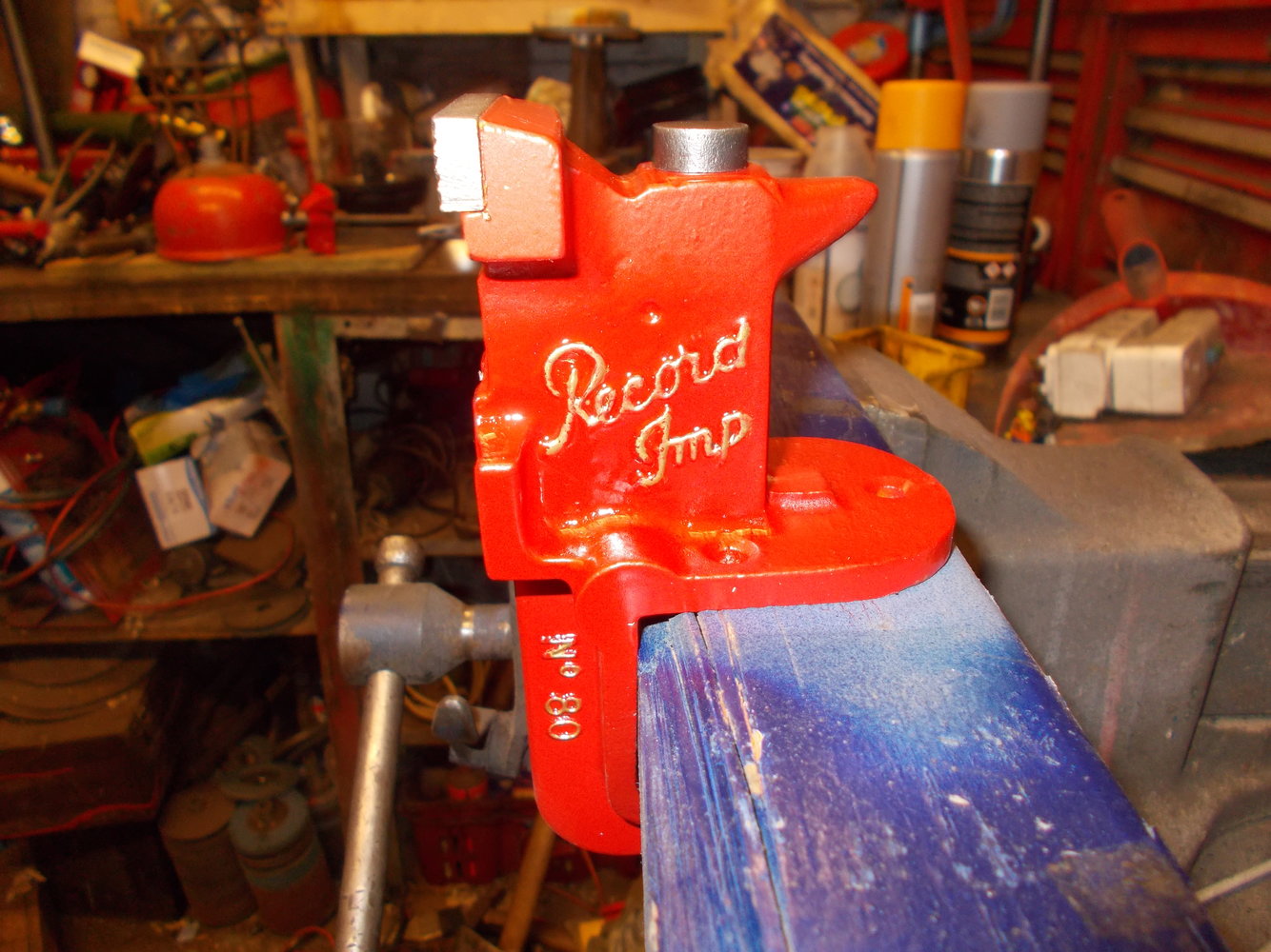

As @MattF said.
The jaws, the handle, the screw thread and the top of the movable jaw leave un painted.
You may find some machined rubbing faces on the fixed jaw, they should not be painted.
Clear coat will be suitable for those bits.
If you have a sudden rush to the brain, the Raised lettering can be picked out in a different colour.
Or gold leaf.
