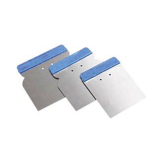

Yes it can work ive done plastering a few times. I also use a wet paint brush to smooth out any float lines ive missed, or to blend fresh and old plaster.
The hardest part will be getting it onto the wall if you cant fit a float in, will have to be troweled on or similar.
