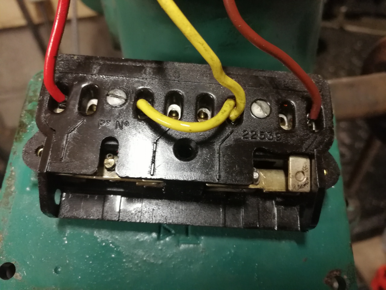

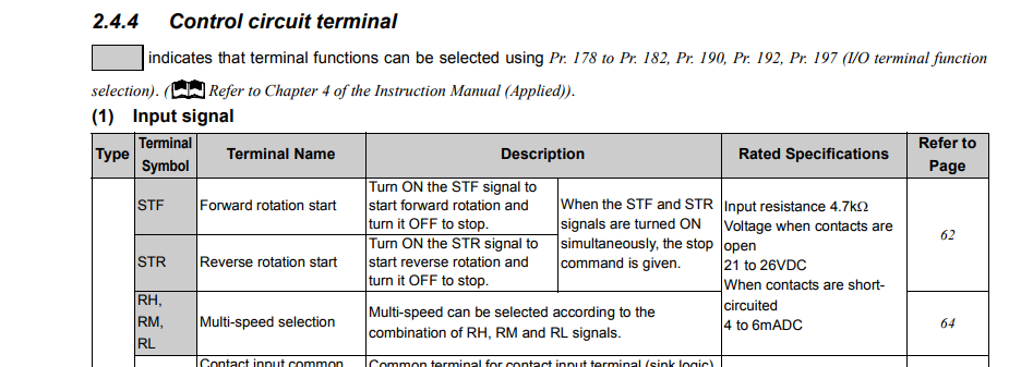

On my inverter it is expecting the stop switch to be normally closed and breaks the circuit to send a stop signal. The start button is wired normally open so it makes the circuit to start the inverter. This was how the Fobco was wired for the original contactor so will just be reusing for the inverter
Both switches are non latching
