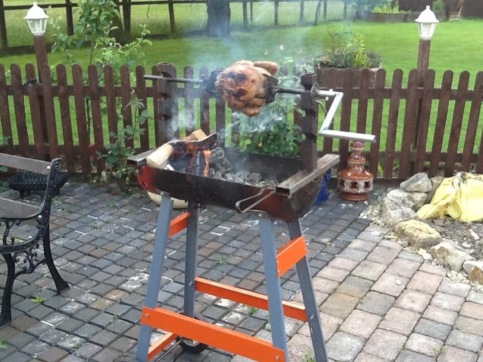

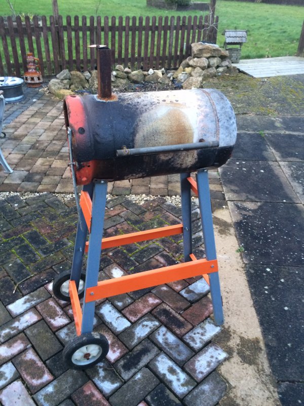

For those that are interested balancing meat on the spit is very difficult so I made a location device with eight holes and pin to hold the meat in 8 positions while turning.
I have used this many times in all three modes and it works a real treat.
If the weather holds up this weekend I will be making a miniature version of this for a mate so he take stick it in the back of his Landy and take it to work, he's a tree surgeon and keeps me supplied with good quality logs
