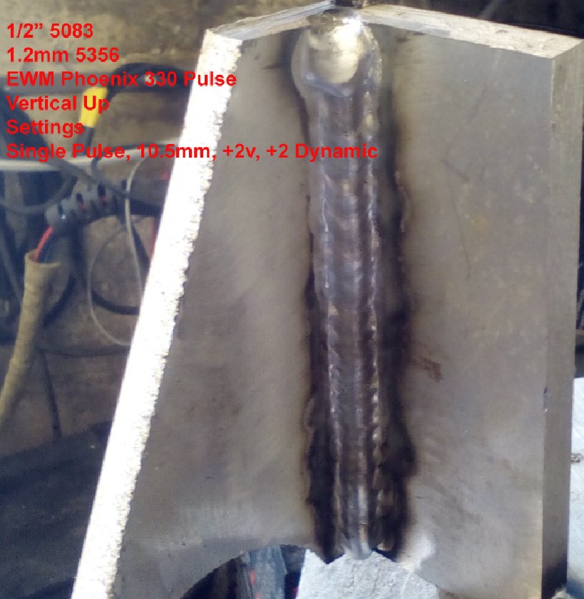

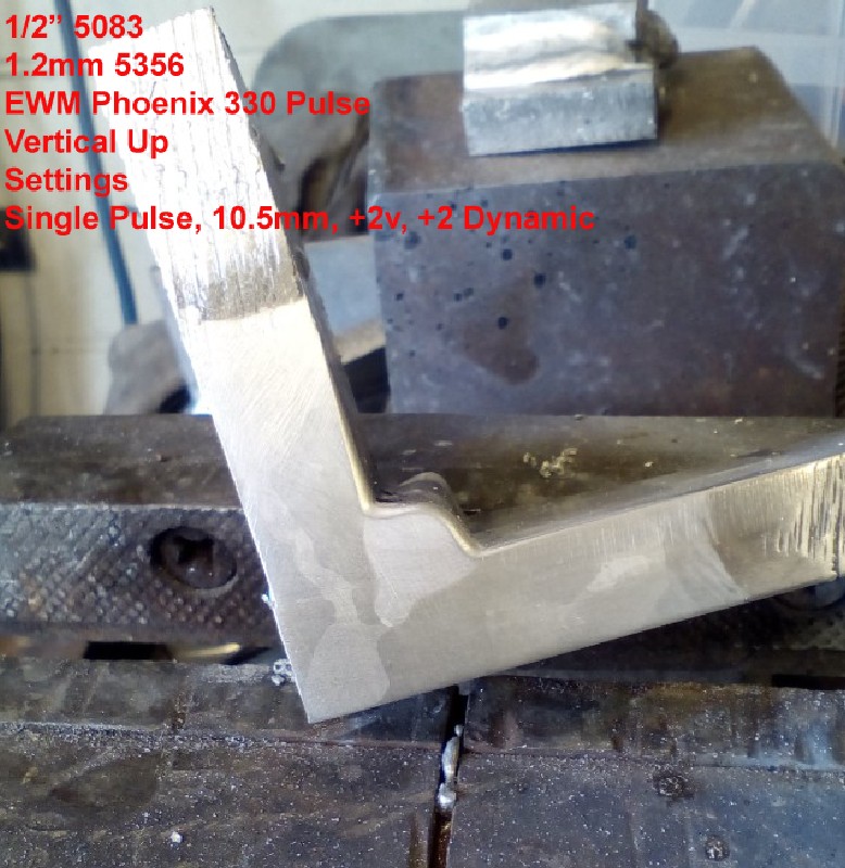

Going to do another vertical up but this time with single pulse as it is what I have been using most with the 1.2mm wire.Some excellent results there hood. I'll have to dig some thicker material out.
It is interesting to see as I have never etched much Mig stuff.They look really good. Nicely fused runs.
Will then gather together some thinner stuff and see how things perform.
Notice some porosity although I notice the single pulse and the last vertical Up don't seem to have any, maybe cut at the right place
Edit, scrap that comment, single pulse one also has a bubble![]()
Porosity is normal and to be expected.
The cross-section area of the porosity is realitively proportional to the loss in strength, so one little bubble is really nothing to be worried about.
The interesting thing is, if you look at the last pic, there seems to be a bubble in the base material itself. Maybe that is just an artefact of the way I cut it or something?Porosity is normal and to be expected.
Try cutting a normal non pulsed mig weld, in theory there should be a lot more porosity, particularly at lower amps.

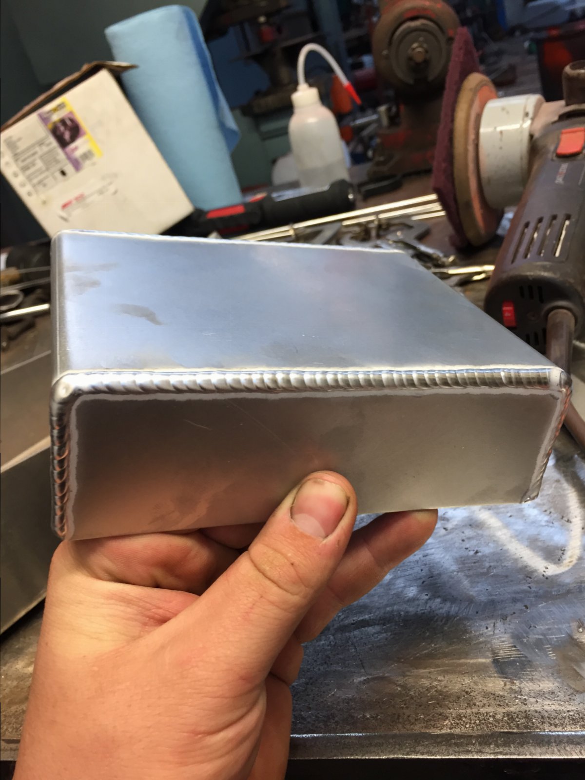

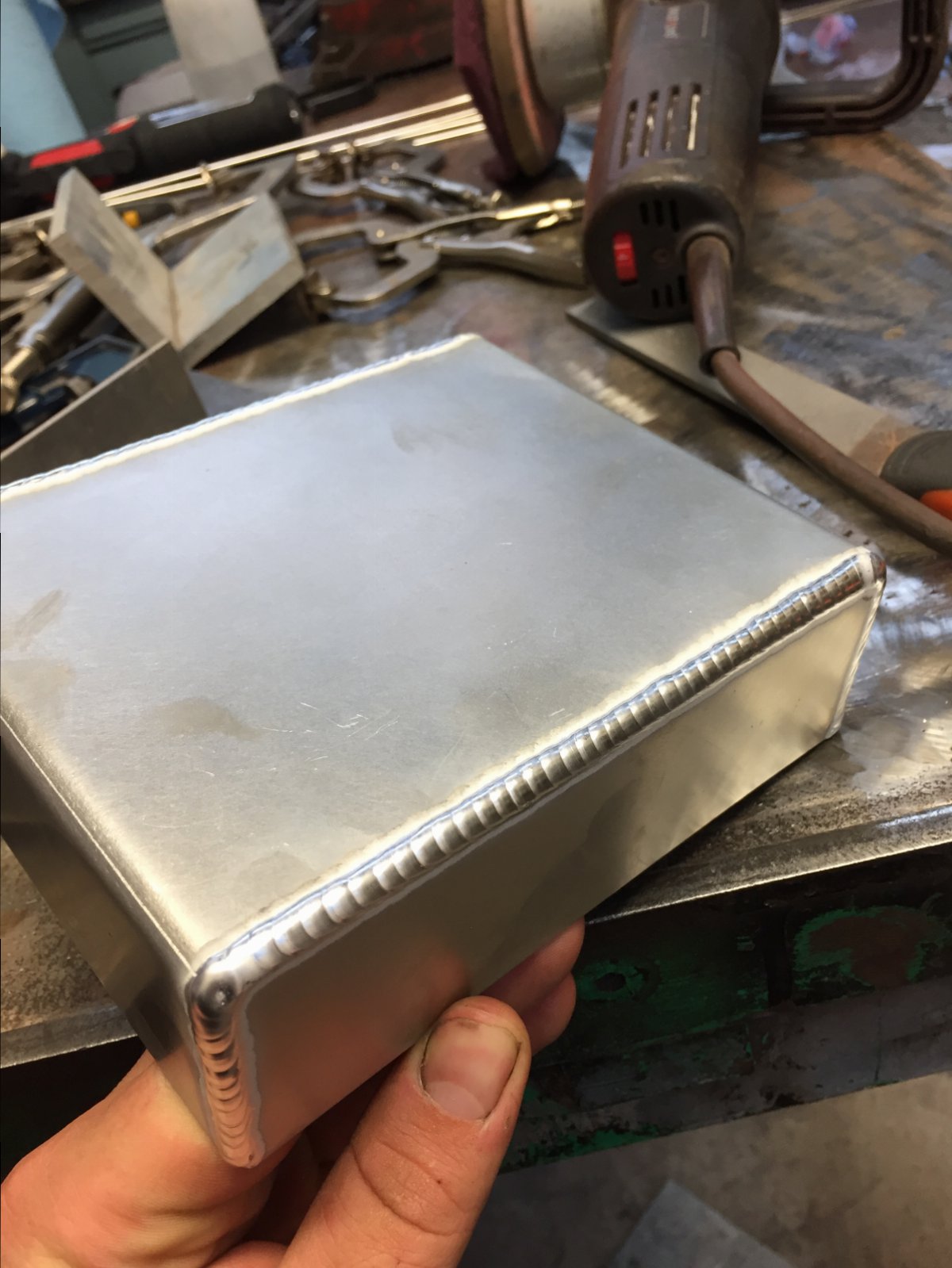

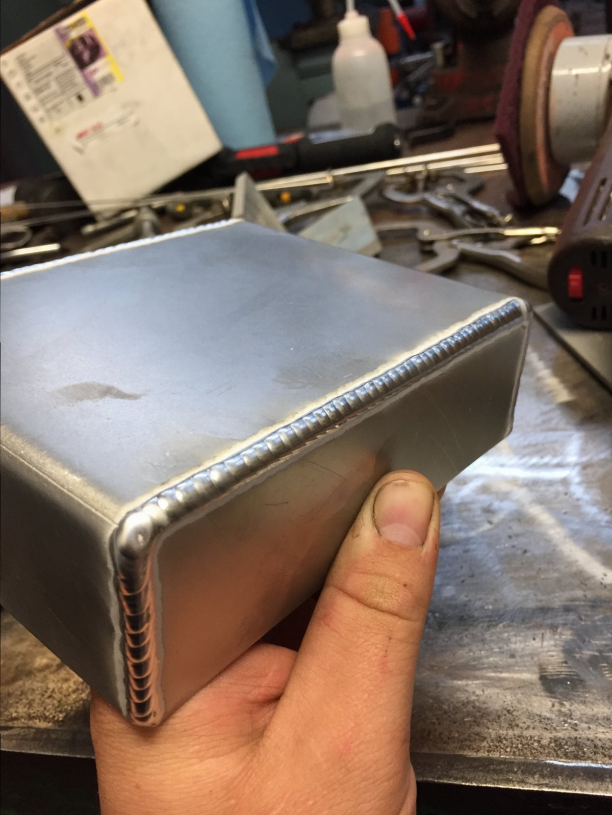

Where did you buy those from Brad lol
Nice work, but sell me your pedal
+ I'll be pestering /chasing you for settings soon I hope!
Yeah the pedal plugs in the back the torch in the front. You have to have a torch switch connected on the lorch if you have intelligent control enabled. You can turn it off but I haven't got round to it. Intelligent control is the ability to control amperage and program from the power master torchesCheers Brad, question, when you are using the pedal.......the on torch control switch is this still needed to be connected to the front panel ?.
Yep 3mm full pen but not too much burn through.Cheers, just looking to use a plain CK9 and 17 on mine to keep the torch size down for now, and control amps via pedal.
Only use the torch it comes with on heavier stuff if I have too.
Pics above out of 3mm Alu ?.
