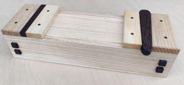

In a bid to put off figuring out the final design for my in-progress garden table, I thought I'd make another box. This then, is yet another box WIP. It'll be what has become my usual approach: hand tools for almost everything: if all goes according to plan the only exception will be a bit of resawing on the bandsaw (as I don't really enjoy resawing by hand).
There won't be any metalwork (let-alone any MIG welding!) on this project, but a few people on here have previously expressed interest in my woodworking projects so I thought I'd post this here and see whether anyone read it!
The box (which is probably going to be a pencil case) is going to be based extremely loosely on the traditional Japanese toolbox. I say loosely as those toolboxes were typically made with extremely simple construction, relying on nails to hold everything together. I'm not going to use nails: I'm going to try to do everything with hand-cut wood joints.
The wood I'm going to use for the project is probably going to be this:
The long plank is roughly 20 mm thick Ash and the short block is roughly 50 mm square Wenge. The reason I say "probably" is having planed some of the Ash I'm already getting a bit fed up of it: it smells lovely when you plane it but the grain is all over the place.

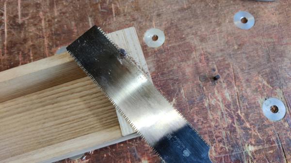

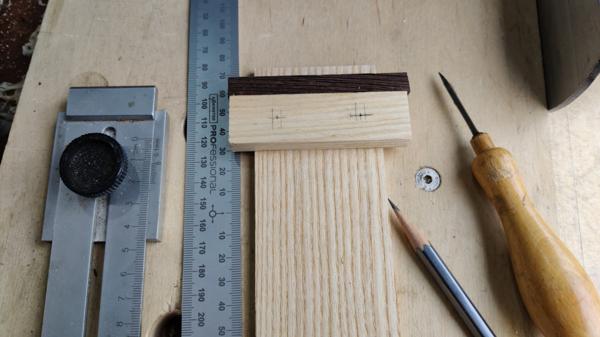

I started by chopping the Ash up into a few pieces:

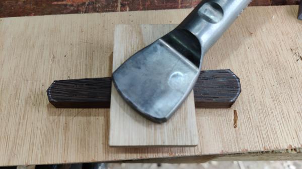

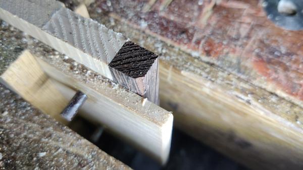

I then planed two sides of the Wenge with a #4½ to get them flat and perpendicular to each other:

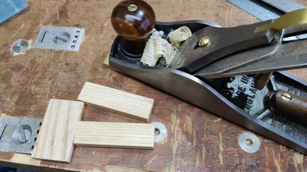

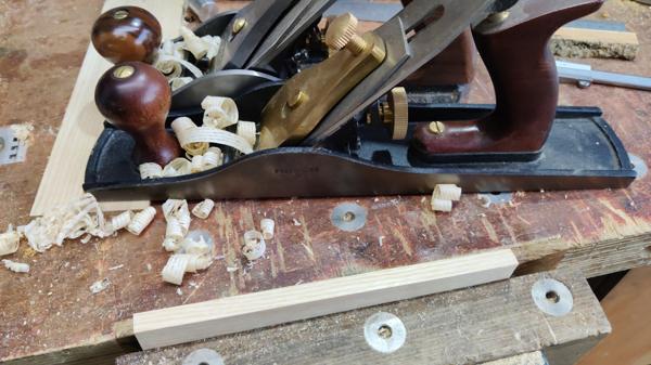

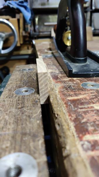

The Ash had previously been planed (it was an off-cut from the shelf unit I made recently), but it had moved a little since then and had a very, very slight bow, so I planed that out. After starting with the #4½ I decided to switch to the low-angle smoothing plane (with a blade with a 50° bevel giving a 62° cutting angle) as it was tearing out in a few places along the length:

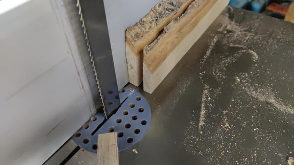

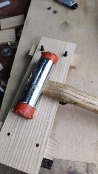

Those pieces also got one edge planed square to the face and then they went over to the bandsaw to be chopped up. Before:
After:

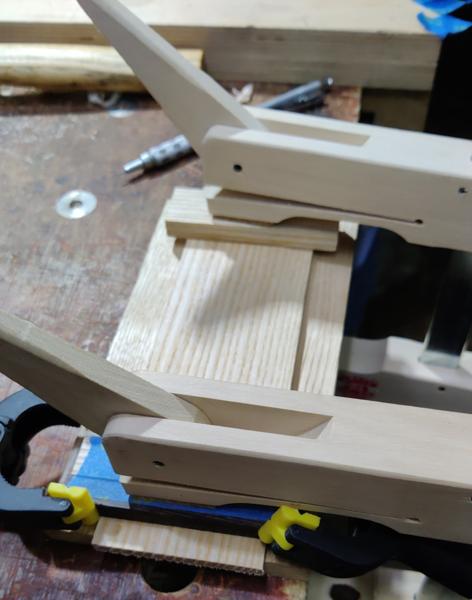

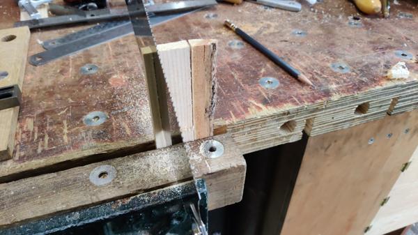

The Wenge also got chopped up, but after each resawing cut, I took it back to the bench for a couple of passes with the #4½ to remove the saw marks before taking it back to the bandsaw for the next cut.

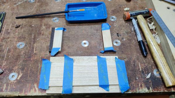

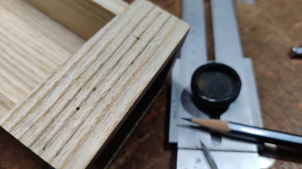

All that planing and bandsawing left me with a pile of wood with lots of pieces just over 10 mm thick and some thinner off-cuts:
That's it for now: I haven't got much to show so far, but one has to start somewhere!
