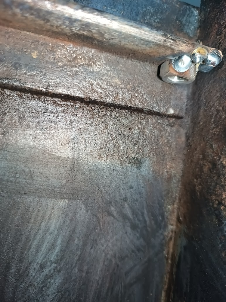

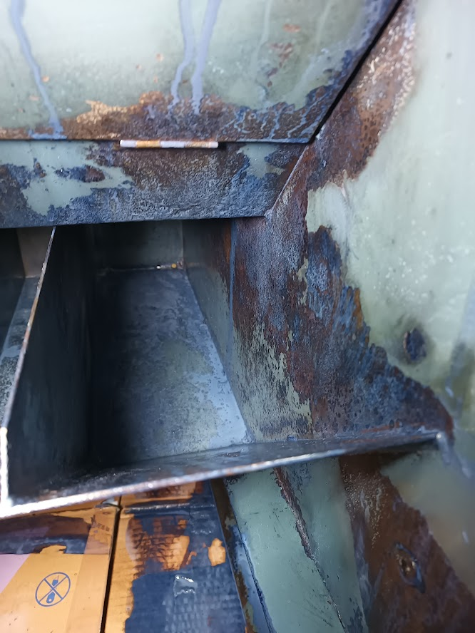

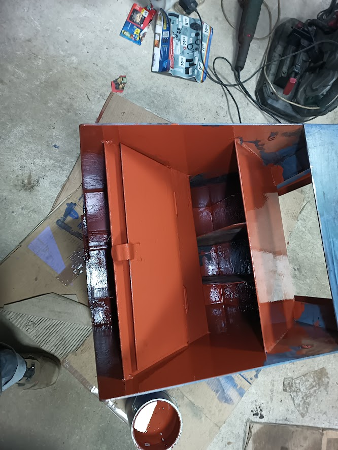

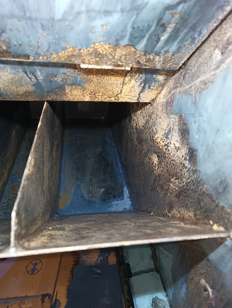

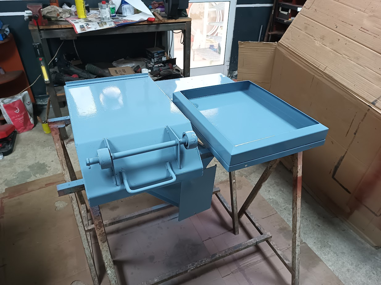

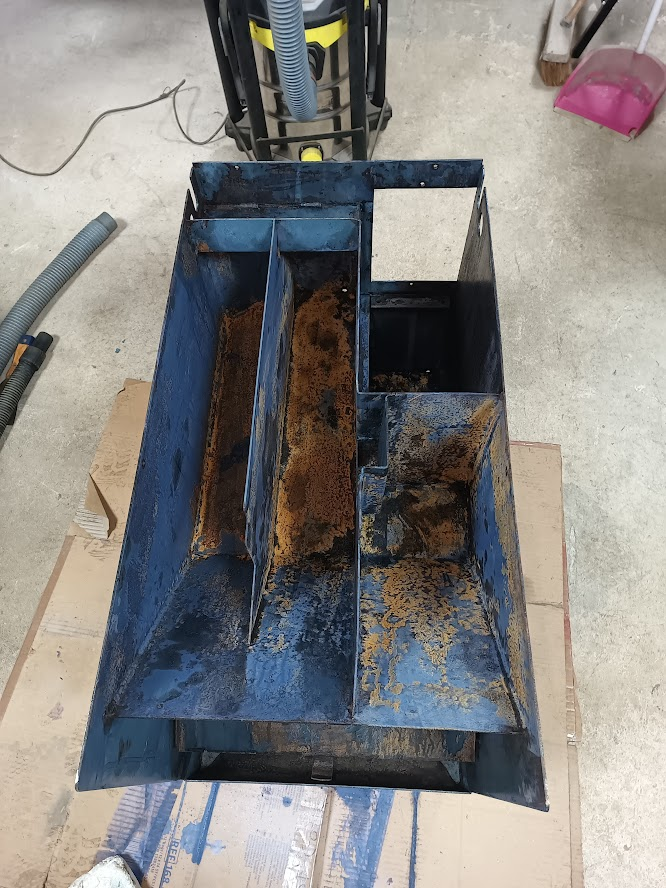

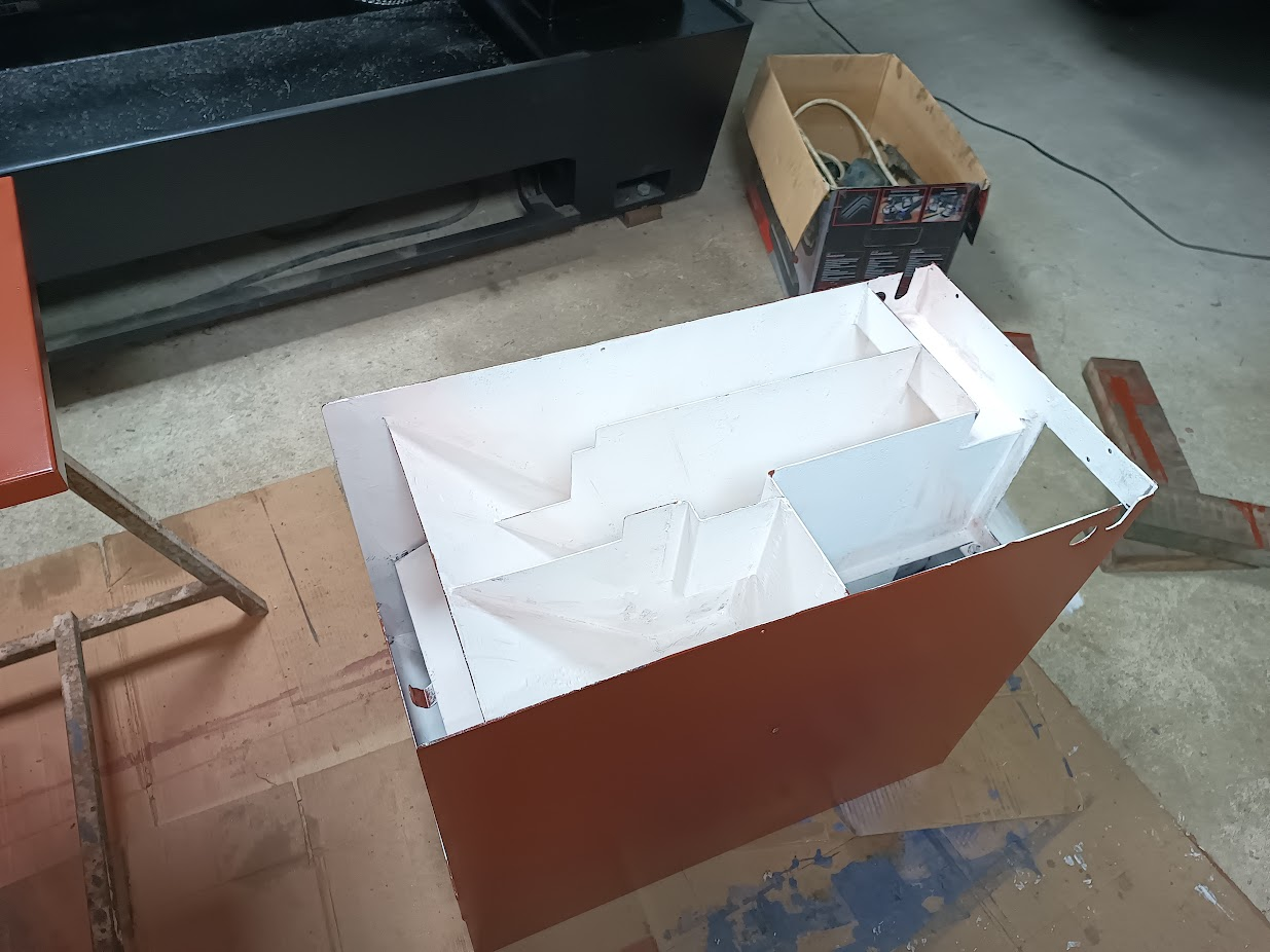

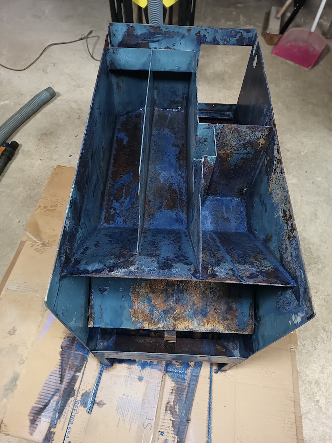

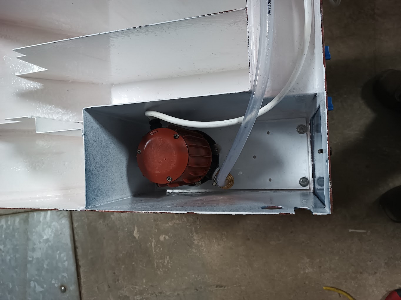

After this was done, I then gave it another clean with degreaser to remove any loose rust as well as trying to clean those areas which I had missed when pressure washing it. There are definitely areas behind baffles which I cannot reach - I guess the ideal way would be an acid bath but I don't know of any one who offers such services here in Malta.
Once this was done I dried it up with some old cloths and gave it a coat of rust converter.

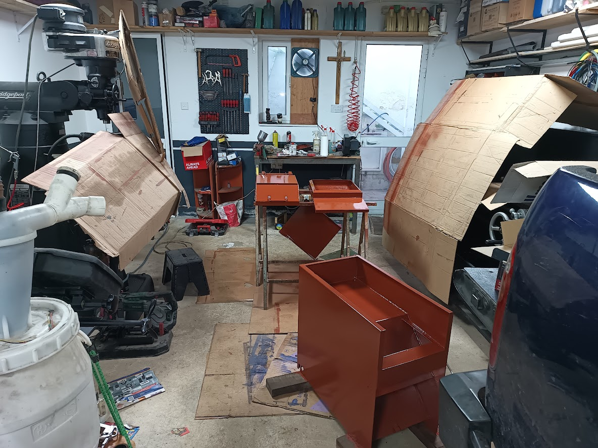

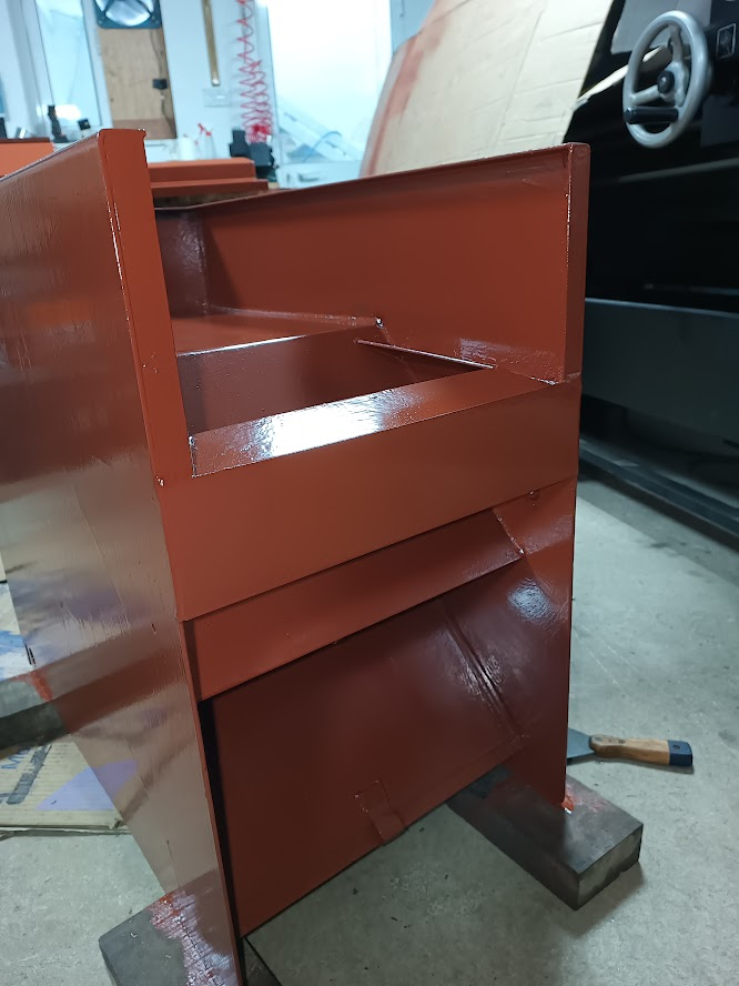

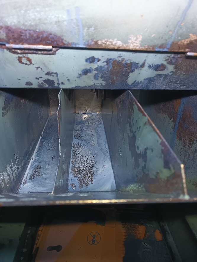

Decided to use the spray gun but once again the bottom compartments were the hardest as the gun is too big to go in. I tried various spray patterns and combinations. In the end a long brush worked best:

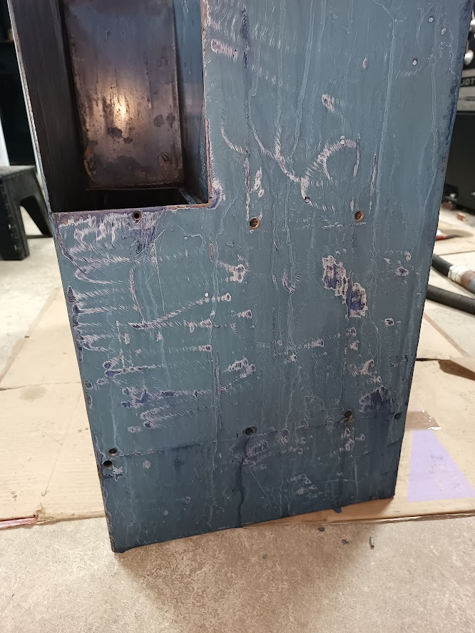

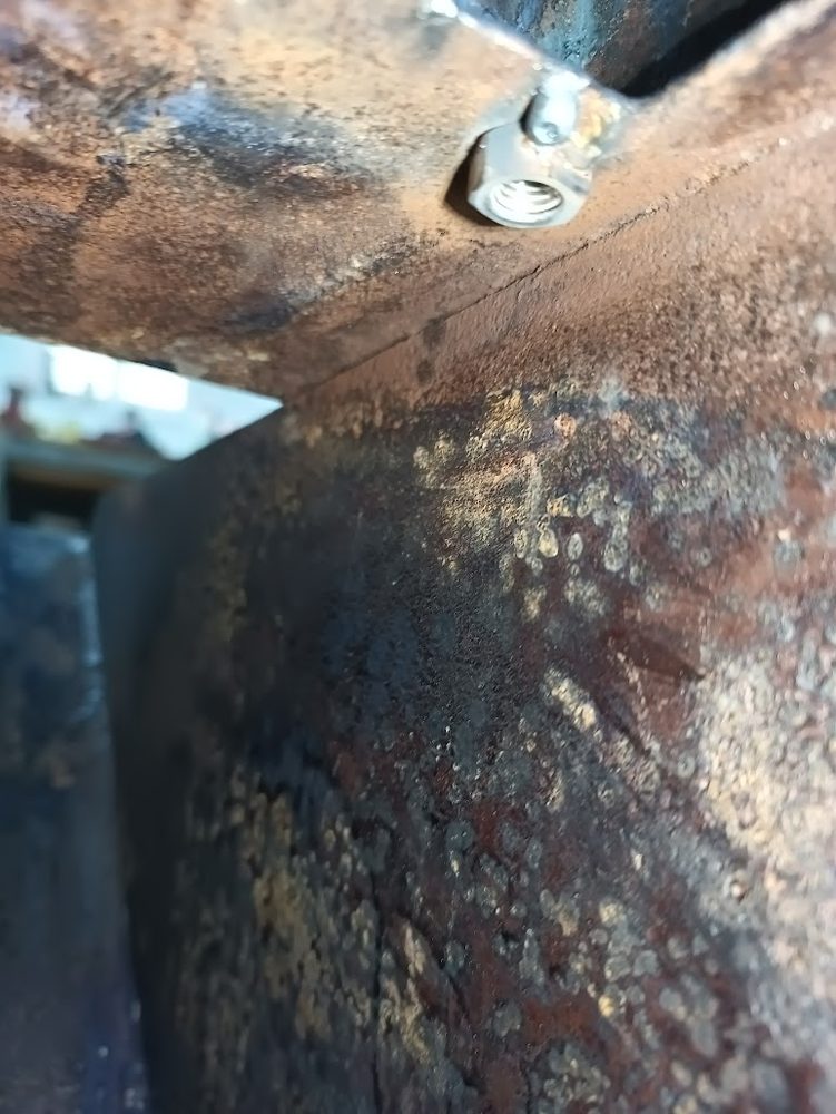

This was yesterday. Today I went down to see how it has dried up and I was greeted by this:
Not sure if I did something wrong but I am under the impression that the rust convertor is to convert and stop further rusting not make it worse

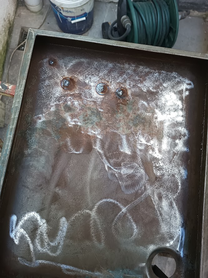

Before I do any drastic measurements and grind it all down again, I got a section and wiped on a different brand of rust convertor I have (I used up all the other one I have anyways). Will see how this fairs tomorrow.

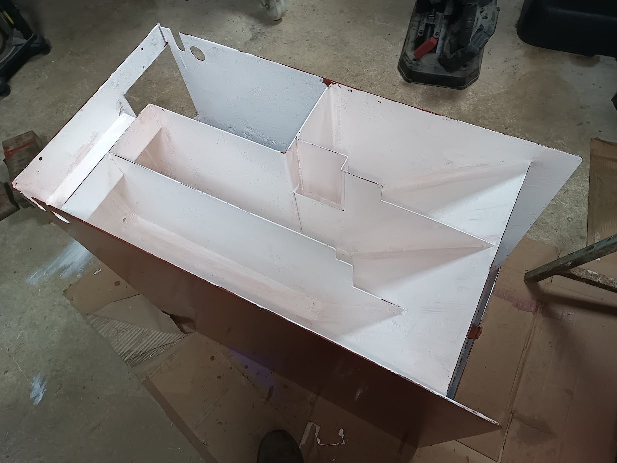

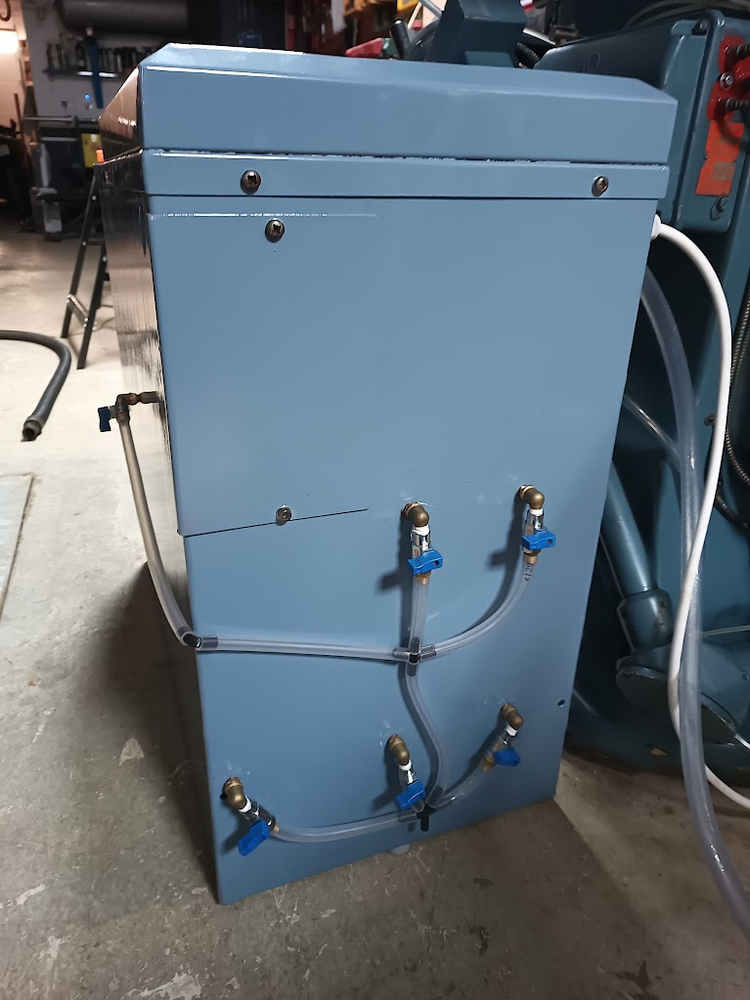

In case anyone is wondering about the holes in the compartments, I added those to be able to drain each compartment individually. Since I wont be using this all the time, I plan to drain the coolant tank so I don't leave it full of coolant and have it rust on me again as quickly. Not sure if this plan will work or if I find it too much of a hassle and leave it filled in all the time. Back looks like swiss cheese:
That's it for now - I finally caught up to the progress I have made. Apologies for not keeping up every week but writing these updates takes time - more than I would like to admit
