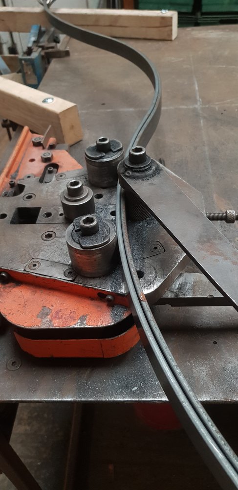

They wanted soem curvy stands for their chrimbo display.
We had a ten minute meeting and I went off to develop my idea. I made a sample and loved it so did they.
I priced it wrong and felt it right to drop the price by 1/3 (still really well paid) and they ordered more,~

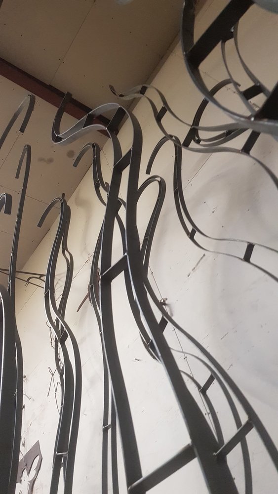

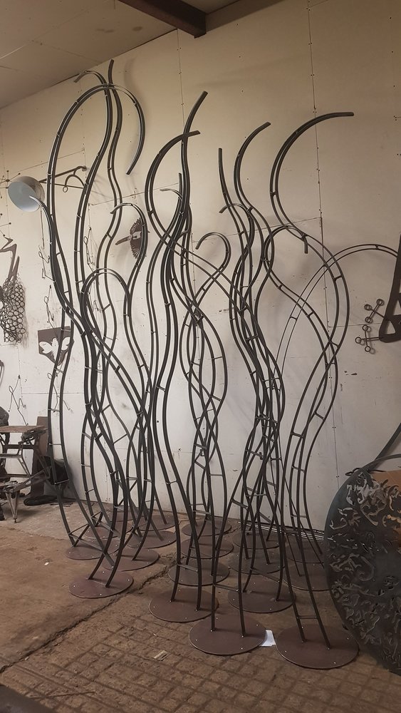

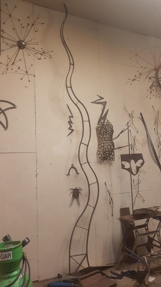

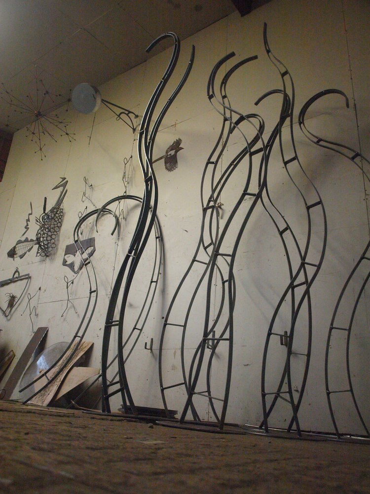

These range from 2.5m to 4m tall. All made of 30x5mm hot rolled strip.
I was so pleased I'm making myself a pair for the garden.
I was worried about them not being solid enough but by having the braces half under tension and half under pressure they are rock solid up to 4m high.
Thinking like an engineer now.
this one is 4m
Love em! they are all freestanding on a 400mm base plate, some look way off balance which I planned in.
To make them I had a brainwave, weld the strips together and roll them as a pair starting at the tops
Quite a quick process and really satisfying watching the strips sliding along eacg other as the curves are set.
