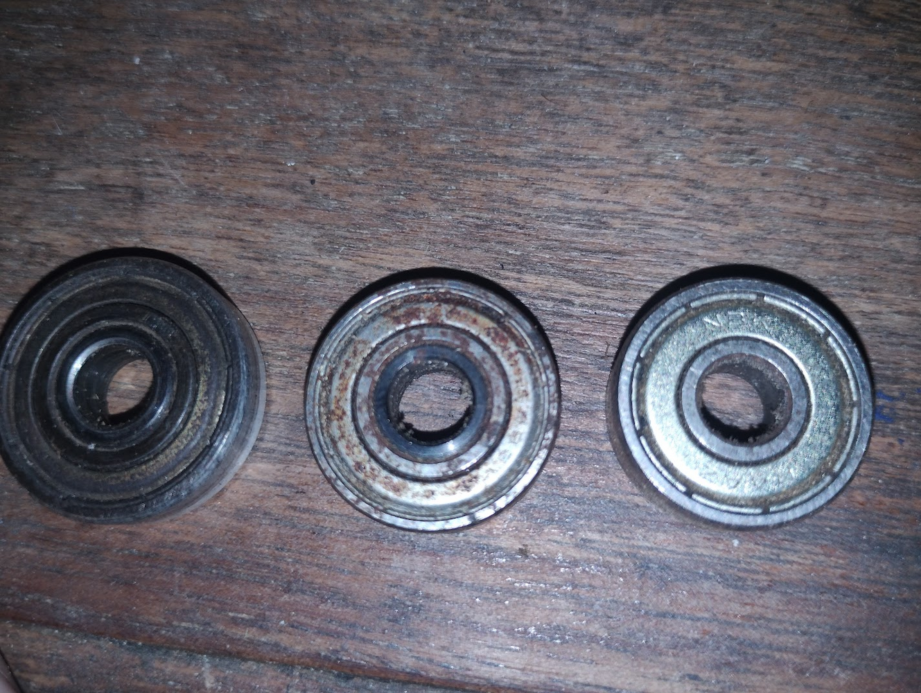

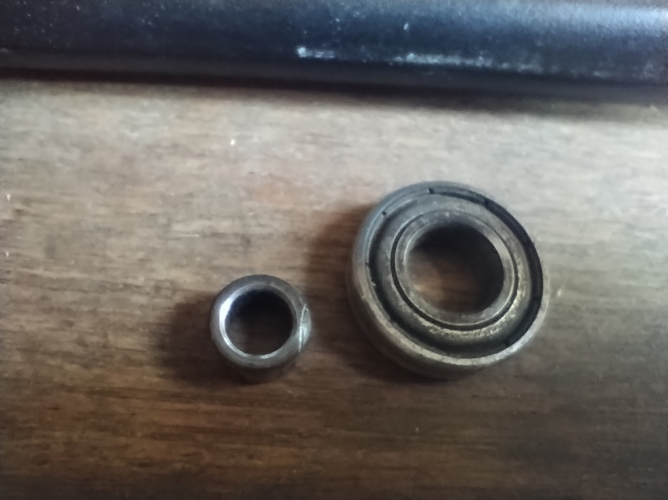

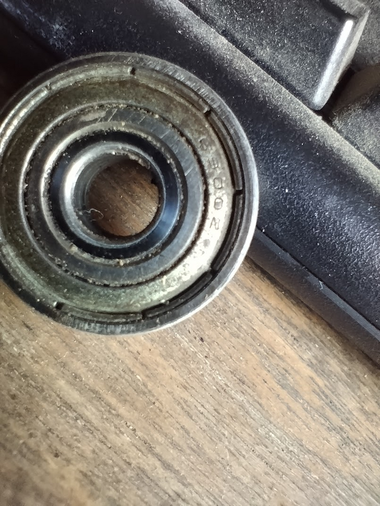

Ive got a few bearings, all of which should have the same ID, but they have different ODs (to control offset on a cutter)
Specifically, the one i want to replace is this one -
The measured ID of that one is 6.44mm (heavily used, and failed)
The measured ID of the others are 6.46 and 6.26
The measured OD of what they fit onto is 6.27
So, do i "assume" thats quarter inch, and ive got some measuring in accuracy.
The average of 6.44 and 6.27 is 6.355, which is, basically, spot on, if the wear has been equal on the OD of the fitting and the ID of the bearing.
So, 1/4"
The OD of the bearing seems to be spot on 22mm.
The height of the unit is 6mm, but im not fussed if thats greater.
There are loads of 1/4 x 3/4 inch bearings about - thats not a problem.
There are loads of 6mm x 22mm about.
But this mix and match of imperial and metric doesnt seem to make sense?
I always have issues with this, so is it actually common and i just need to go to [somwhere] and theyre all over the shelves, or is this an oddity?
Thankyou.
