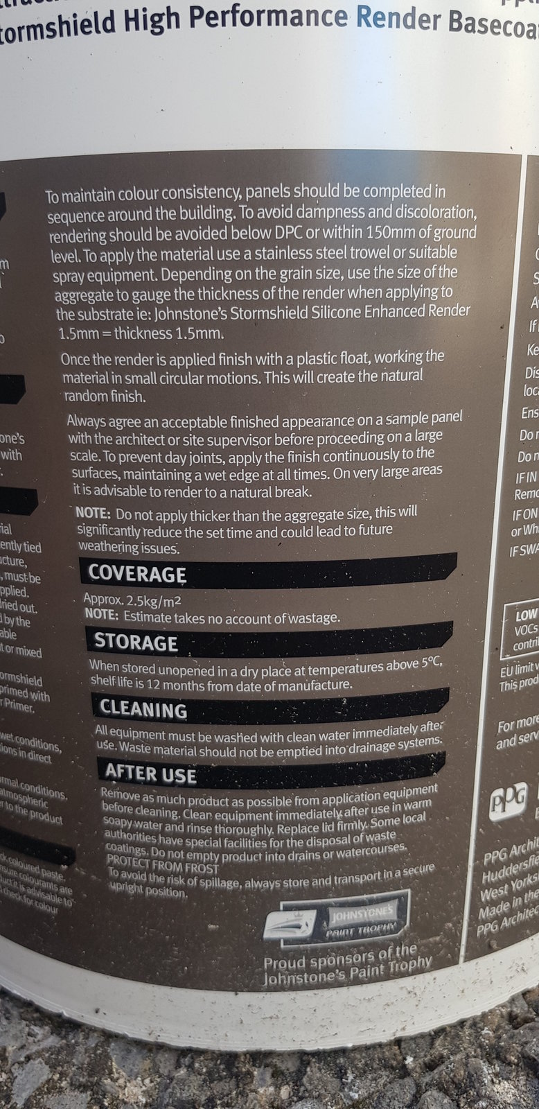

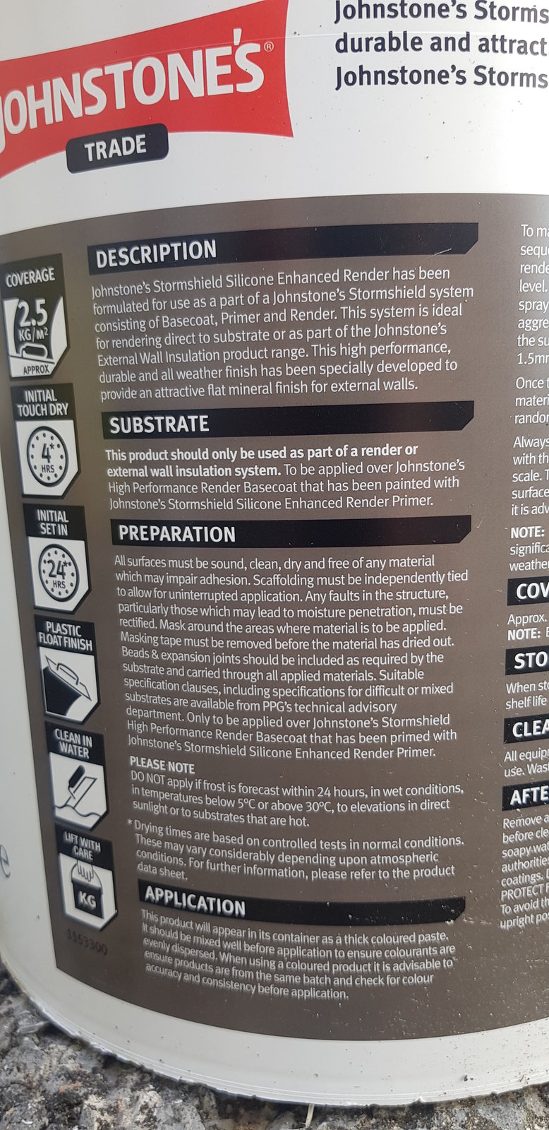

Painting the exterior walls. the bathroom is a dodgy extension on an ancient welsh terrace, I have removed all the loose paint and filled the cracks in the render I have been advised to use decent masonry paint which I'm happy to do, but the Girlfriend has a 15l tub of this stuff which looks the dogs danglies on her house, applied with a trowel by a plasterer. He says it can be brushed on. It looks like a very gritty painty stuff.
I have no idea what I am doing so what do you guys think?
it looks like it ought to work but I dont want to have any disasters later on.
