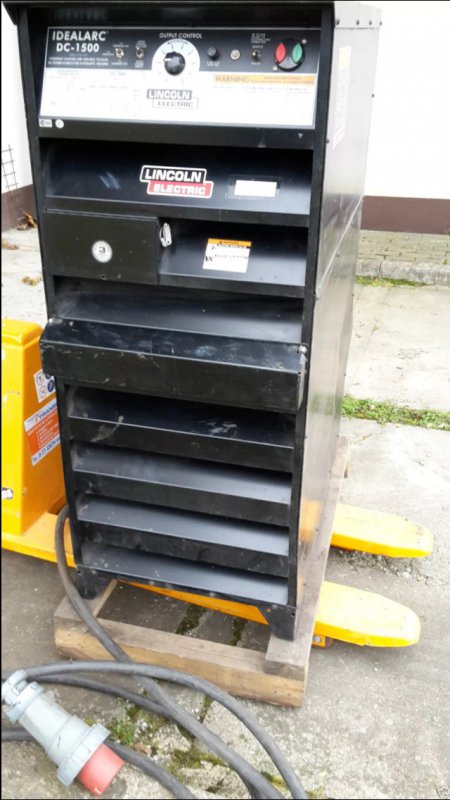

.I thought my boc adr 375 was bad enough. To run it flat out I would have had to pay for a replacement 3 phase transformer for the local substation, as apparently it couldnt cope with the amperage draw it wanted, and it kept flipping out the breaker on my supply on the inrush current just to saturate the transformer core despite dicking round with chokes and start up circuits etc.Not very often you see a rating plate that says 300-1500 Amp at 100% duty cycle.
Or 187 amps mains input current!
Bargain there for someone in need of a big SAW or gouging set.
