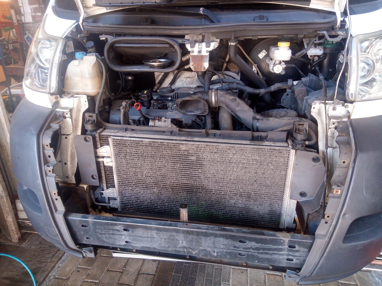

When recently servicing it saw a big green spot on the condenser (center bottom)

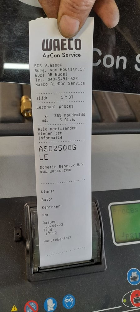

Brougth it to the garage where they emptied the system.
There should be 955 gram (it has passenger ac as well) so there is at least one leak, I have no reason to assume there are more.
To save money this time and in the future, and gain experience in this interesting field I decided to replace the condenser myself, also since I can take more time for leaktesting and vaccuuming I can do a better job then the garage, how difficult can it be
I bougth a nrf easyfit condenser with dryer in it, and a set of gauges, vacuumpump I have.

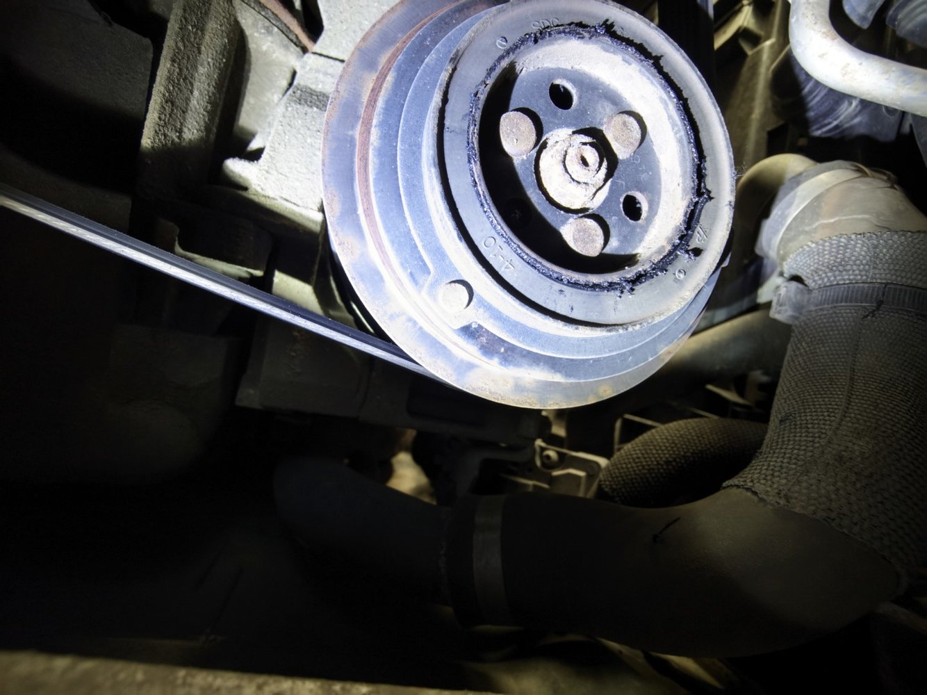

There was one more isue I forgot to investigate before emptying the system.
With the ac switched on and the engine idling the pump rattled a bit.
It first started doing this a year ago and it very slowly became worse.
First thougth was the em clutch, but then it should be only when switched off?
Are there any tests I can do to determine the cause? Garageowner suggested it migth be the lack of lubricant due to the leak and see after filling it.
