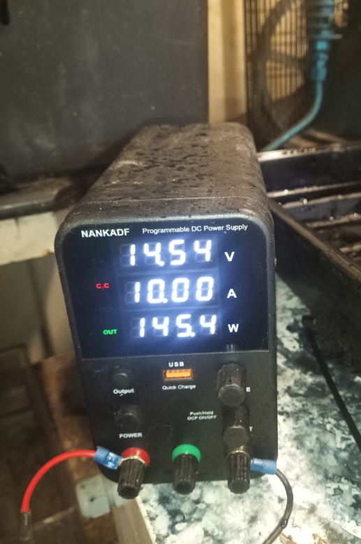

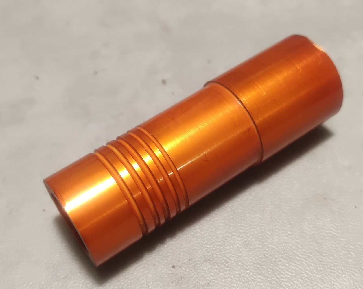

I have only used the sulphuric once so far but it performed well. Voltage was a lot lower than I expected, almost 50% I would say. Part came out well and the other thing is the crud that was on the lead, from the previous solution I was using, just fell off and lead is now clean.
Voltage and current for the part.
And the part.
