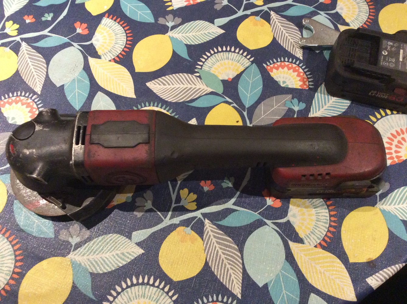

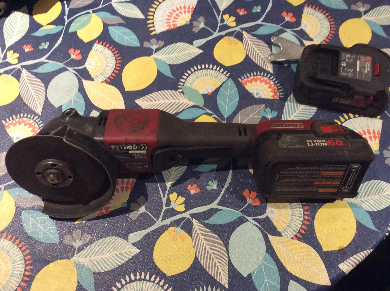

Yes I agree generally with that, but however not in this case as it is a different situation, you are not running a 9" full size disc at 12000rpm, you are now running probably a 4-5" disk at 12000RPM which mine does, so in effect the centrifugal force is no where near what it would take for the disc to fly apart and is probably the same as running the 9" disk at a slower RPM.Please do not do this, 9" discs are only rated for around 6000 rpm, smaller grinders turn at up to 12000 rpm! So you could be running the disc at twice its max rated speed a few inches from your body!
Put it this way - your car engine might red line at 7000 rpm. What do you think would happen if you could rev it to 14000 rpm?
