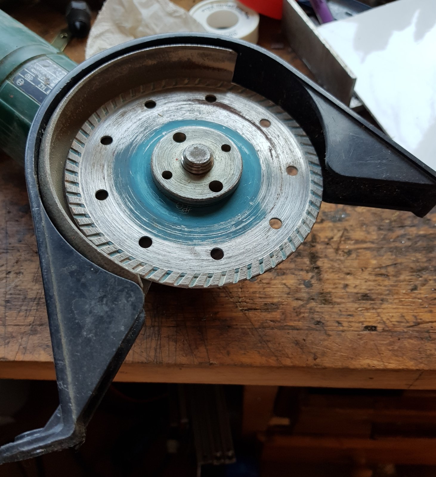

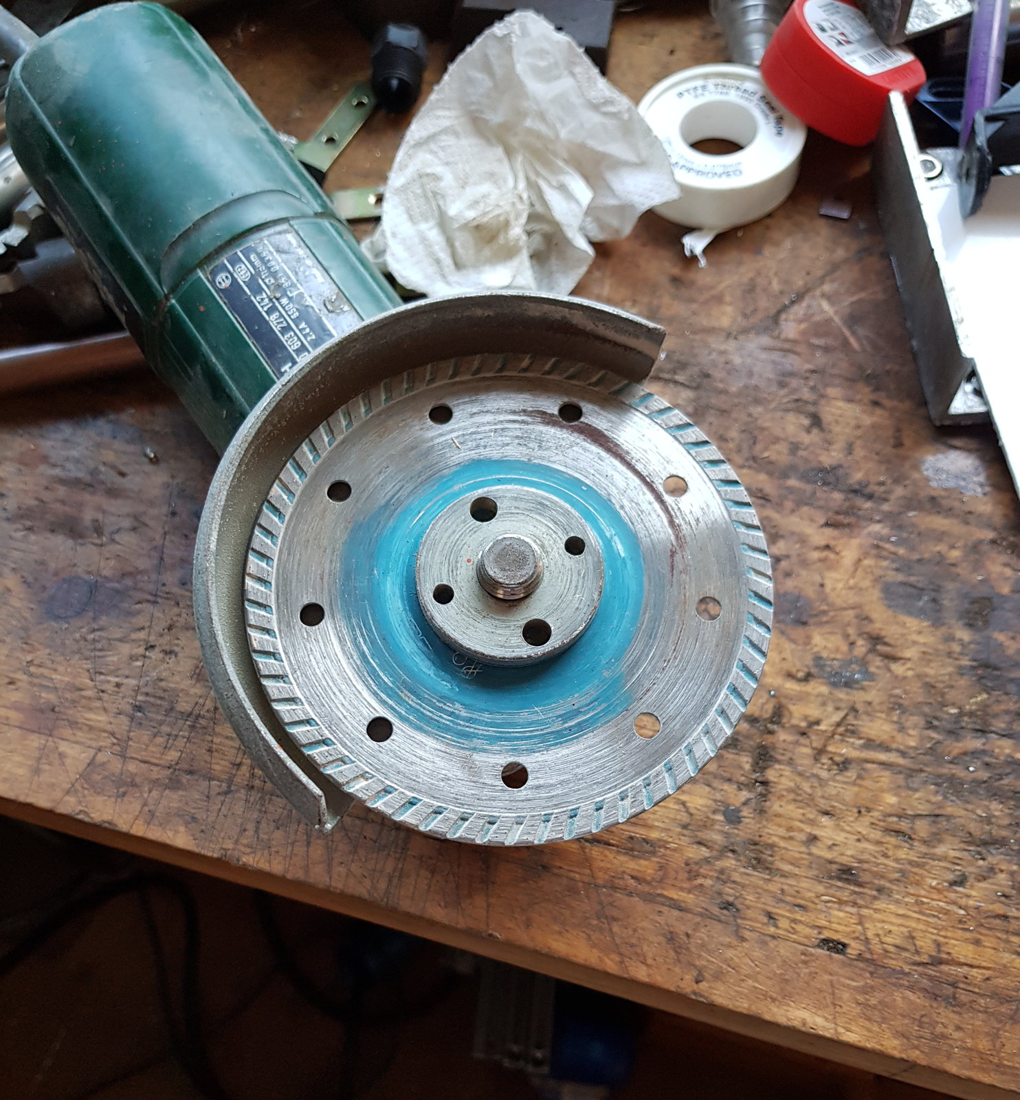

Thinks: "What can I do to keep the dust down?"

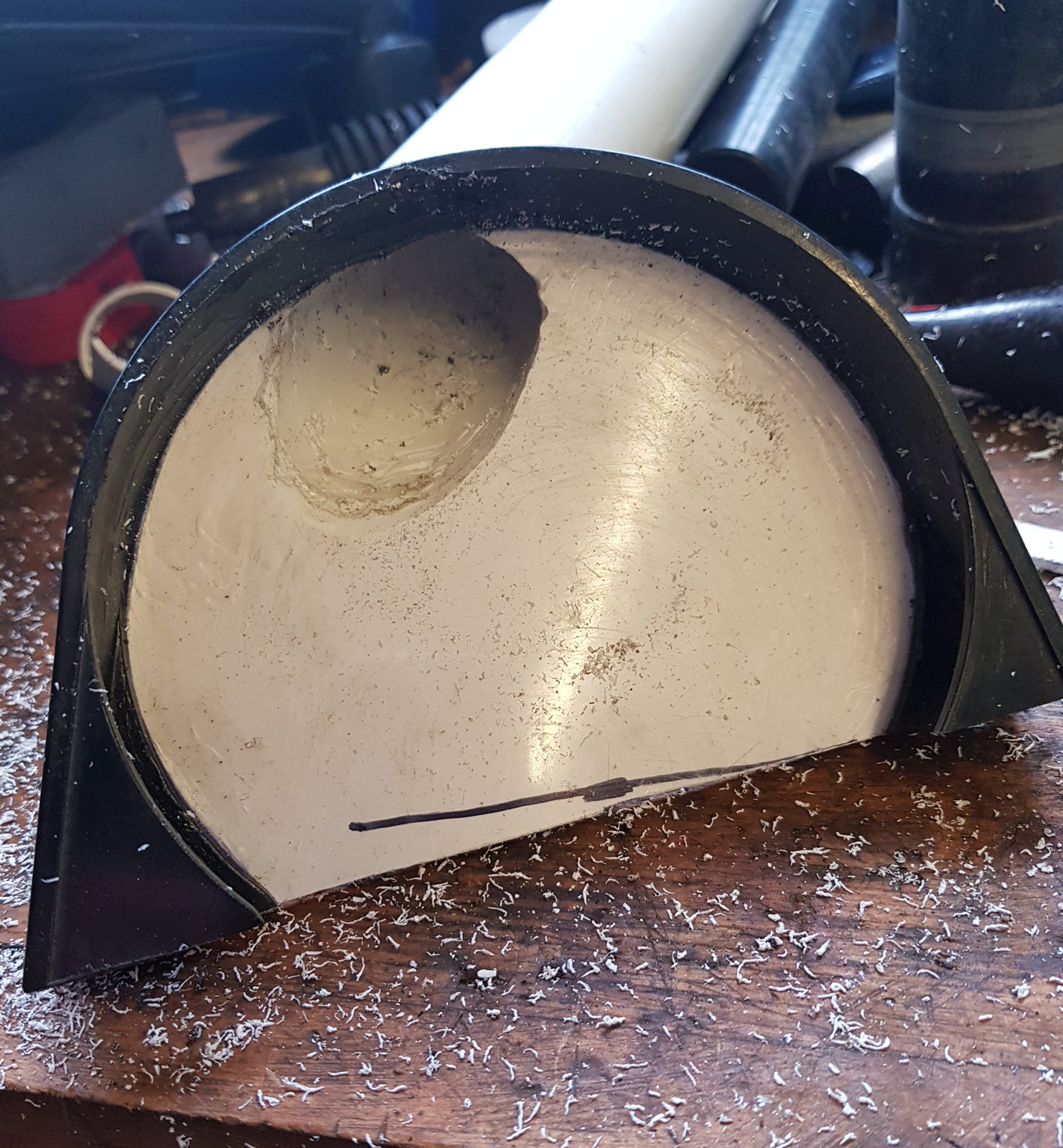

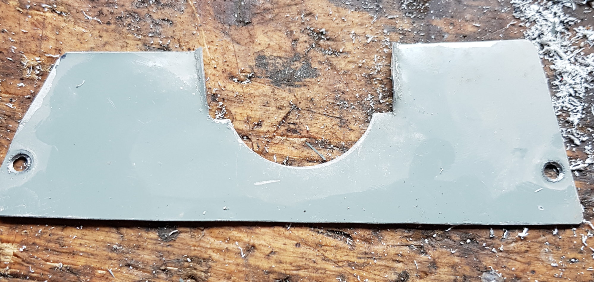

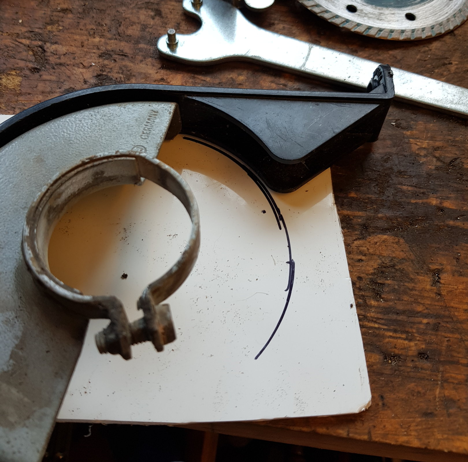

Hmm soil pipe bracket looks like a good starting point

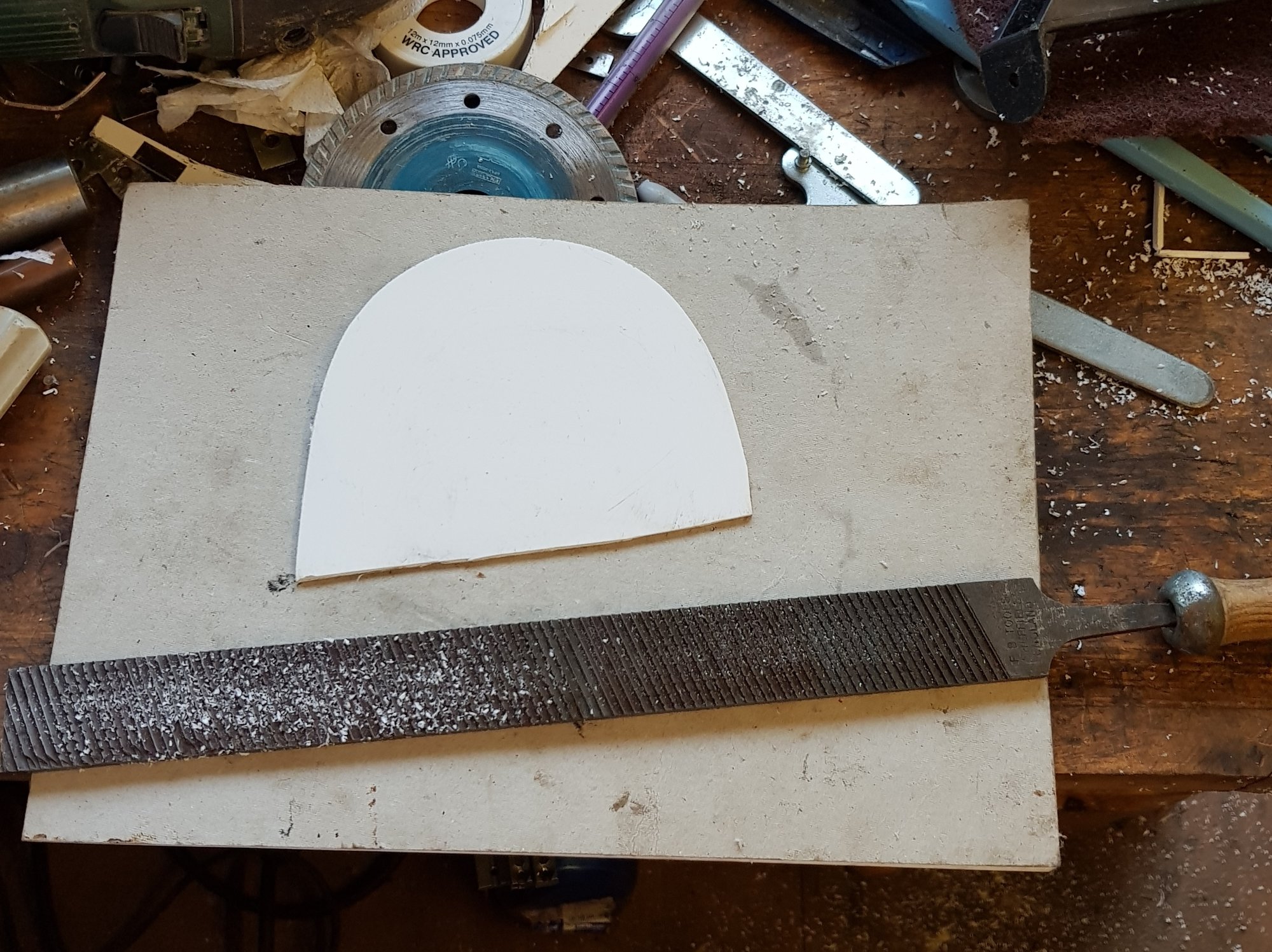

Source a piece of PVC left over from a bathroom project

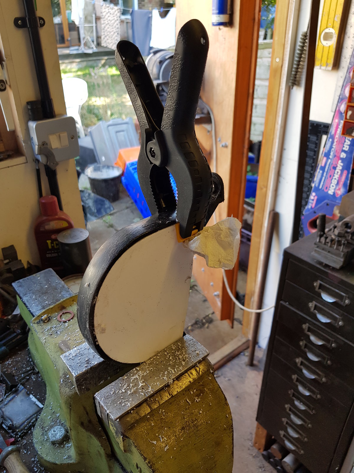

Mark it up and trim to shape
Stick it to the bracket

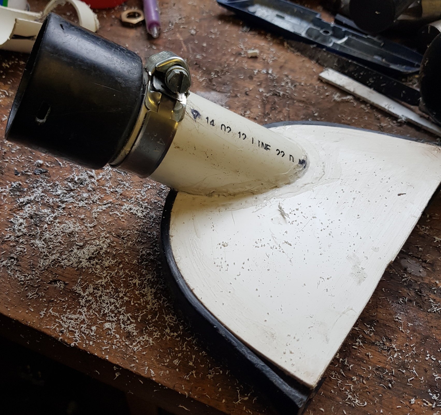

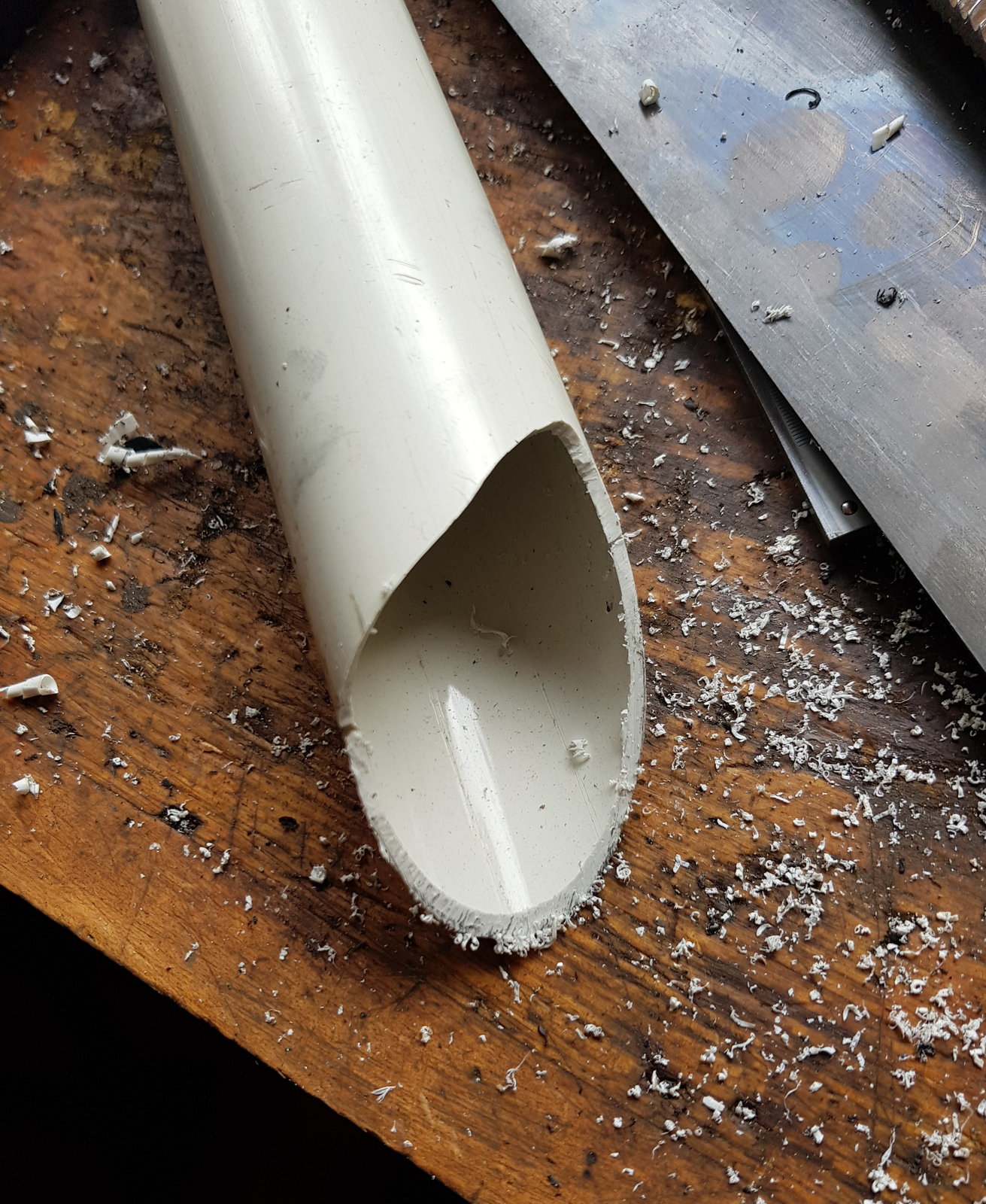

A piece of 1 1/2" waste pipe is about right for the Henry nozzle
Attach it and open a port
Finished item
It woks after a fashion, but still a lot of dust. Modification called for.

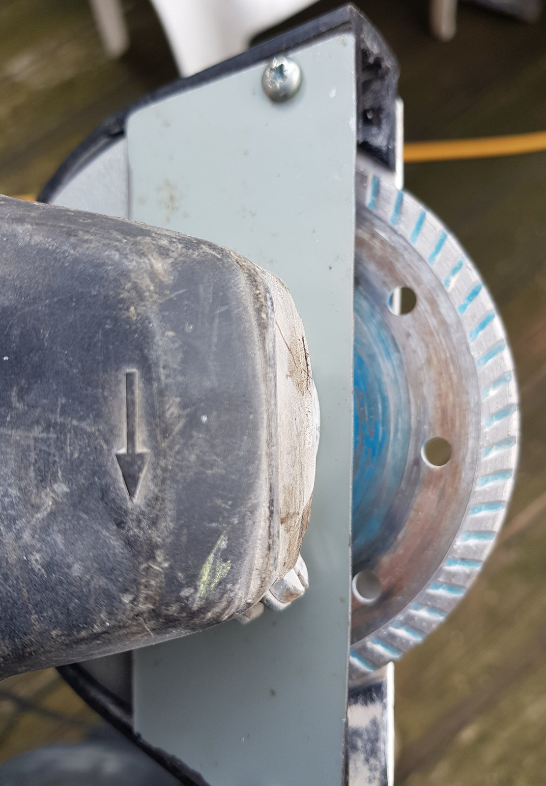

An old shelf divider came in useful
A little bit more tweaking and it fits
It's not perfect, but it has kept the dust to an acceptable level. Total cost - £0 (apart from the bottle of solvent adhesive I had to buy when mine ran out
