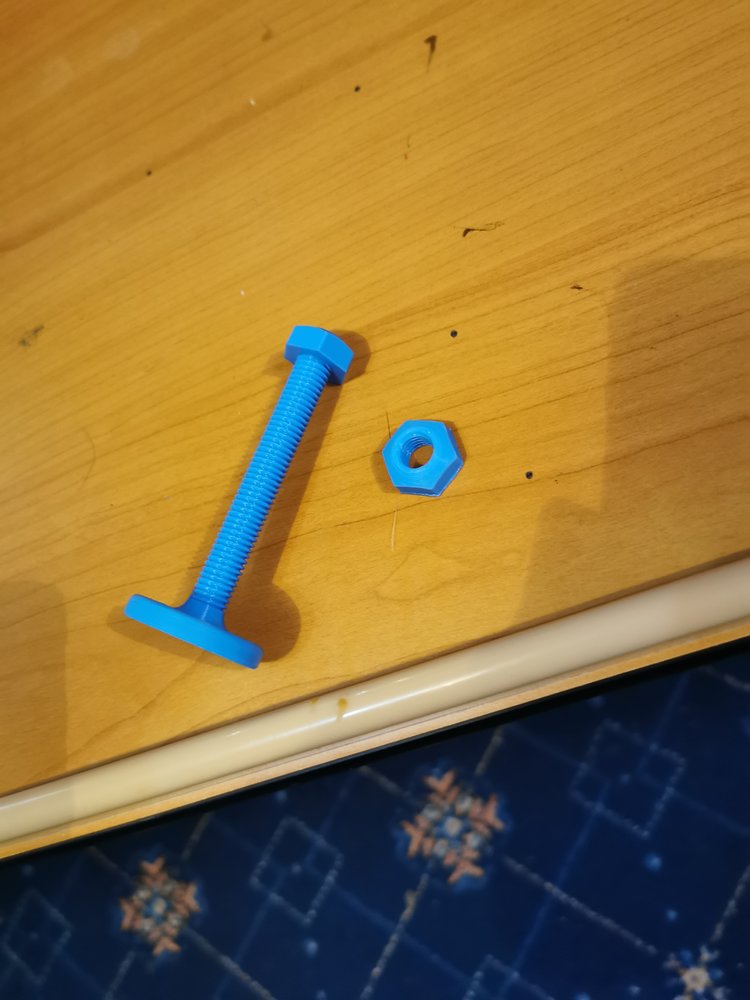

Yep ..I had not thought about that . So well spotted. But the hole in the bolt is actually smaller.....Remember if you're scaling in all axes, then you're also scaling the pitch.
You really only want to scale X and Y, not Z (assuming you're printing the bolt upright, and the nut flat..)
Thing is I expected the thingiverse files to fit as they were designed to fit together. Loli ended up increasing the nuts to 105% on the X and y and they fit perfect.Look at some of the Fusion 360 YouTube videos about threads & printing them . The better ones explain that the nut thread form should be a fraction bigger than the bolt thread to give you clearance.
I know you don't/ didn't use Fusion 360 but it's thread nut & bold making programme allows this thread to be automatically calculated to several slight different tollerances that work when printing nut & bolt threads .
The videos also show that some threads will need to be printed on their side or at an angle using a support so that the shearing tendency of the bolt is reduced
The fit is highly dependant on the calibration of the printer. So even if the tolerance is spot on in the 3d model your flow rate, material shrinkage, over/underextrusion all affect it.Thing is I expected the thingiverse files to fit as they were designed to fit together. Loli ended up increasing the nuts to 105% on the X and y and they fit perfect.![]()
