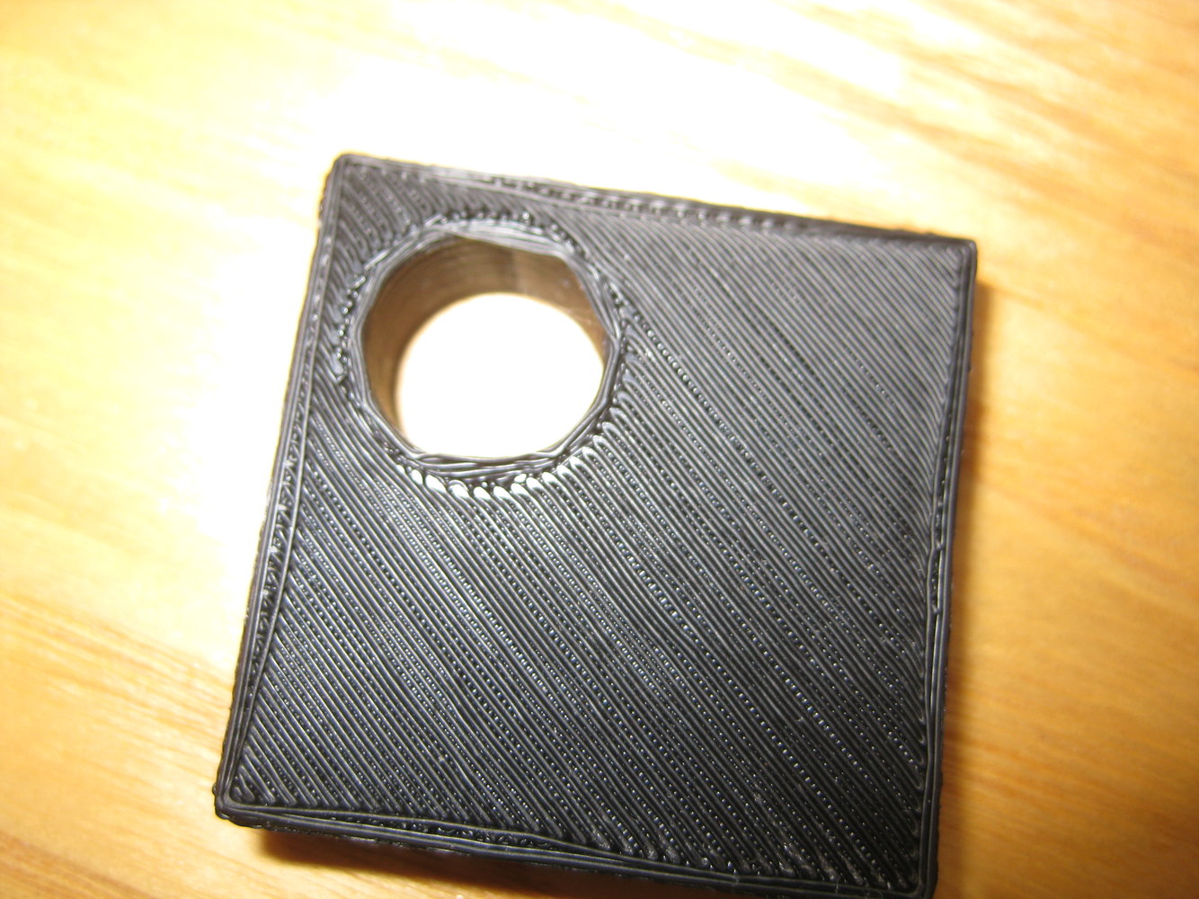

The nozzle is not close enough to the bed!
The first layer should have enough 'Squish' for there to be no gaps between each line.
A Raft will cure all the problems you have there IF you can get the raft to stick but unless you get the nozzle closer to the bed you are just gonna run into the same problems trying to get it to stick.

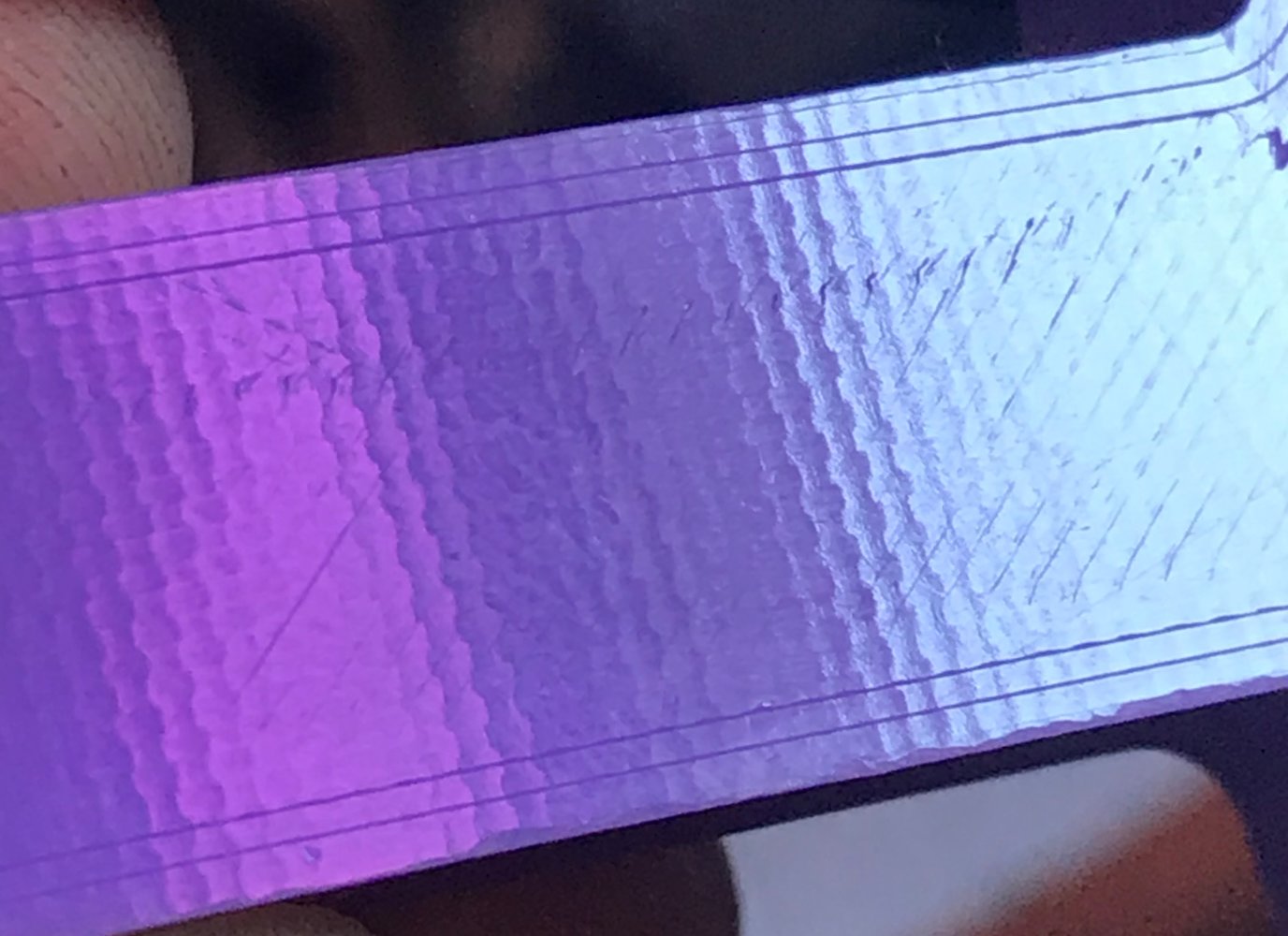

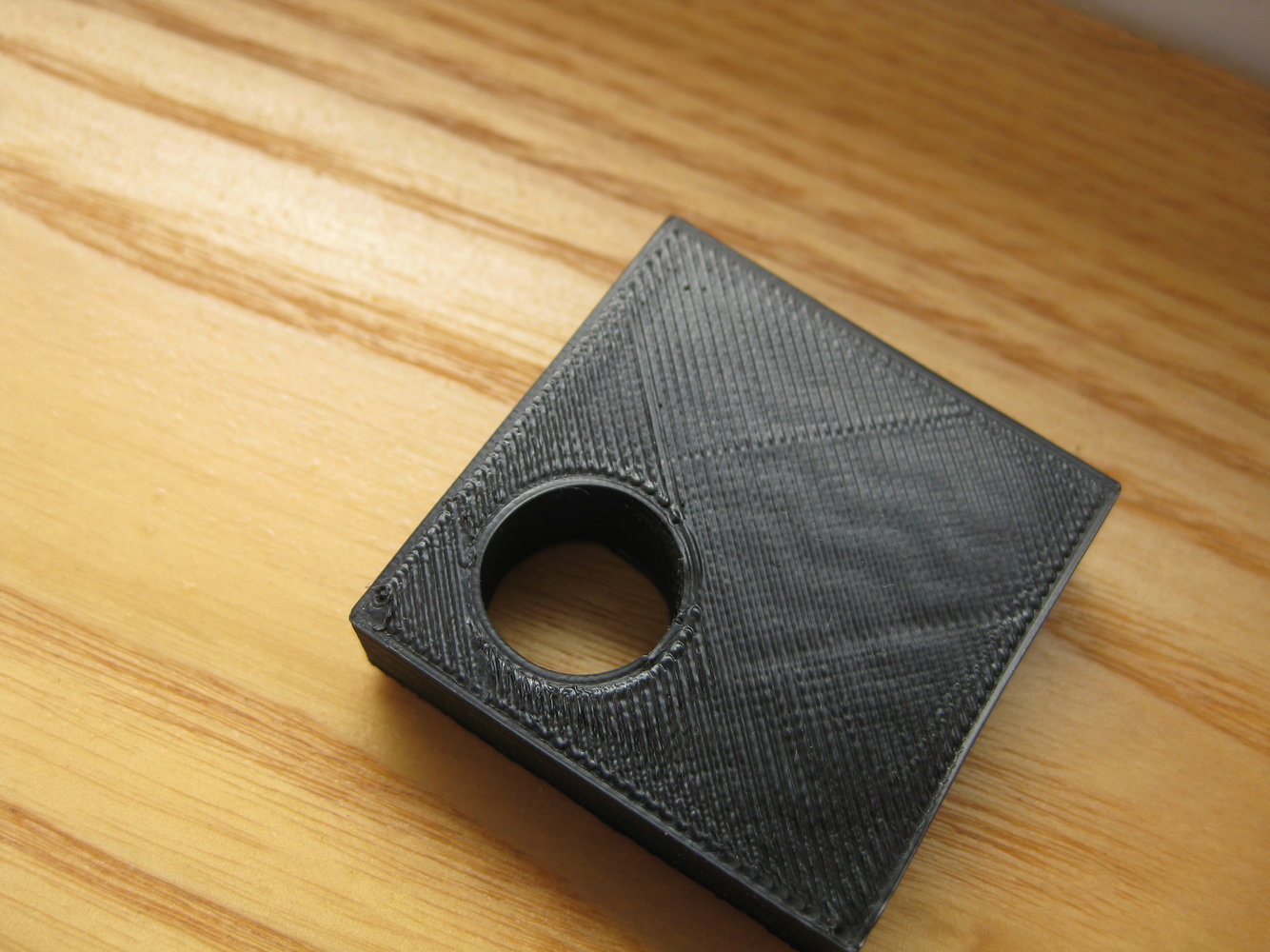

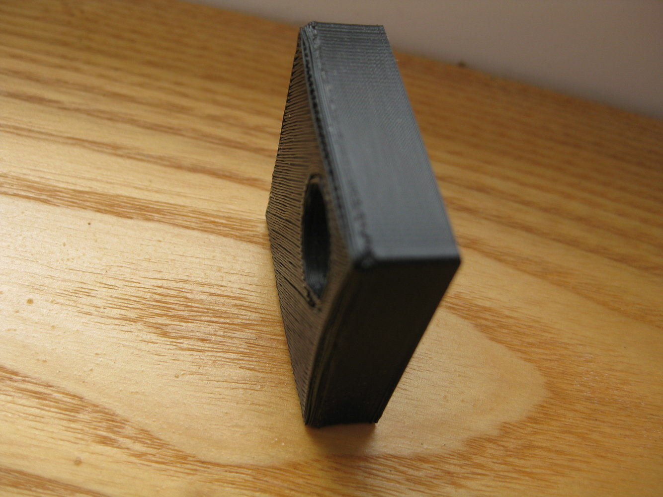

The first layer is the nozzle is not close enough to the bed. The top layer is slight over extrusion. Maybe too much outline overlap or the pressure advance not tuned well too looking at the edges.

Watched it print with botty butterflies flitting about for the 39 min print ... the first layer is not too good compared with the sides & final top finish . Nothing curled o boke free . onOnce th plate wa cold a gentle bend of it & the part came free .
What do yo guys & gals think of it?
Top layer .
Edge definitions , no they are not bent /bulging , but you can see the ropiness on the left side first layer face.
Ropy first layer .. would putting it on a raft of say 2 mm thick prevent this happening? Is the free looking ( unattached "extrude on the the inside runs of the edges normal where the juice/ glue didn't hold things as they were cooling ?

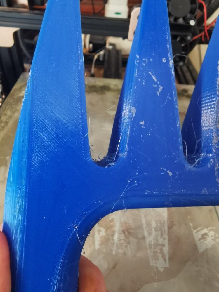

Just fyi, this is how a first layer should look, this was taken off my printer about 15 mins ago.
this is PETG not ABS but they should look the same when taken off the printer.
Now i just gotta go print another one for SWMBO, they are garden claws for making picking up garden trimmings easier,
