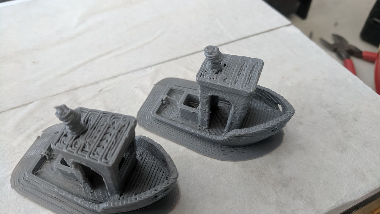

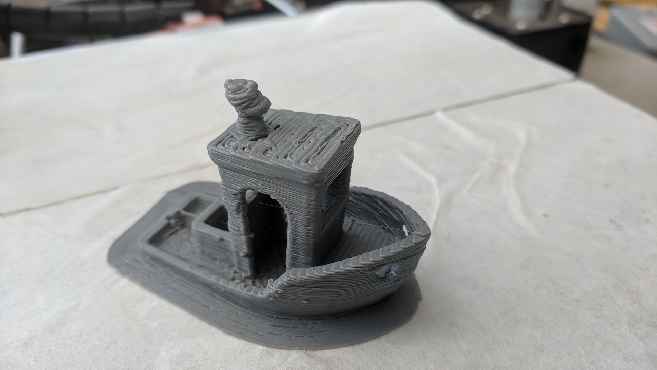

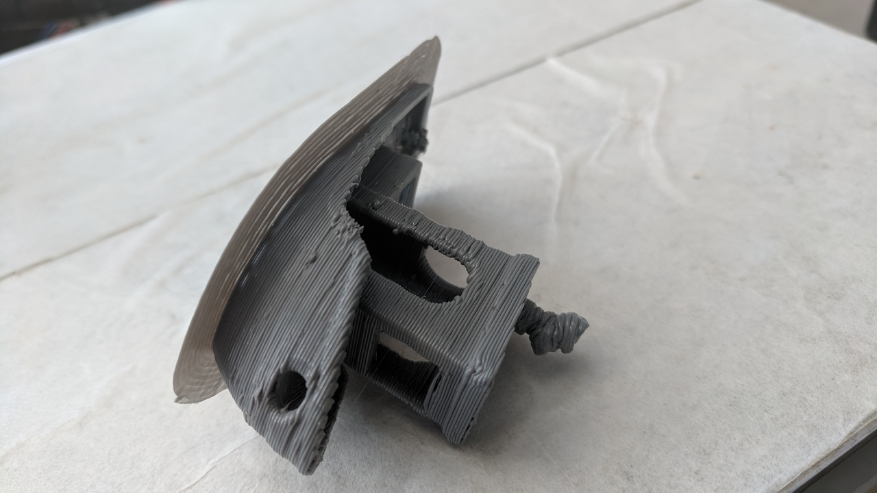

further investigation - checking calibration of the extruder feed.
100mm indicated = 63mm of filament out of end of bowden tube.
so i need 100/63 = 158% flow rate.
cura only goes to 150%
i'll give it another go at that setting later tonight.
This webpage has been invaluable to me when calibrating my printer.
https://all3dp.com/2/how-to-calibrate-a-3d-printer-simply-explained/
About halfway down are the steps to calibrate your extruder, it does involve logging into the printer from a computer using the usb connection, I use Pronterface if I have to do any of this.
Have a good read through first before trying to edit the configuration of the printer.
